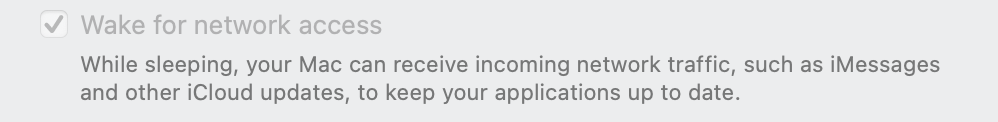

I think this is what used to be called 'Green LAN' in the not-too-distance days where some Windows laptops come with higher quality wired ethernet chipset that do exactly the same - dropping to lower speed when laptop is asleep.
To me, this is not a new technology nor a defect. Just a feature that never did work on Macs before.
During the '100Mbps' mode, it does occasionally quick and short wakes which is part of macOS (and perhaps tvOS and other appleOS too) years-old feature of background update probe activity.
