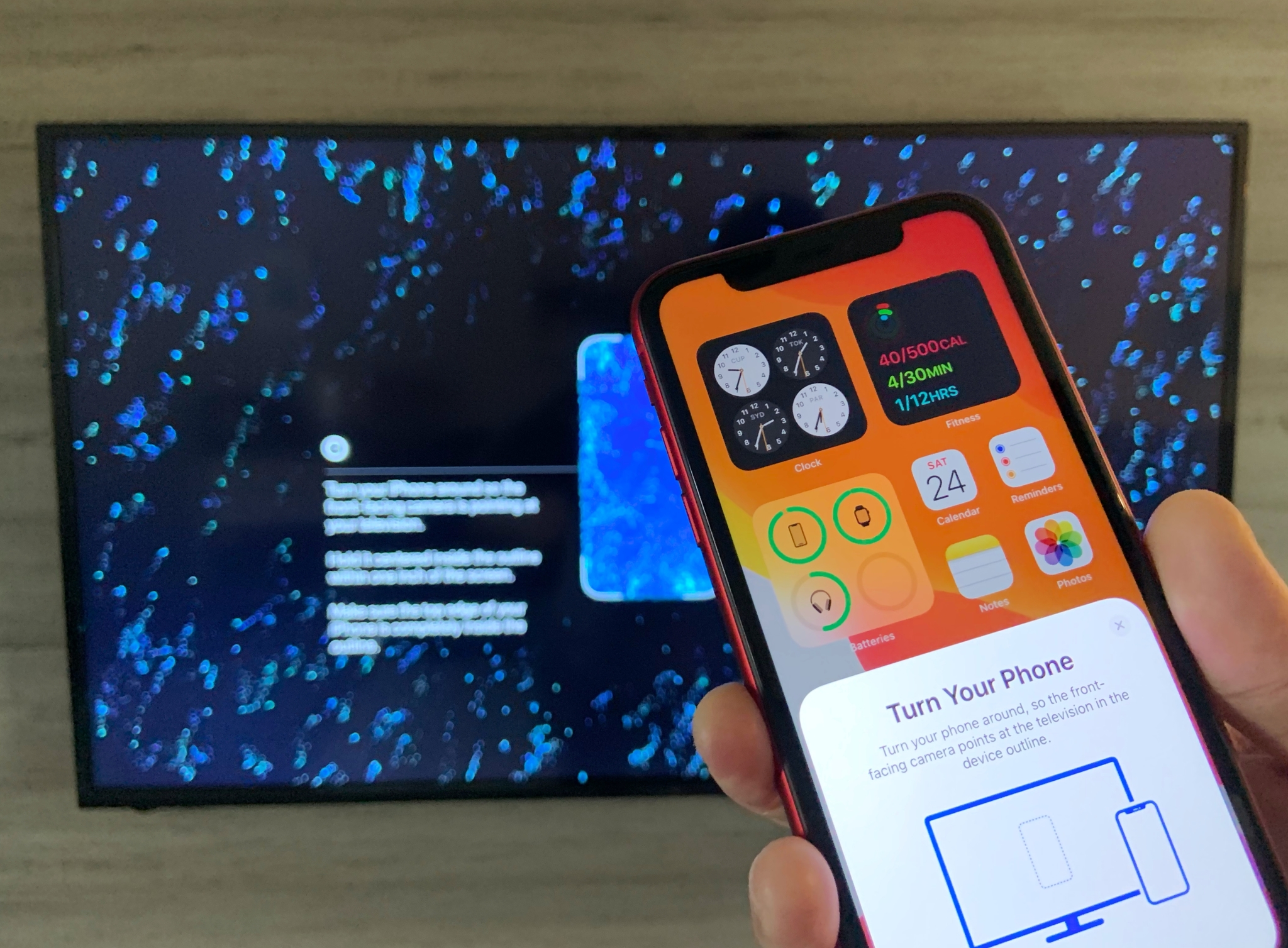

After all the above adjustments have been done, you can also use the tvOS calibration feature (if you have an iPhone).
Just keep in mind, that this process will not calibrate your screen, but your appleTV.
So you will not see that effect on other inputs. Also, if your set has been miscalibrated, then you will be adding opposite miscalibration to appleTV video output. But the end result should look ok on your display device.
This is what my post is about, did you read it? This feature won’t work for me.
