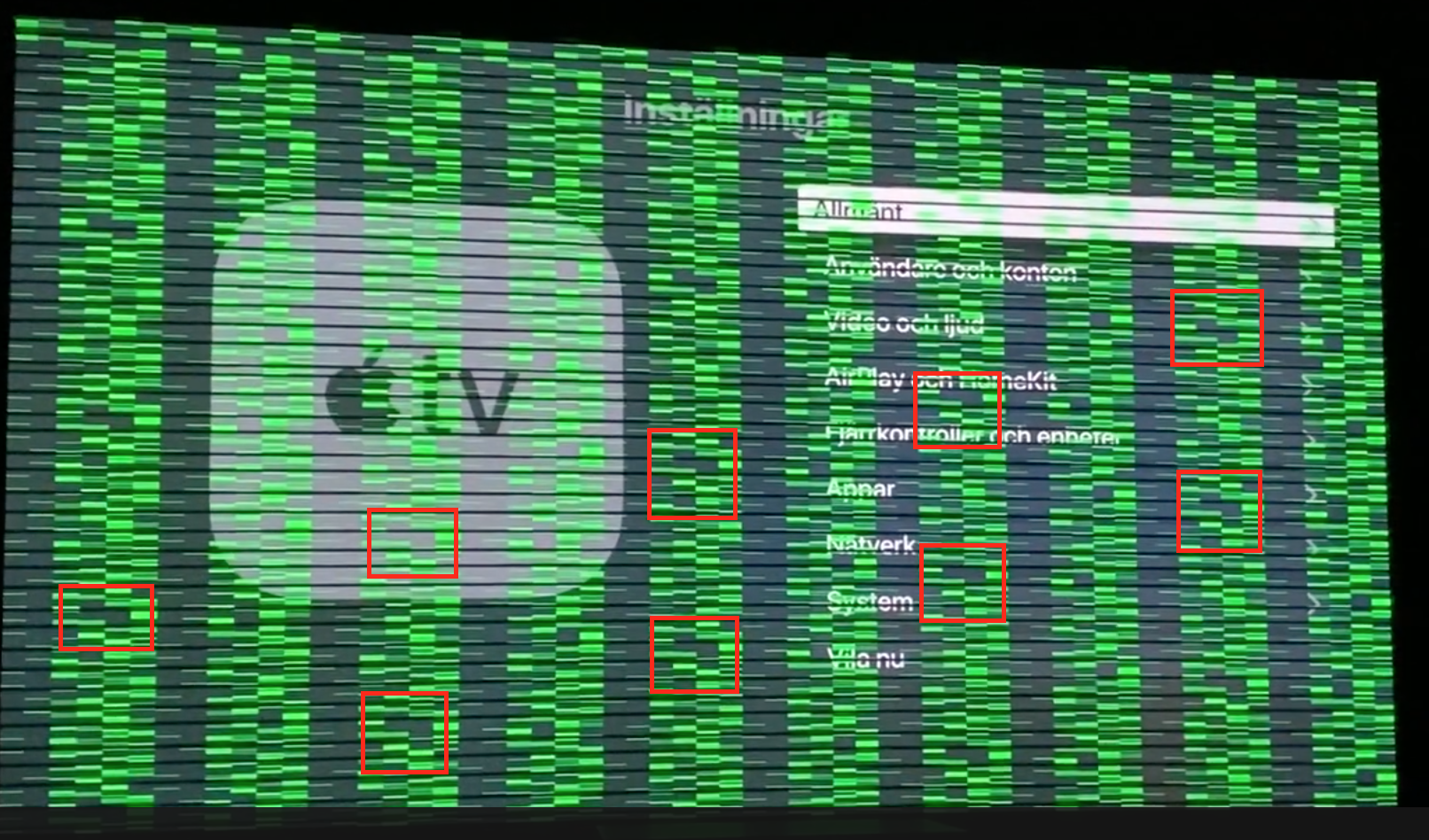

This is so wierd.
Wifi works fine, but if you connect a ethernet-cable, it just goes black in second.. a green screen and then black. or the picture get stuck with artifacts.
This is so strange. I´ve tested different ethernet-cables, and different routers.. what can it be?
UPDATE: It´s the same problem on wifi now, but not as often.
Can it be a overheat issue?

Could be a broken pin in the ethernet port on the ATV or another (fatal) fault in the ATV. Can you test your set up with a borrowed ATV?
I think it has to do with the network.
It does this even on Wifi but not directly, but if i try to go to setting it dies directly
If I turn off the network at home, it works fine!
This is so strange...

I have 2 apple tvs one in the living room (thats the 4K version) and one in the bedroom (normal Apple TV 4) the one in the bedrom NEVER glitch. I also have a Time Capsule in my network, but I do not use it as a router.
If i connect the apple tv4K directly to the router, or via a switch, it doesn't matter, it glitches.
This is so strange, here is a video of it:
[automerge]1583967874[/automerge]
Have you tried the ATV4 in the living room? If it continues to work fine then it is unlikely to be a network fault and it may be time to look for a replacement for the ATV 4K (your video could be showing a graphics driver/hardware fault)!
It´s no problem with the other one.
This one is brand new, i got my old 4K version replaced, same problem with this.
I will test to change the name on it, or choose not to install apps automatically when it´s new, if that helps.
Hmmm....Did this problem start while you were installing the ethernet?
I ask that because you are looking at artifacts caused by a low voltage condition over an HDMI conductor(s). The green color is the effect of <2vdc being interpreted as input (a zero). The conductors in an HDMI are really thin wires and if one its yanked too hard or something then it will be more resistive to electric flow causing the voltage to decrease. It could be a failed HDCP handshake however that is usually a completely green screen and I don't think the menus require that anyway.

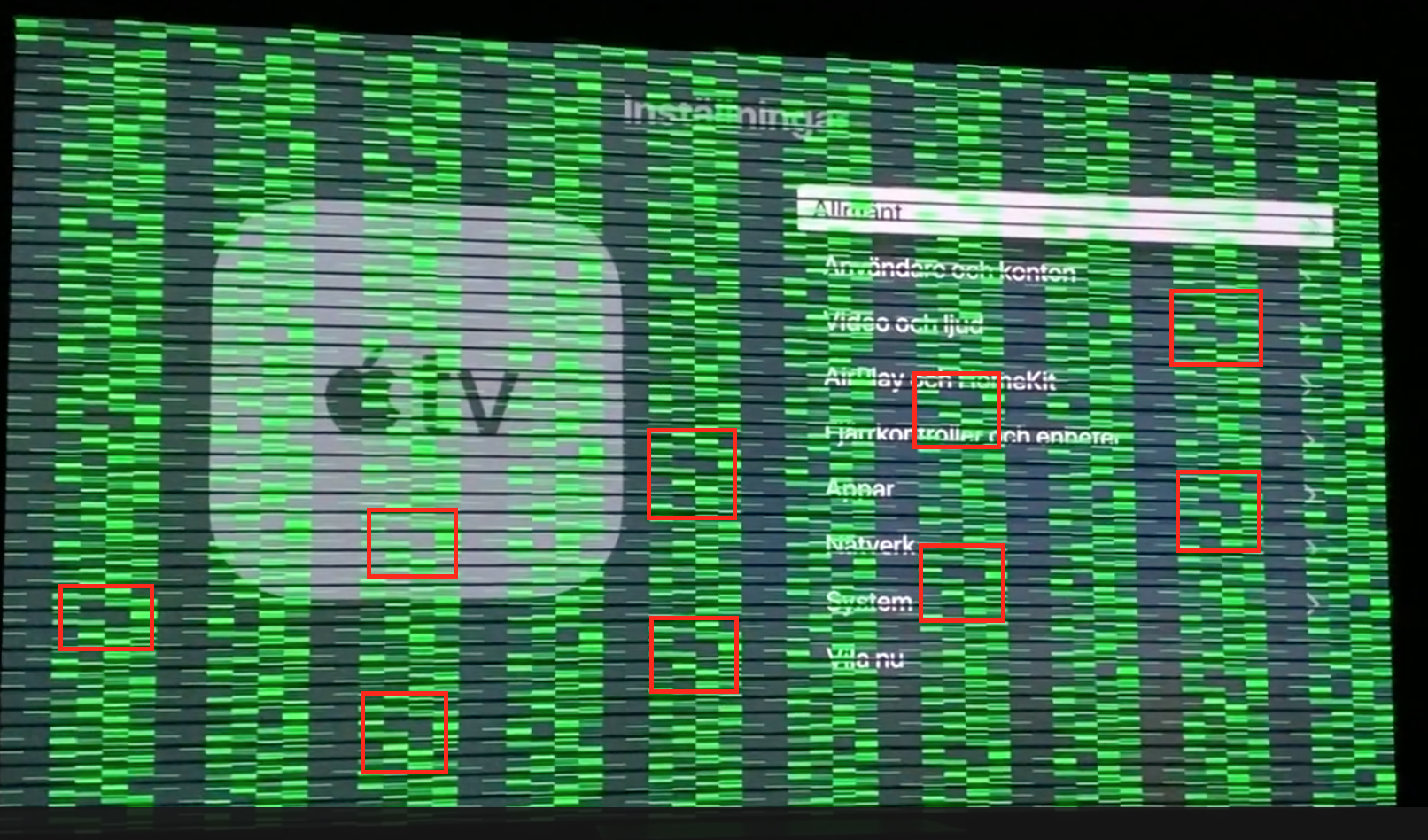

Admittedly that is strange because that is something I've seen before doing very predictable behavior. You can even see a static pattern in it...
I guess there are always odd variables.
I'm going to have difficulty letting it go though lol. What happens when you set the ATV to 1080p output and try to connect to the internet? Do you have another TV to test it on?

The thing is. That is exactly the same problem with my other one. This is new.
If it was the GPU. Then why does it die when I connect a Ethernet cable ?

it could be a faulty network switch or TV
it looks like one or the other is putting voltage onto it's cable (HDMI or ethernet) that it shouldn't.
if only one of the cables is connected, it's fine, since there's no place for the voltage to go.
But when you connect both the HDMI and ethernet cable, the voltage can travel from the switch to the TV going through the aTV.
Try a different network switch or a different HDMI port on the TV.
or possibly try grounding them if you can, it would require a power plug with all 3 prongs.
