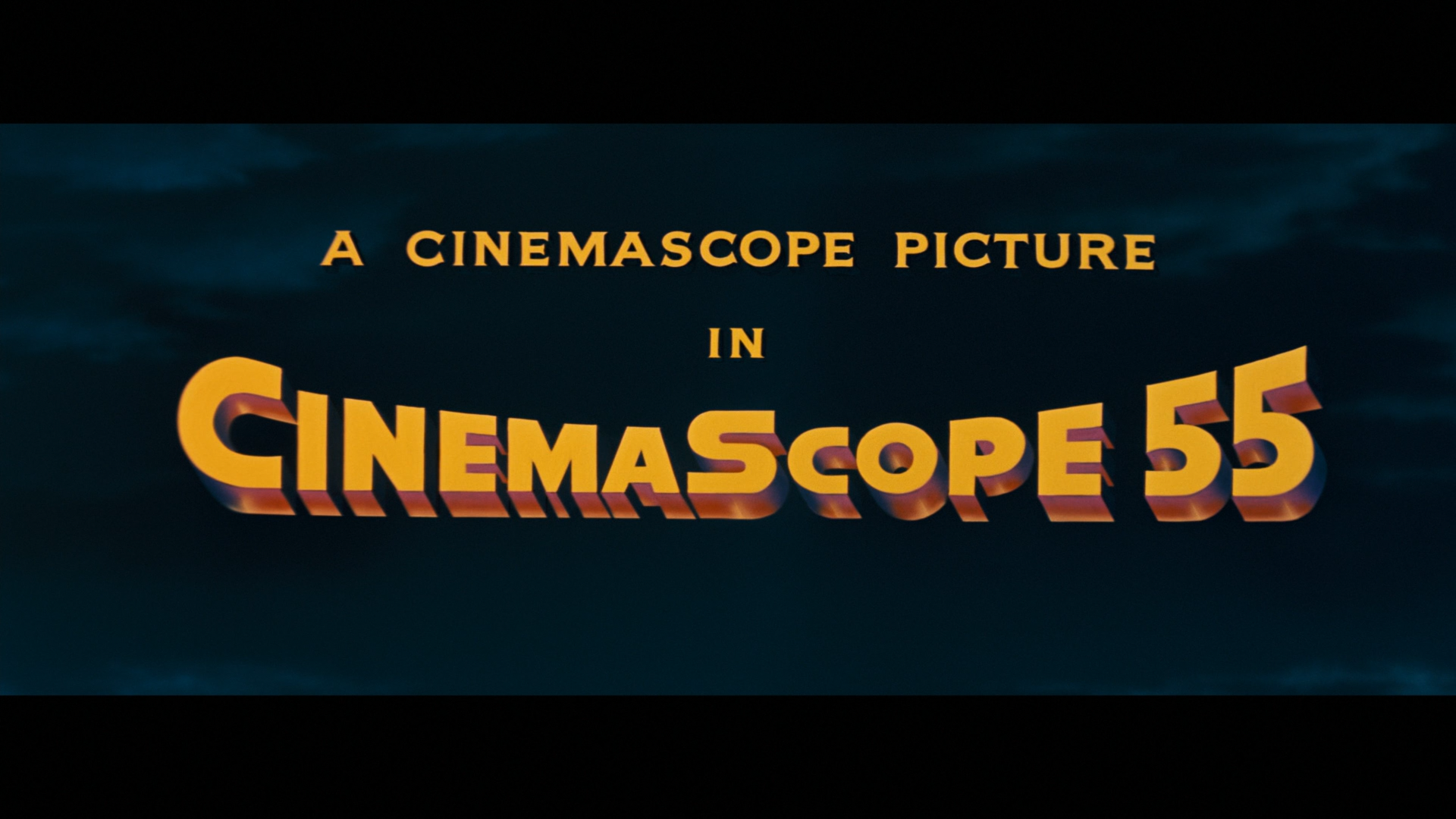

Thought the native resolution of Cinemascope was 2:66:1, reduced to 2.55:1 when stereo was added?
I don't have any problem playing it on my Apple TV OLED via Plex. Would the Plex output/result be different on a projector?

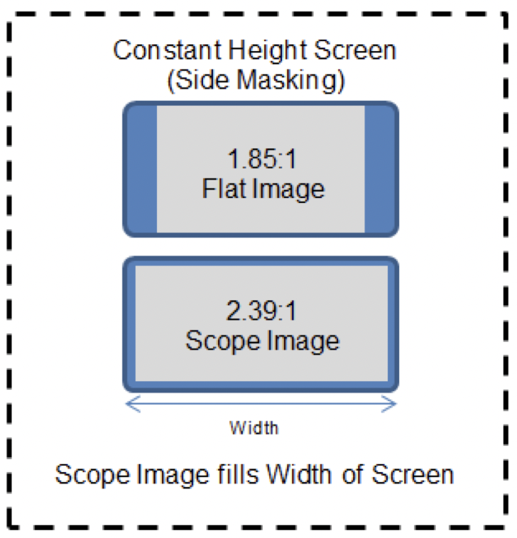

True, but a resolution of 3840x2160 (the Apple TV 4K), should take up a little less than 94% of a 4096x2160 projection viewing space correct? However when plugging in an ATV it looks more similar to this image below of a flat (1.85:1) picture on a scope screen.

If you want to display a scope ratio movie full height on a scope screen, you will need to zoom in on the image. This is probably the "overscan" feature you are referring to. This will cut-off Apple TV menu information but shouldn't affect the movie.
In DCinema, all images are stored "flat" (non-anamorphic, square pixels) regardless of their aspect ratios. The two standard aspect ratios, which you show in the image, are 1998 x 1080 (for 2K flat; multiply each by 2 for 4K flat) and 2048 x 858 (for 2K scope; multiply each by 2 for 4K scope).
