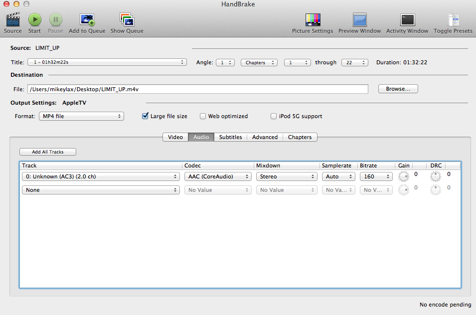

hmm ok, I have attached a screenshot with what the apple tv 3 preset chooses. I have used this for over 300 movies so far and all works perfectly on apple tv 3 with the one older software.
6channel doesnt exist on any of the DVDs I am converting so im confused.

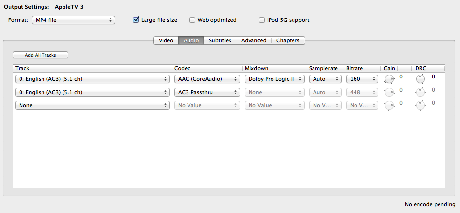

The first audio channel is a mix down of the 6 channel AC3 to 2 channel AAC stereo for non Dolby/2 channel playback, such as a 2 channel TV. As an extra bonus, it is encoded in Dolby Pro Logic II (which is an encoded version that can be dematrixed back to a form of 5.1 surround sound by certain, primarily analog, home theater equipment).
The second audio channel is a pass-thru of the 6 (discrete) channel AC3 for Dolby Digital Surround systems. Most home theater equipment will play this channel as true discrete (non-matrixed) surround sound.
The second audio channel is a pass-thru of the 6 channel AC3 for Dolby Digital Surround compatibility. Most home theater equipment will play this channel as true discrete (non-matrixed) surround sound.

Yes: although I did not understand this comment - "6channel doesnt exist on any of the DVDs I am converting so im confused."
6 channel AC3 clearly exists on the particular DVD that was the basis of the screenshot.
If you ever have this screenshot (where the 2nd audio track is only 2 channels), you want to change the 2nd audio track to NONE (no point in wasting file space with a redundant 2nd track that is also 2 channel):
