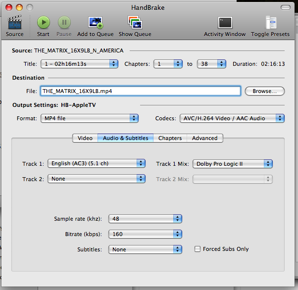

Handbrake. With the release of version 0.9, Handbrake included the ability to convert DD AC-3 into DPLII 5-channel surround in the transcoded Quicktime video file. If you select the Apple TV preset for a DVD with 5.1 AC-3, Handbrake will convert the 5.1 AC-3 file into a DPLII stereo audio track (see "Track 1 Mix" on attached screen shot) of the H.264 output MPEG4 file and it will contain the L, R, C, Rr, and Lr channels, but not the LFE channel. If you play this on the Apple TV using a TOSLINK cable (or the RCA jacks) to connect the ATV to your DPLII-capable receiver, you will get 5-channel surround (but not 5.1 surround). Handbrake also has a provision to convert the 5.1 AC-3 audio into 6 discrete channels encoded in AAC in Quicktime; however, as mentioned above, since there are no consumer receivers on the market today that can decode AAC from Quicktime audio there's really not much point in using this feature of Quicktime. I have tried this, and it does play on my Onkyo receiver, but it is not 5.1 surround.
