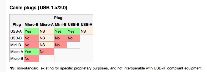

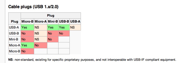

It won't work. The Time Capsule wasn't designed to function as a stand-alone hard drive.
And the only purposes I've seen USB type A male to male used for are transfer kits (from Belkin that copy files between two PCs which contain additional circuitry), firmware updates (for specialized devices) and to connect extension cables.
USB requires a host and a recipient device. In this case, you would have two host devices and without additional circuitry it won't work.
I think you would have better luck trying to access your Time Capsule via AFP or SAMBA through the Apple TV.
From Wikipedia:
http://en.wikipedia.org/wiki/Universal_Serial_Bus
