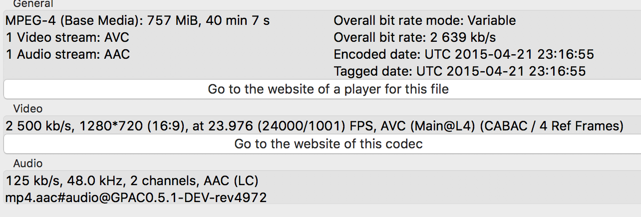

What is your mkv file?
Formats, Bitrates etc?

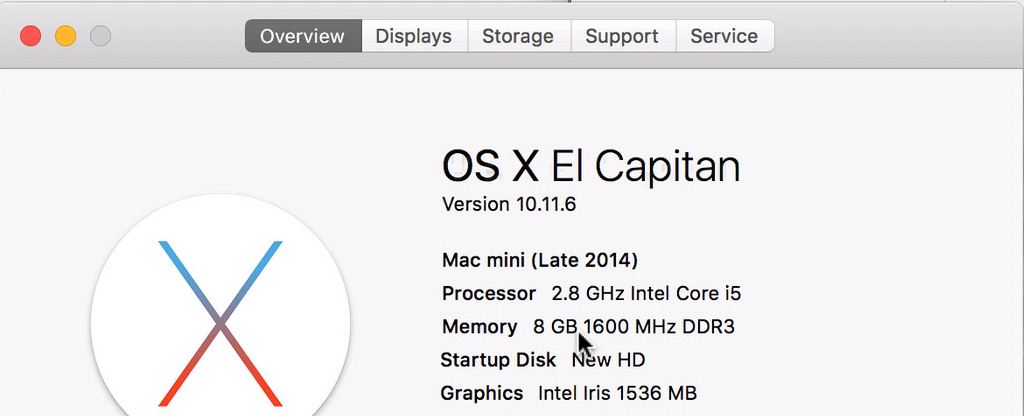

Plex Server is running on a Mac Mini, details - along with mkv specs - are below

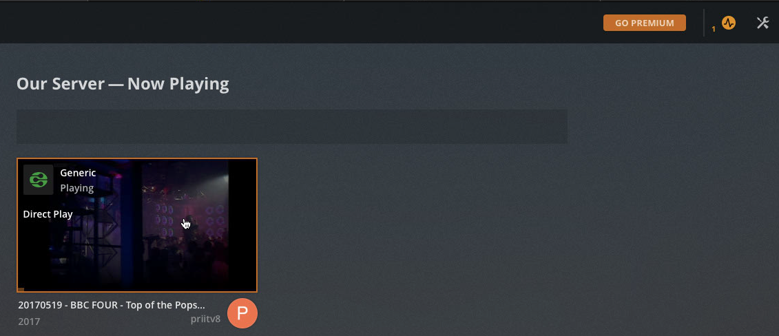

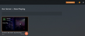

I was more thinking about the server Now Playing status window:
But from the media info, I'd say the file is having fully compatible codecs and nowhere near high bitrate.
Are you sure the encode itself plays back OK? There are known problems with AAC-HE encoder on Windows platform.
As a test, you can simply take Subler and re-wrap this into m4v file (no transcoding required) and add to iTunes library. Does it play back then?
