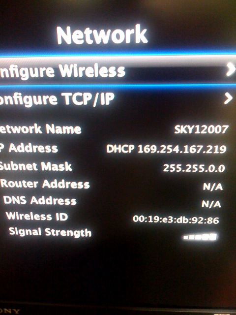

my dad's apple tv is not connecting to the internet, on the settings page it says the router is connected but also says theres not router ip address. both my iphone and my mums mac both connect and can get online with the router, any clues as in what to do with the :apple:tv??
ok im no expert with this stuff so i took a pic on me iphone
No router or DNS address, so it looks like your network is setup as static IP. Look on one of your computers, under network settings, what it supposed to look like and go from there.
You've got a few problems...
1) 169.254.x.x as an IP address means you are not getting an IP address from you DHCP server.
2) No default gateway/route (router IP). Without this, no routing so no internet.
3) No DNS. If you try to connect to anything by name (e.g. www.macrumors.com) instead of IP address - you won't be able to resolve the name.
It all seems to stem from the fact you can't get to your DHCP server. I'd try to static the address using known information from a computer that is connected. Just copy the information and *turn off or disconnect* the computer you used to get the settings. If that works, then you know there is not a basic issue with connectivity or the AppleTV.
Next, you'll either have to fix the DHCP issues or just static the AppleTV using an available address within your subnet.
