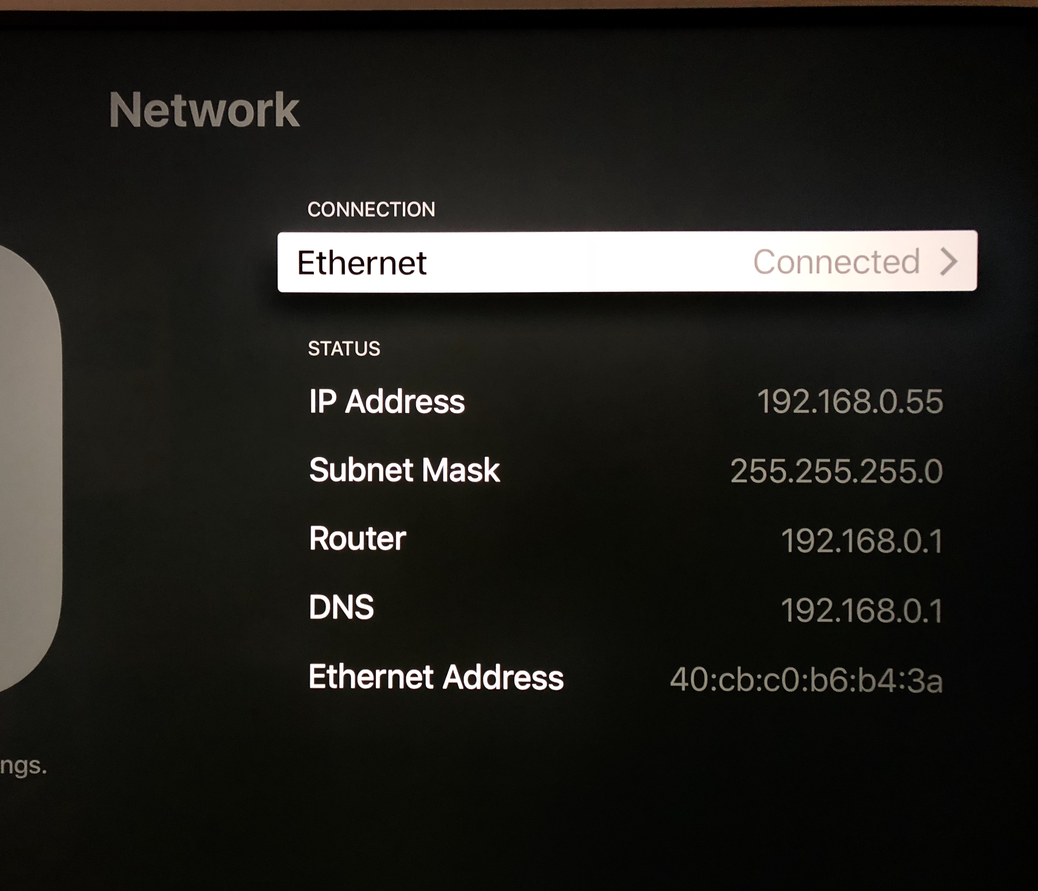

What does your network status look like?
Are the addresses you see there in the same range as rest of your network?
