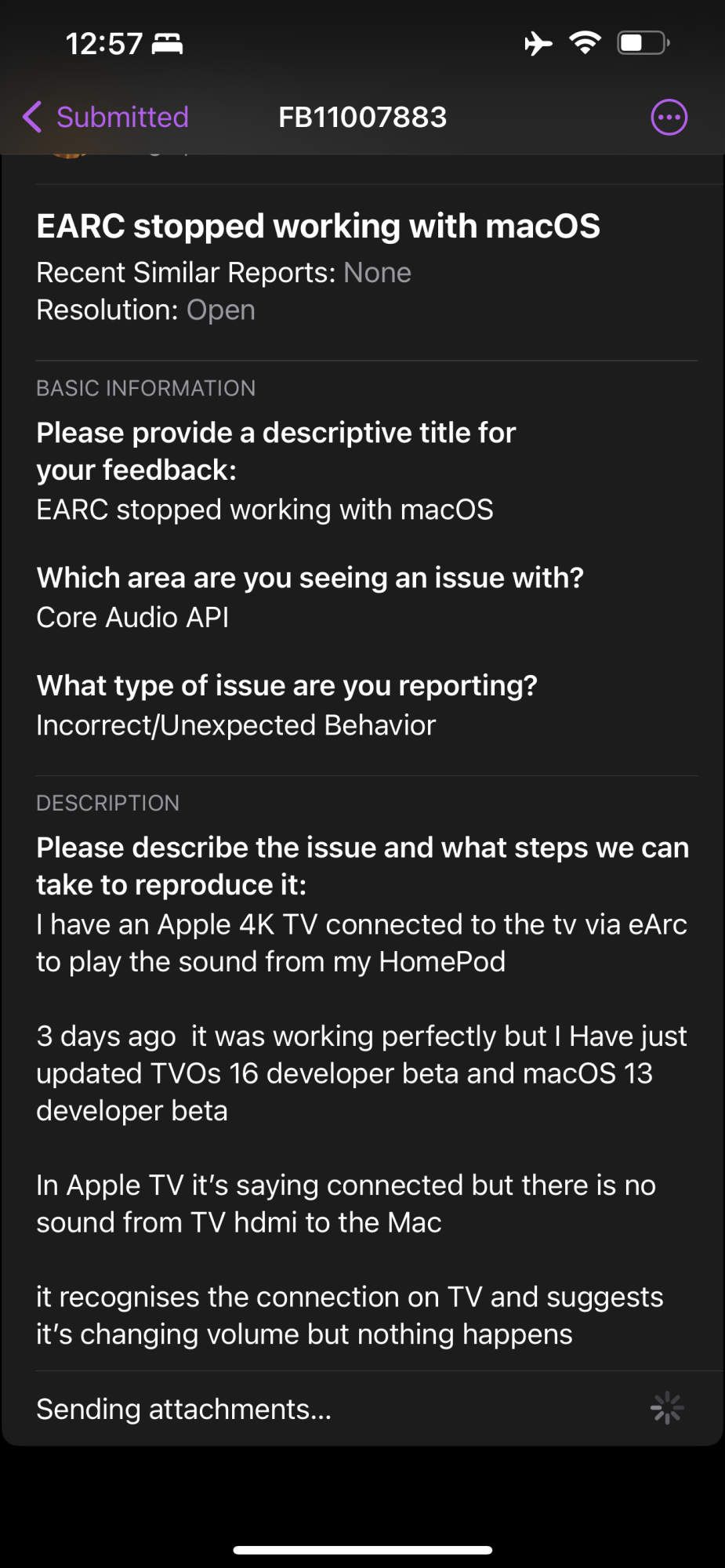

This just happened to me starting 3 days ago
, now I am gaming on my Mac in silence
Should I report feedback to apple about the core audio API on macOS ?

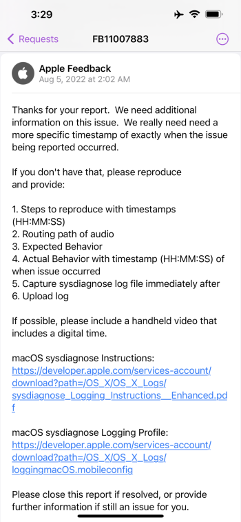

Has happened to me now
Apple just responded
Well ,
you guys should be using the feedback app to report issue to apple also
Feel like I’m the only one reporting on many issues and bugs
