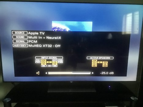

I have my ATV feeding a Marantz 6012 receiver
In settings on the ATV:
If I have Audio set to auto, I get full multi channel audio from all speakers. Unfortunately when I play music, that is also output to the Marantz in 5.1
If I have Audio set to Change Format DD 5.1, I get my music back in stereo but I also get my movies played in stereo as it seems to be reading the alternate audio track on my movies ( they are made with both stereo and multi channel audio obviously )
There doesn’t seem to be a happy medium where the ATV outputs the correct track so that the Marantz can just decode the movies and the music tracks accordingly.
Any help would be appreciated as it is starting to drive me nuts
I am currently on 14.4 and do not want to update the OS
Rebooting the ATV seems to be a temporary fix. Music back to stereo, movies in multi channel. So it is possible for the ATV to behave correctly which is also weird. However, play a movie again, then go back to music and the music is being fed as 5.1 again.

1. Yes. I can see both source input and output
2. Movies aren’t the issue generally. I’m getting PCM multi channel
However, switch to music and then the fun starts

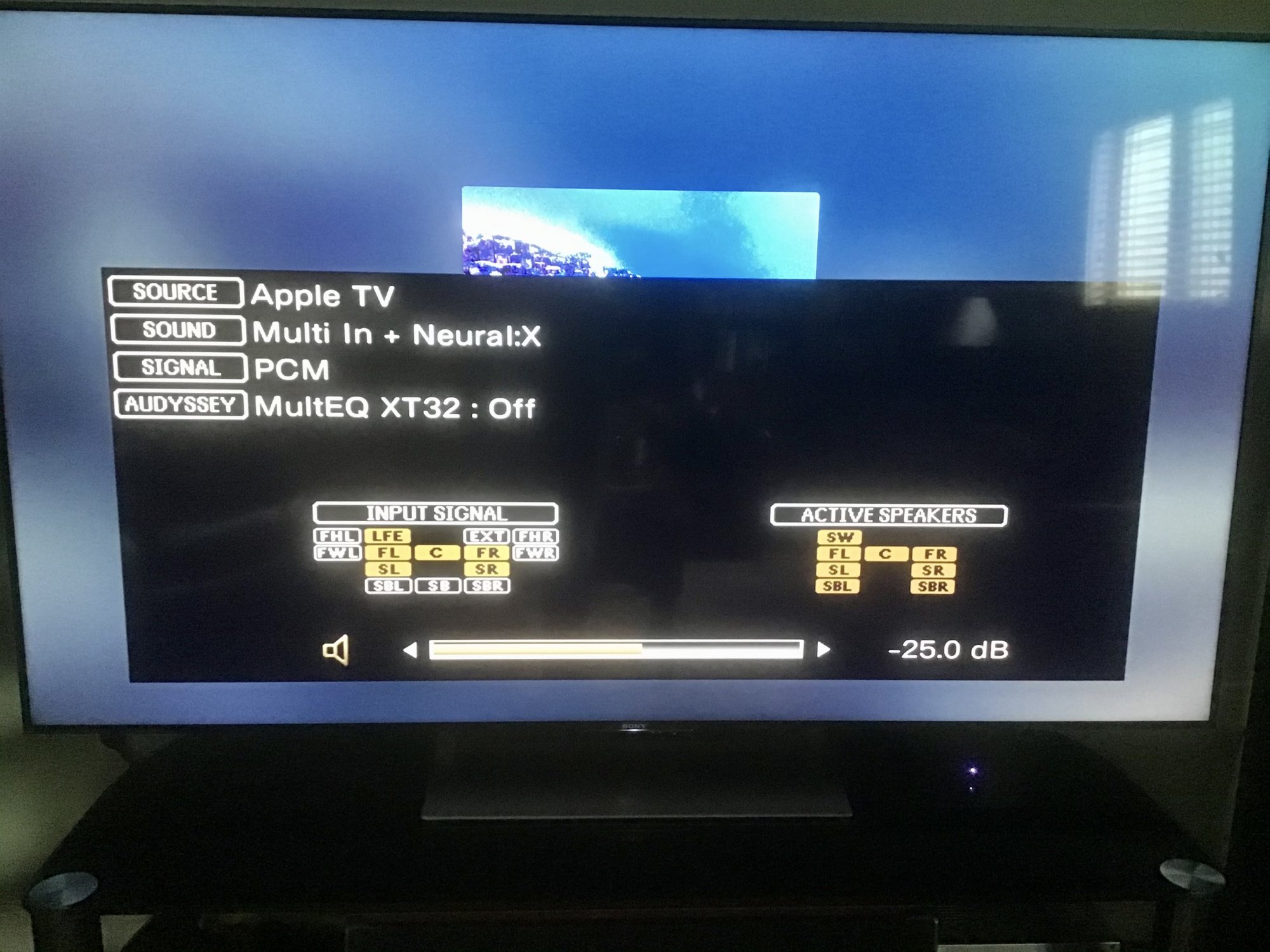

The Marantz is set to auto and as you can see from the screenshot it is receiving multi channel while listening to a stereo music track
I can of course force the Receiver to output stereo but that doesn’t alter the fact that it is receiving multi channel and doesn’t solve the issue unfortunately

Tried it yesterday after watching The Godfather. Played a music track all 7 channels lit up and sound coming from all speakers. Rebooted the ATV. Played the same track and I get correct 2.1 sound. So it’s not the tracks, it’s the way ATV is handling the audio.
