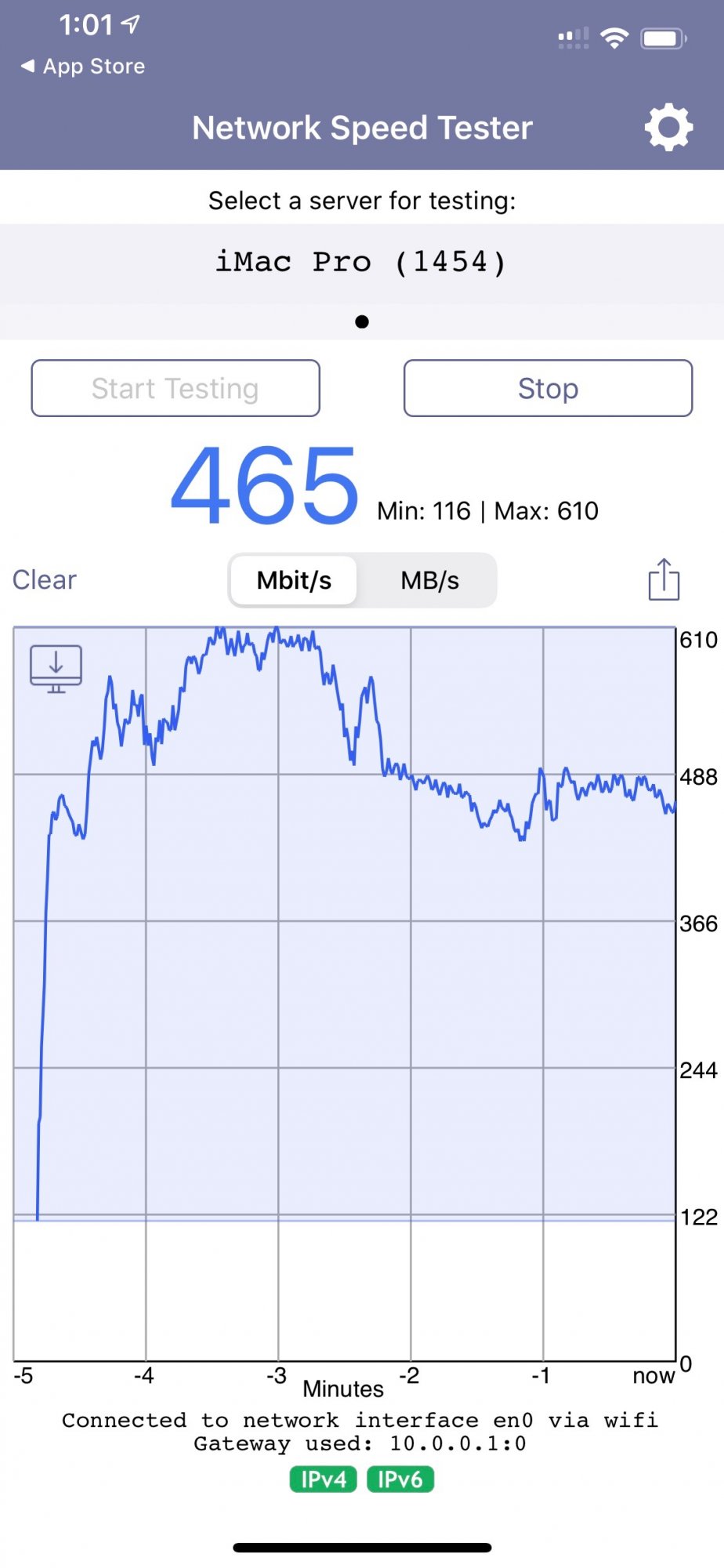

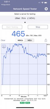

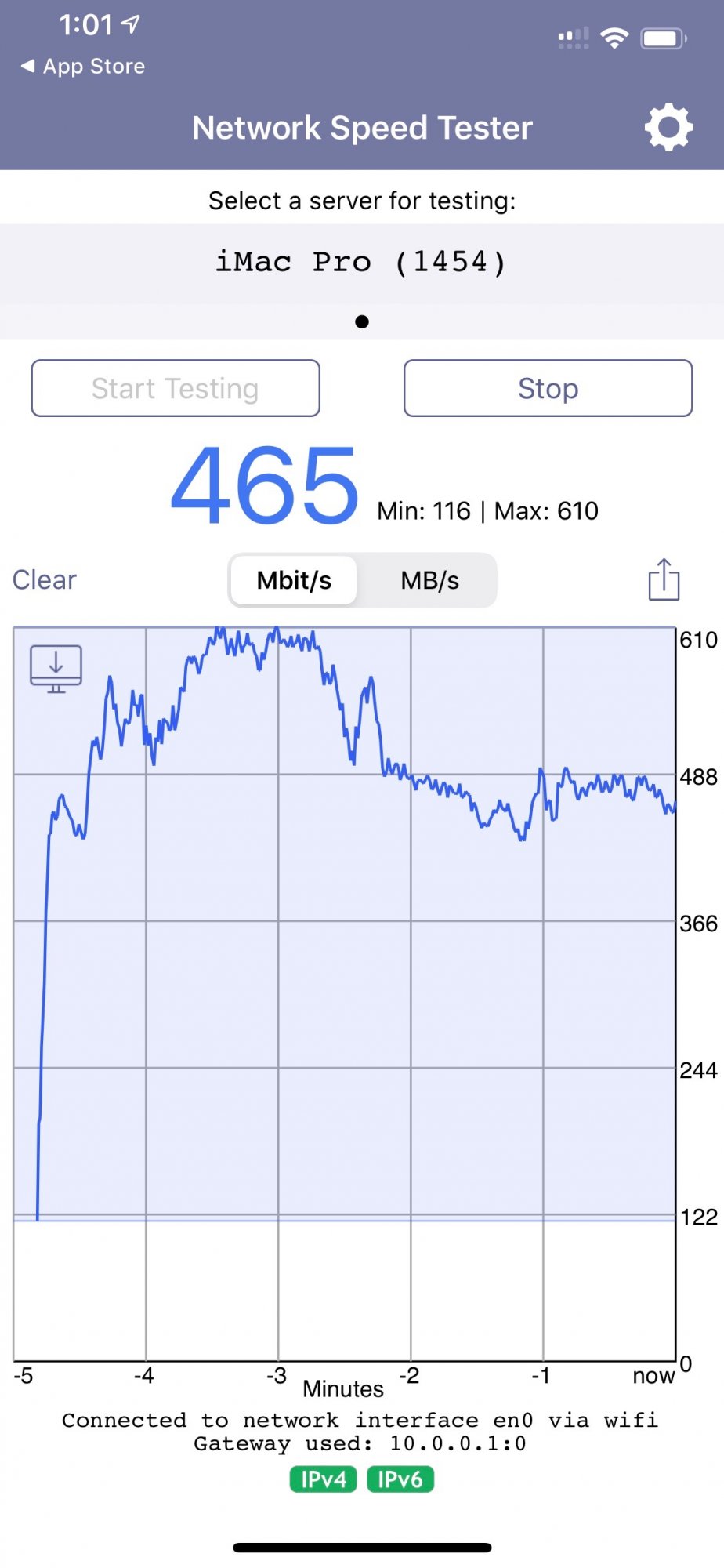

Test your local network speed, not the speed provided by your ISP, by using a program such as Lakehorns' Network Speed Tester. You run a server program on your Mac (or other Apple Device), and the client app on your Apple TV, iPad, iPhone etc. This gives you the speed on your local network. If the values are low then you know you have to look at your router connection.
Client image is from my iPhone as my Apple TV Developer Hud screen shot is not working.

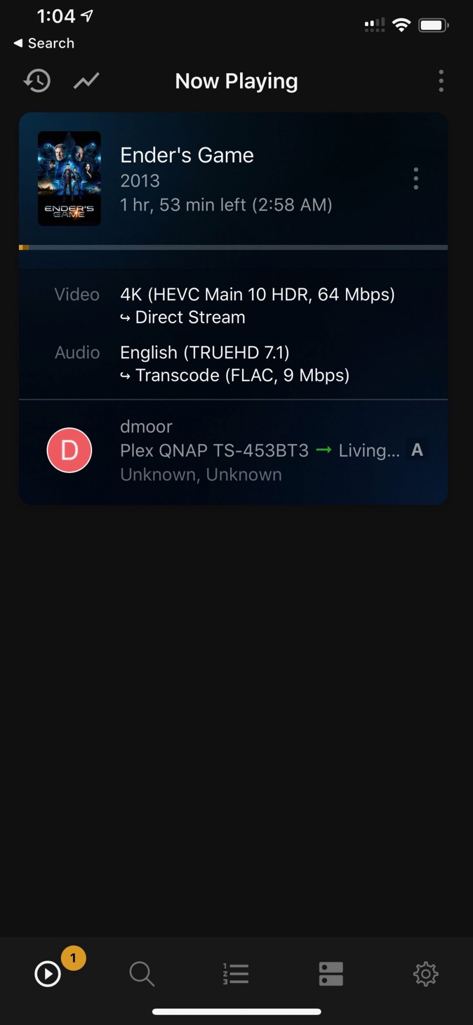

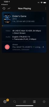

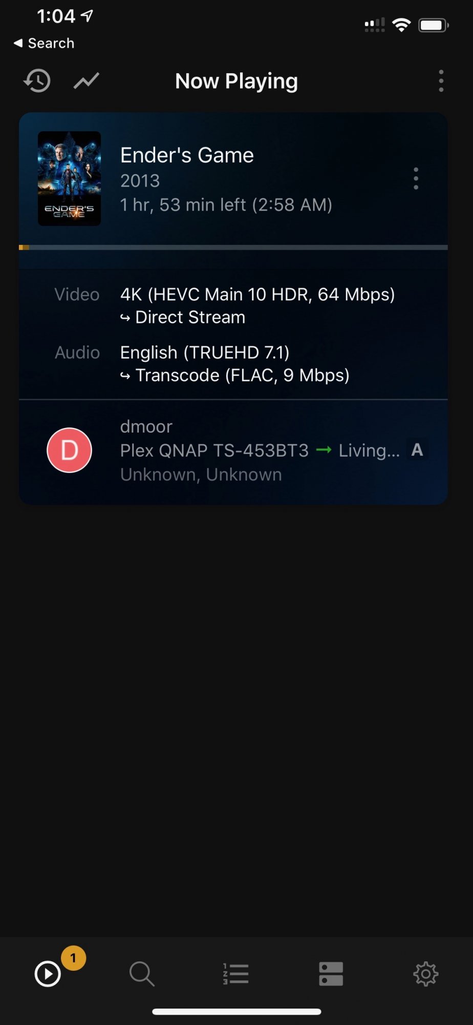

I've never experienced that, with speeds over 100 Mbps with 4K UHD sources. For example I'm streaming Enders Game at a total bitrate of 73 Mbps with no problems:
