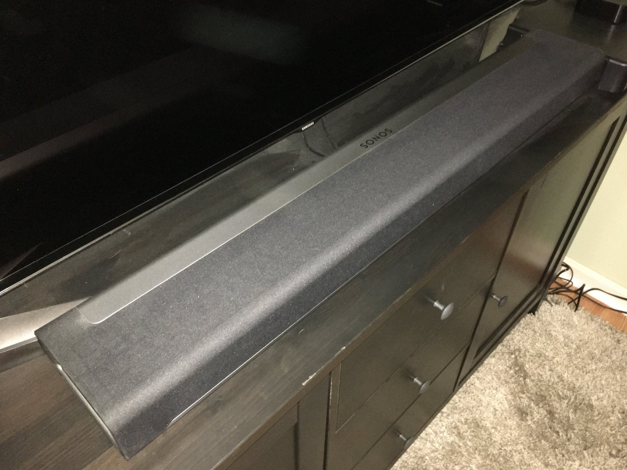

The beam gets it sound via HDMI-ARC.
It doesn't have a delay setting.
and it doesn't have processing like that. It's always in 'straight' mode.

I can deal with the Beam only being 5.1, really that is all I want/need. The speakers are more than capable, quality over quantity at its finest. What I can't deal with is the system only supporting a 25 year old very lossy codec, Dolby Digital. No DTS, no DD TrueHD, no DTS HD, no Dolby Digital Plus, etc. I can't see how the cost of the entire system could possibly be justified for use as a home theater when it doesn't support home theater audio.
