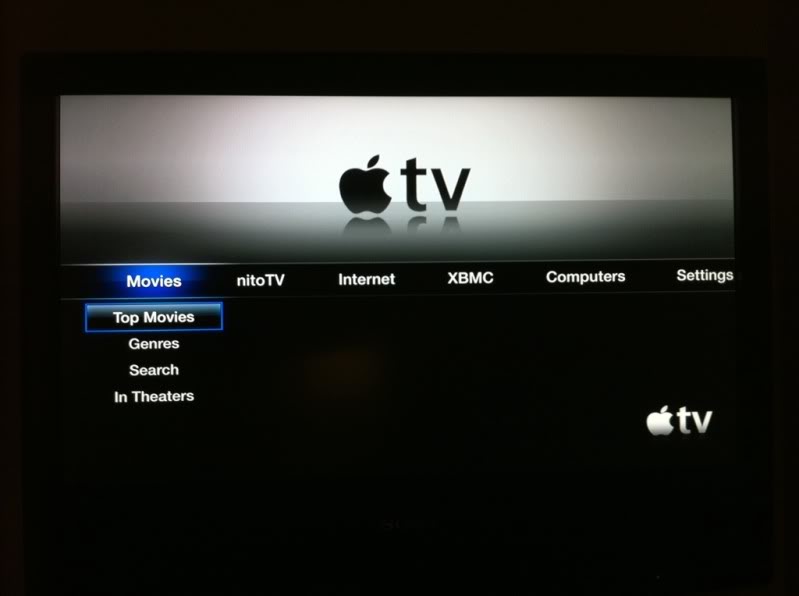

Nope, no ssh'ing required before. It may take a few attempts but wait for the little Atv light to stop flashing after it's complete.

On the main Atv page you will have a new menu item, nito tv, from here you can download and install xbmc.
