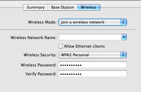

you can use the ethernet port on an N express when it's joined to a wireless network, you must enable the check box by "allow ethernet clients".
I don't normally do this in my setup at home, but i have tested that it works in response to a post some time ago in these forums (actually made the response post over that connection) I use a linksys router running dd-wrt, and the express was set up to join the network, not extend or WDS.

you can use the ethernet port on an N express when it's joined to a wireless network, you must enable the check box by "allow Ethernet clients".
My own N Express is failing to even present me with that box, unless it's in Extend or WDS mode when running the latest firmware.
