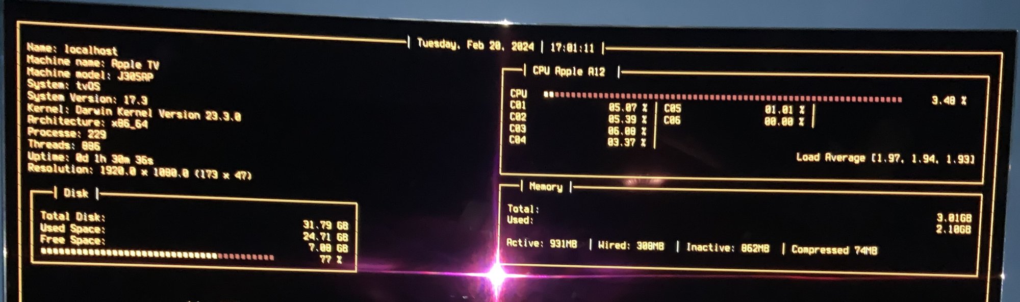

System Info hasn't been updated for a while, so one of its windows doesn't work properly. Specifically, the one showing memory usage. So, I tried several other similar in concept apps and found that Hex Terminal seemed to work best. Here is a photo of part of what Hex Terminal says about my ATV. This is just with Hex Terminal running.
(Sorry for the quality - I didn't really feel like setting up AirPlay and all that just for a screen shot of some numbers.)
Note that this ATV has 32 GB of storage capability. And, 77% is being used! I added up the footprints of all our apps as shown in the Manage Storage portion of Settings and it came to about 1.9 GB. I'm not sure what the rest is being used for.
With just this one app running, 2.1 GB of the 3 GB memory system is being used. I could see a possible issue there. But, why?
Is there some not so obvious setting causing this? Screen savers run amuck?
