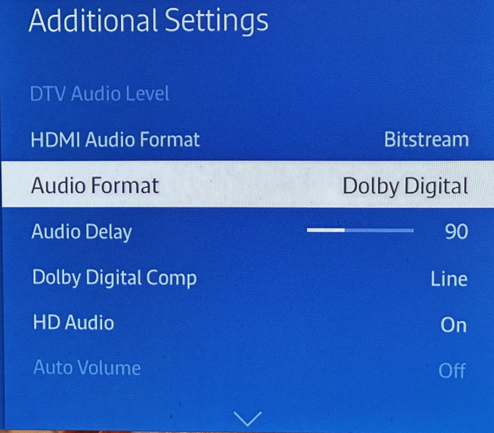

Here's how I mostly solved this.
In the Samsung TV Menu > Sound > Additional Settings > Audio Format > Dolby Digital
This significantly increases the volume on the AppleTV app.
The strange thing is that if I watch digital cable TV, the Audio Format automatically changes to PCM. And it stays there and can't be changed to Dolby Digital until you actually start watching a video on the Apple TV app. You can't change it to Dolby Digital while listening to Apple Music or watching a YouTube video.
So, in the end, it's easier to just crank up the volume while watching the AppleTV app rather than going in to the TV menu to change the Audio Format every time.
I really don't understand any of this.
Any explanation out there?
TIA

Thank you. I understand a bit more. Since you seem to understand much more than I, what TV Audio settings would you recommend? I posted a screenshot above of what settings I'm using now.
And, given my setup, what tvOS audio settings would you recommend?
I do not know anything about Samsung TV-s, hence I can not say about it's audio settings.
I would connect aTV to soundbar via HDMI, if at all possible.
Your setup (esp. the optical output from TV to soundbar) is the most limiting factor - you can only get stereo PCM or compressed Dolby Digital / DTS surround audio in 5.1
As I said, aTV only outputs PCM in multichannel by default.
You could switch it to change audio format either to Stereo or Dolby Surround - both would also cross optical cable to soundbar.
If you leave it on Best available, it will mean, that your TV must step in and convert audio from PCM multichannel to stereo or Dolby Digita. I personally would avoid TV modifying the audio in any way, but in your setup, that may be the only way (unless you can connect aTV directly to soundbar).
