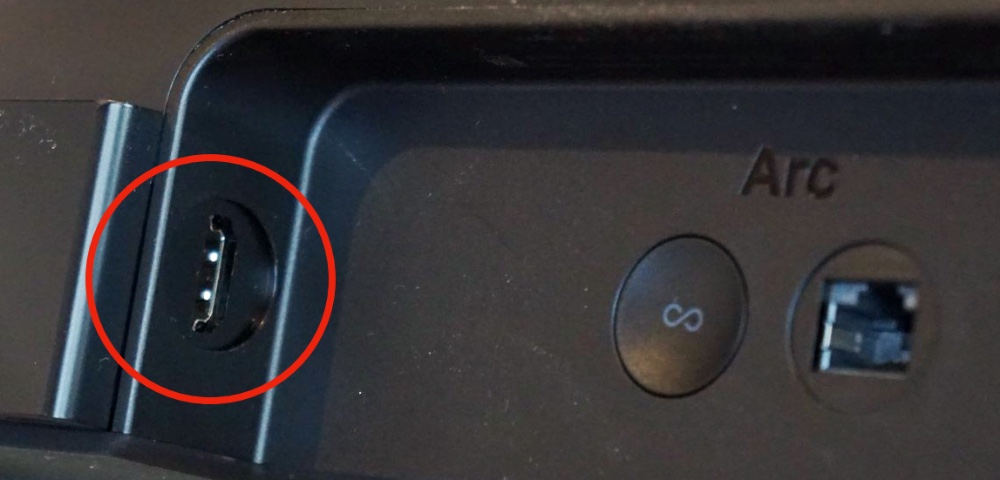

I'm about 99% sure that Sonos Arc (soundbar) has only a single HDMI port. Mine is in a difficult to reach spot to re-check that but I looked online and the spec list also says 1 HDMI port. And here's somebody's picture of the lone HDMI port...
Are you sure it's a Sonos Arc soundbar? If it has 2 HDMI ports, I think it's something else. If you have some other Soundbar with HDMI IN and HDMI OUT, then yes,
AppleTV HDMI OUT to SOUNDBAR HDMI IN • SOUNDBAR HDMI OUT to LG TV HDMI IN​
That should "strip off" the audio before it gets to the TV and forward the video to the TV. And that should work just fine since you are not relying on the LG software to do anything with the audio.
Update: And I rechecked that first post and see that you do NOT have a Sonos Arc soundbar but one from LG. Sorry I missed that. I saw ARC in the headline and assumed you had a Sonos ARC (name of soundbar).
So yes, TRY running the HDMI into the LG soundbar HDMI IN, then out of it to the TV. That should at least get around any bug in CEC software in the TV. Basically AppleTV CEC should be "controlling" the CEC stuff with soundbar. It might not solve all problems (particularly ON/OFF of all 3 parts) but it has a pretty good chance of solving the volume up and down issue since you will be bypassing the TV processing for audio. Odds are pretty good that AppleTV and the Soundbar will easily work together (on/off and volume up/down) but the TV may continue to not comply with on/off until there is an update.
