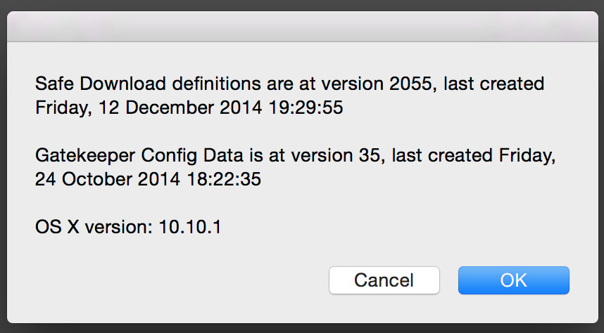

Thanks again.
My main partition updated itself but I have a small utilities volume which is not running very often or long and the manual update is useful.
Any suggestions how to get Gatekeeper up to date on my rarely used partition?:

Thanks I will certainly try that in future, but note that in my screenshot above, Xprotect had run for 12th Dec update, but Gatekeeper was still in October.
Does the Terminal command update both?
It does update both.

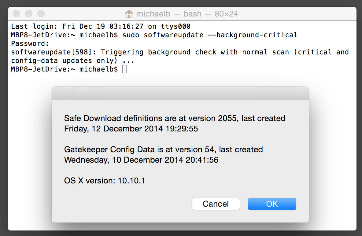

I tried the Terminal method on a small OS which only boots occasionally and for a short while (so doesn't get much time for the intended process to happen).
Unfortunately it didn't work. As the screenshot shows Gatekeeper stayed at 10th Dec version.
I tried three times, allowing about 15 mins each time for the SU to happen.
Is the Terminal response as expected?
Thanks.

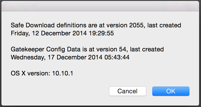

UPDATE After trying as above, I immediately rebooted the small OS and checked versions again, and it was at the 17th Dec version.
Is that how it is supposed to work? i.e. the Terminal instruction forces the update next reboot, rather than immediately after the instruction?
Just noticed that although date has changed from 10th to 17th, it is still version 54??
