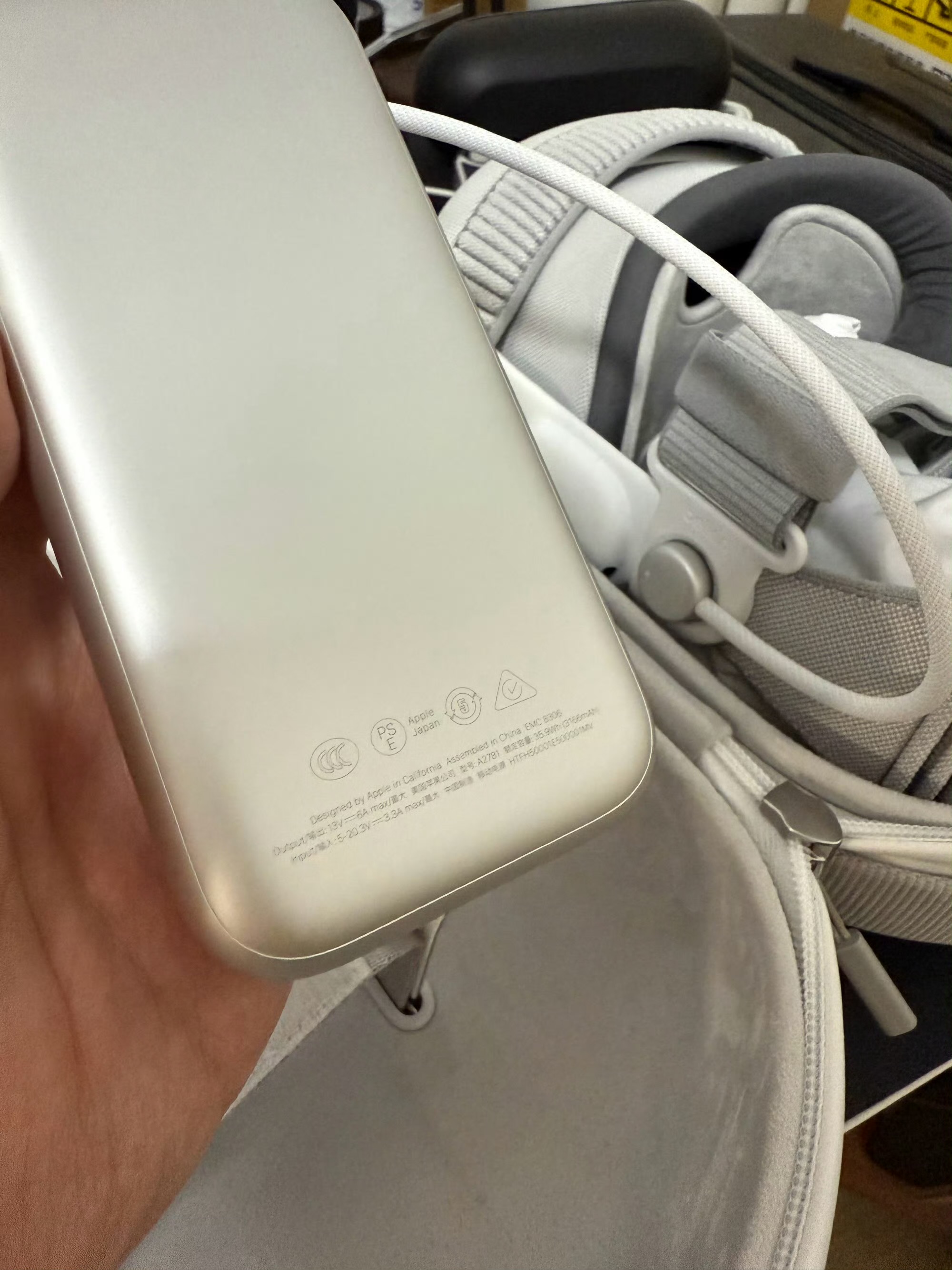

I will be flying to East Asia for a several months stay. Would like to bring my AVP along with me (not necessarily for use on the flight). Anyone familiar with latest rules on taking the AVP battery along under the new restrictions imposed by airlines? It cannot be in checked luggage and I do not want the battery confiscated or denied as carry-on. As you know the fine print reference to the AmpHours on the battery is tiny to the point of being unreadable. Not even sure if TSA sees enough of these things to be familar with them. Right now leaning toward not bringing the AVP at with me at all but thought I would seek collective wisdom. On-line search of this specific question was not helpful. Thanks.

The IATA published new guidelines for Li-On batteries/phone chargers and air travel in March 2026. The Watt Hours (Wh) must be visible on the battery. After using a magnifying glass to read the fine print on the AVP battery it has 35.9 Wh which is well under the new limit of 100Wh maximum. The no luggage checking of Li-On has been the rule for a while. So, AVP battery is good to go w/carry on. TSA is checking the rechargeable batteries and power banks to see the Wh numbers and make sure they are within the limit. Ever anal, I will bring a small magnifier since the print on the battery is tiny and naked eye check will not do. With my luck TSA won't be able to read the numbers without it. It took some research to wade through the new guidance reference rechargeable batteries. And away we go.....
Chinese airlines require all power banks to have the 3C certification. The Chinese market Vision Pro batteries are certified and marked, but not U.S. market ones.
