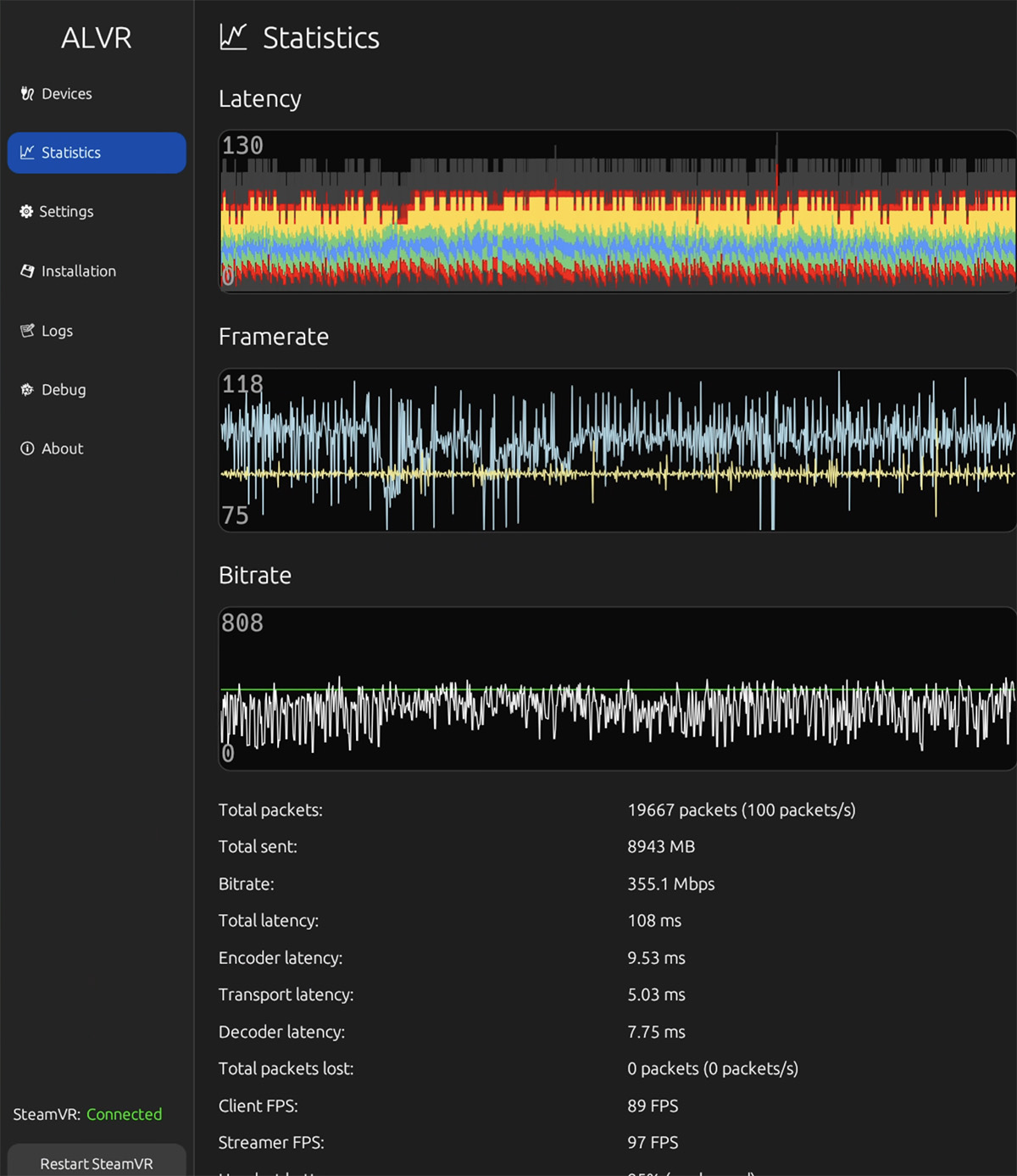

I've attached a screen shot from alvr, latency is 108ms, that's at quality P4. The quality presets range from p1 (lowest latency to p7 highest latency)

Thanks! I'm really glad you're enjoying the experience, but.... that is a huge amount of latency for virtual reality. Usually VR headsets target 20ms or less for the entire chain.

it probably can get better, but at that point it won't be worth it, as the compression artifacts of lowering the quality will ruin the picture. But it works well flow games like flight sims
