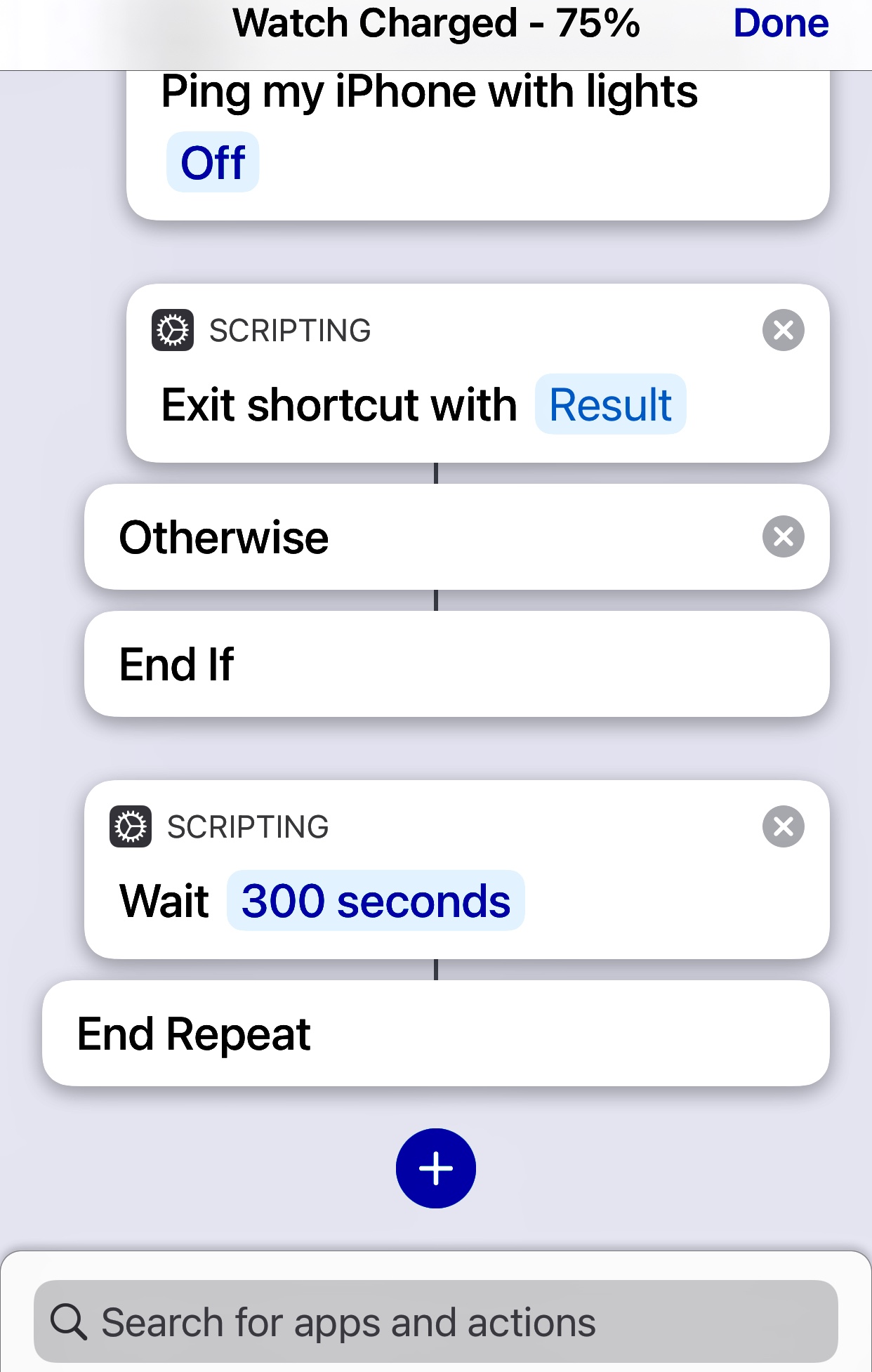

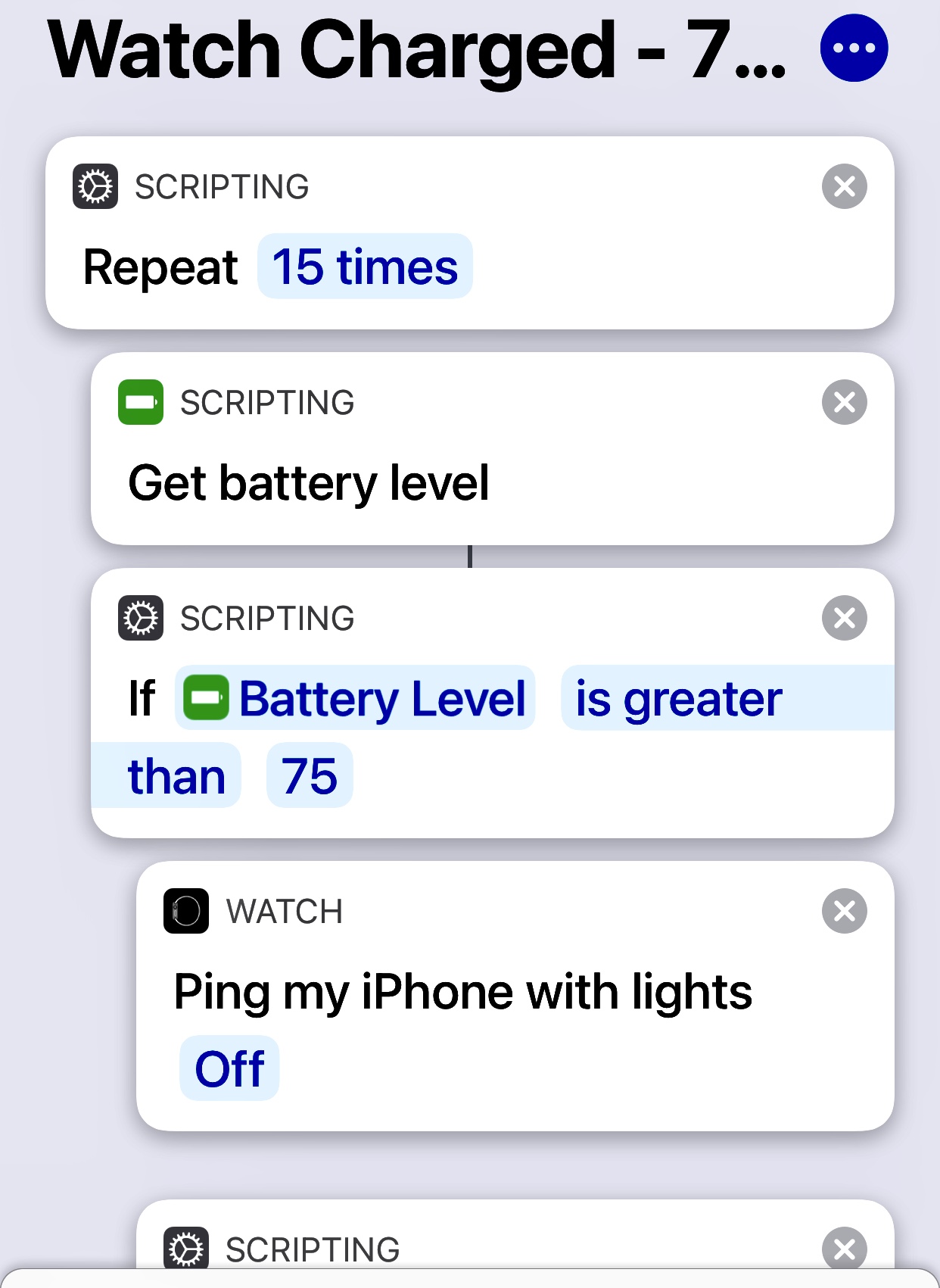

I created as shortcut so my watch pings my iPhone when it's charged above 75%. It's just a loop that runs 10 times and then every 5 minutes it will do a check on the battery and if it sees 75% or more it sends out the ping. I just have to tap the shortcut when I put my phone on charge. It's not perfect but it works surprisingly well.

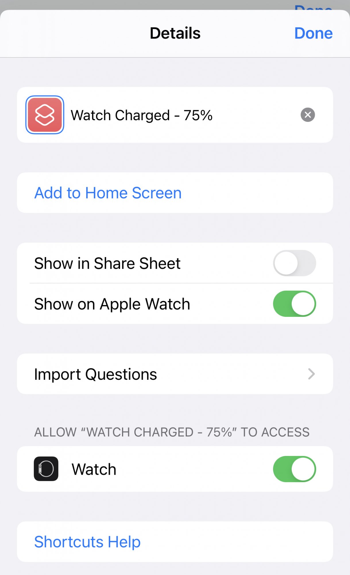

Can you share how to do this? I’ve searched the internet and still have no clue.
Create this on your phone, then make it available on the watch.
There is a REPEAT (15 times) and then inside the repeat there is an IF to check the battery, then following the IF there is a WAIT.
