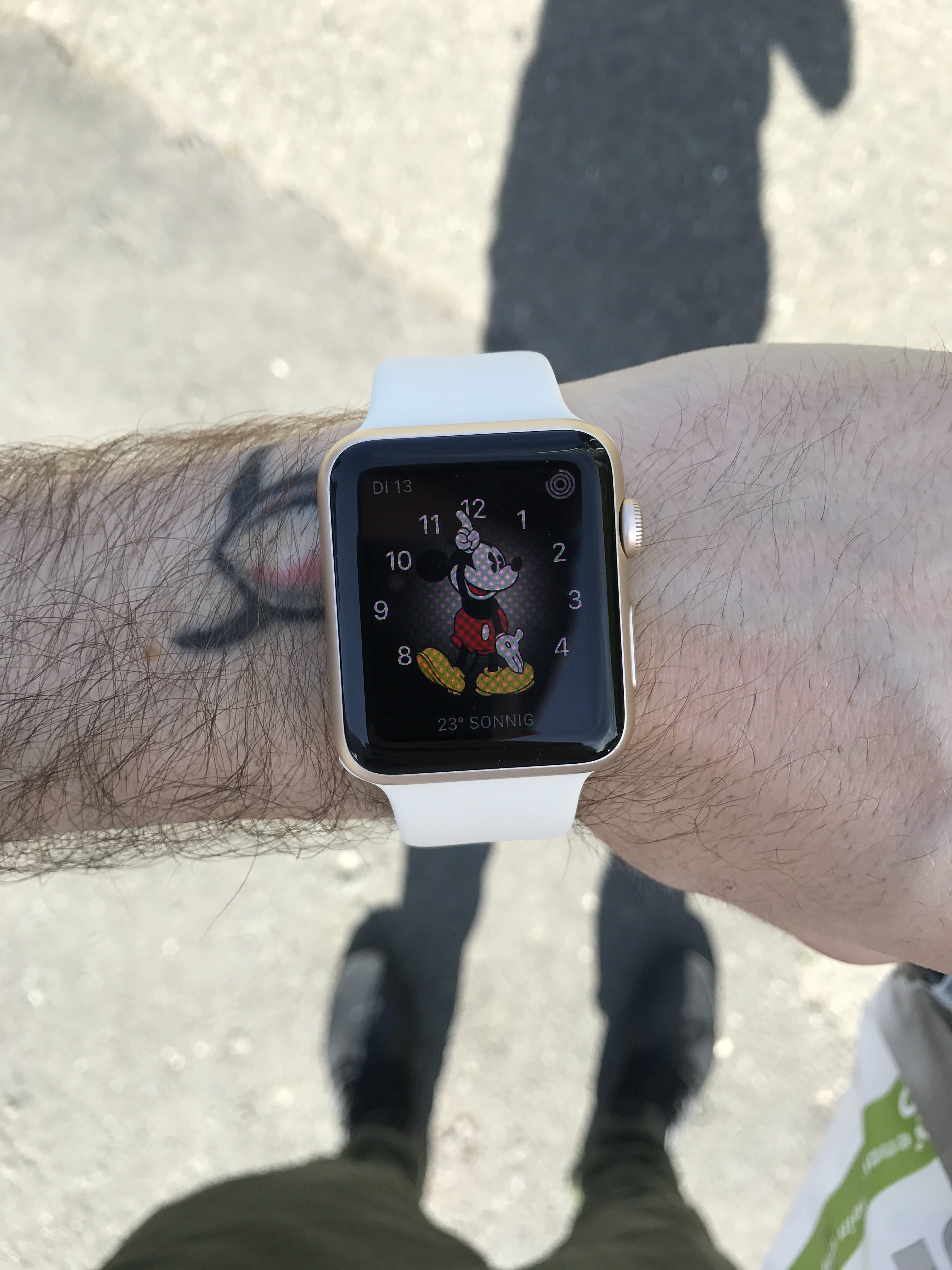

so I have a black and grey sleeve tattoo, not solid lots of small details. I've tried the watch in both wrists and the heart rate sensor is pretty much identical on each wrist, the tattooed and the not tattooed. However, on the tattooed wrist it locks every time the screen goes off. On my untattooed arm, it doesn't lock unless I take it off. It seems odd since the heart rate is the same on each wrist but wrist detection trips?

The Watch senses when it's on your wrist. Regarding the tattoo, it's having difficulty to sense the wrist detection due to reflectivity. I have read where other forum members have had the same situation you have.

Yep, still accurate on the tattoo arm. Seems like they use different techniques to detect the wrist and to measure the heart rate.
Huh so wrist detection works by shining light on the skin and measuring how much is reflected, so dark tattoos interfere with the reflection and cause wrist detection to fail.
Must be a different technology than heart rate, since that uses visible green light and wrist detection uses invisible (infrared?) light.

The Apple Watch uses photoplethysmography, which essentially enables the rear LED sensors distribute light towards your skin and measure the skin, which immediately reflects back. If there is no reflection or little reflection, Passcode is engaged. Hence, dark tattoo's have very little reflection due to the dark ink.
The other two sensors are illumination sensitive photodiodes, which detect reflected light from your arms blood vessels and as a the heart beat is happening, the blood flow is occurring and the green diodes absorb the light to distinguish between beats as the reflection differentiates.
