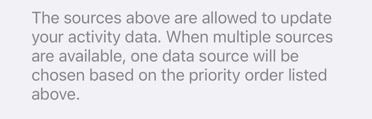

If I use Polar H10 and Apple Watch concurrently, how is the data in the Health updated for example during a walking workout?
You pair the polar to the Apple Watch then walk, it turns off the aw heart rate so the data just comes from the polar.
This, or when you have “competing” data sources, this is what the Healt app says:
Reactions: srknpower
