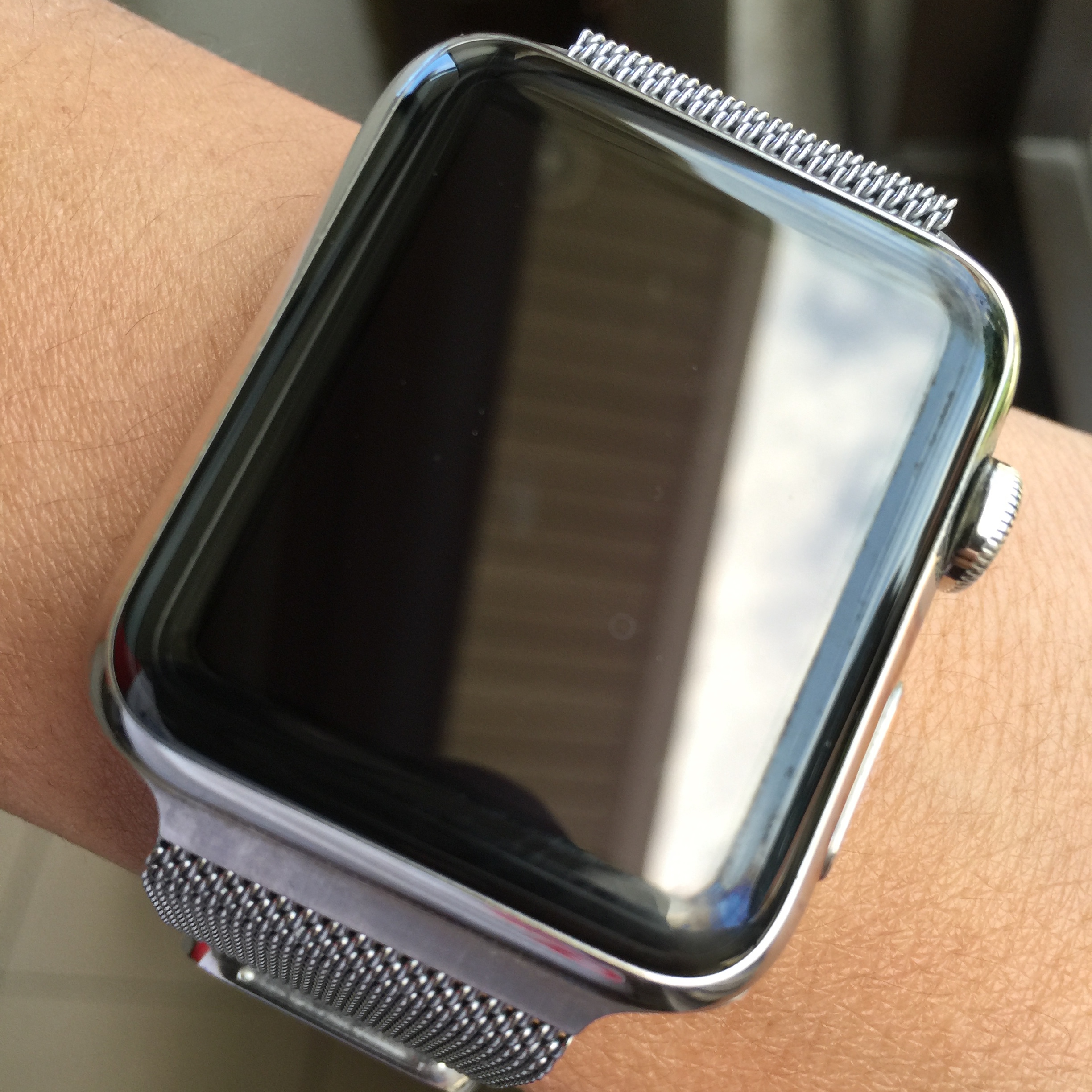

Hi guys... I have an Apple Watch and it seems to have some condensation problem. It shows up when I'm outside the house or walking on the street, but if I'm in an air-conditioned place like the house or in the car, it disappears.
Just wondering if anyone else is having the issue. BTW this is the second time this has happened. Apple replaced the watch last march because of the same problem. Apparently the same problem happened again in just 4 months.
I really take care of my watch. I never do workouts or anything physical. I only go back and fourth to and from office.
Here are some photos:

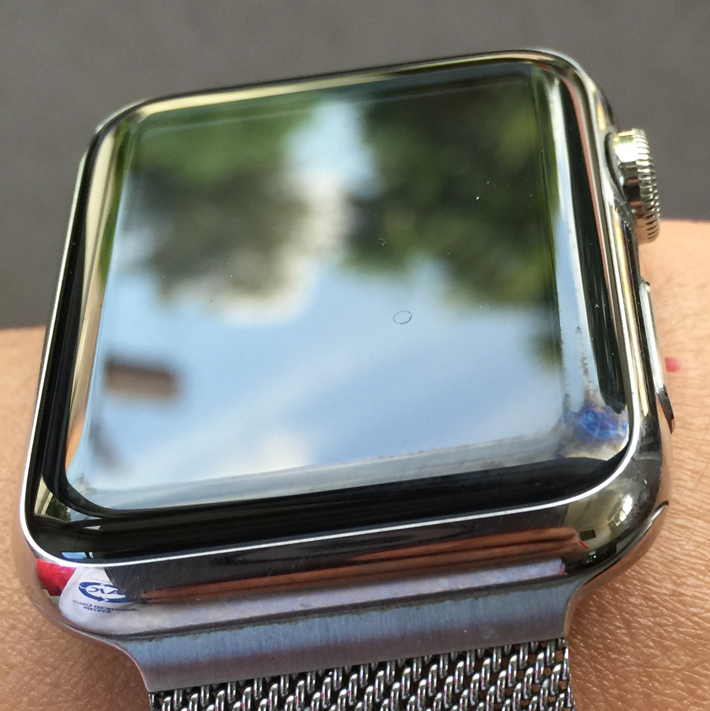

The little round area does not look like moisture to me. Moisture usually shows up as a fogged area and not a single dot like in the images. Just my opinion looking at the images. Almost like a oil drop or maybe some adhesive they use in sealing the watch.
Strange indeed.
Strange indeed.
Commented on this thread before but did not look at the pics. That is definitely not what condensation looks like in any way. A conundrum indeed.
Speculation: It almost looks like a small drop of some type of strong solvent got on the crystal and was left on the screen (not wiped or at an angle to run) damaging the oleophobic coating.

Check out the photos. People are questioning whether it's actually condensation. When I first saw the photos, I looked in the wrong place and assumed that the larger splotches were imprints from the condensation, but it appears that the issue is the very small, sharp circle near the center of the screen. That doesn't look like condensation to me.
Yep, I did. The sharp circle looks like either a bubble under the lens or (when you really zoom in) it almost looks like a stone impact on a windshield. 🙂 This (especially if it disappears) could be caused by imperfections on the coating on the inside of the sapphire, which appear when the condensation appears.
Along the edges, it appears there's something under the glass - that looks more like condensation to me.
