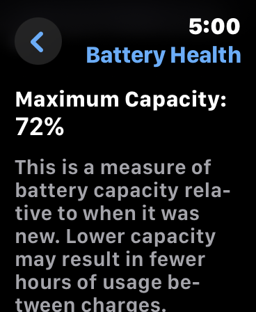

What's the battery health?
I'm guessing but likely below 80% so with a degraded battery this seems "normal" behavior, and cold temps don't help either.
Thanks for replying. It’s at 73%
So a dying battery will force it into what I can only describe a boot loop? Normally I’m notified when the capacity hits 10% and goes into low power mode. This didn’t happen
I have no first hand experience with batteries at such health, but what I've gathered from various posts here is that people see very erratic behavior with devices of such poor battery health, like going down from 60% battery to basically shutting down within minutes.
And I also don't know of the accuracy of battery health at that level of 73%.

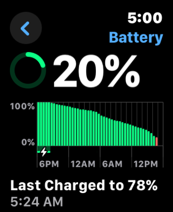

Does it take a charge now?assuming it was drainedrit's be interesting to see what battery health says now and also look at the battery graph whether that looks unusual, eg sudden drops.
if it were me, I wouldn't trust that watch to survive another 6 months till new watches are released, and right now, they're on sale almost constantly it seems, I'd get a new one. I think getting 6 years out of your was a good run.

Today for example…9 hour work shift and a walk to the super market.
Yep it charged up and in fact lasted the evening
