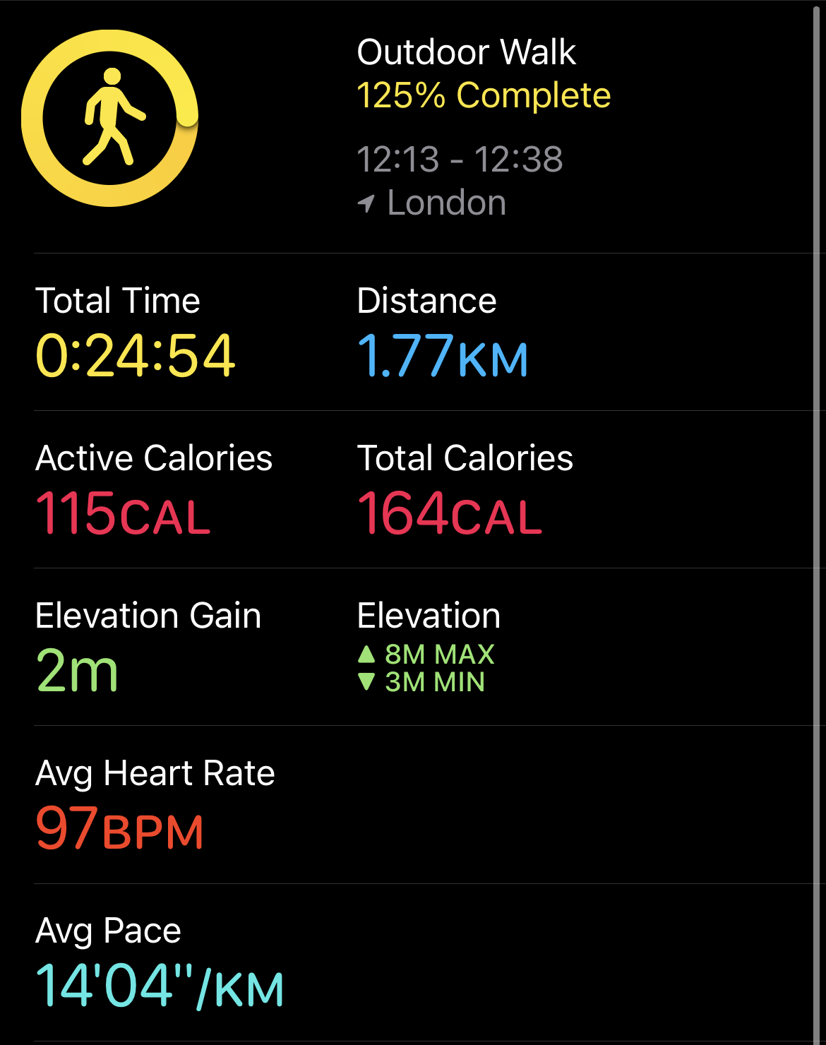

Having a real issue with my exercise ring, and at this point I don't really understand what's happening, so perhaps some internet help might be good.
My exercise ring set on a walking exercise just never seems to increase. For example I've done this walk yesterday:
Which gave me just 9 minutes exercise.
I did a similar one today:
Which gave me just 4 minutes.
Now I know it's related to your heartbeat, but what is the algorithm? I have a resting heart rate average of 64bpm, so surely if I'm walking for nearly 3 hours with average heart rate of 102bpm I should be gaining more than a few minutes exercise.
Both walks were done with someone else with an Apple Watch. Different people. On the first walk my friend had 93 minutes exercise (vs my 9) and on the second my partner had 51 mins exercise (vs my 4).
Their resting heart rates were similar to mine (in fact my partner's is higher) and their average heart rate was similar to mine on the walks.
Apple chat have been useless, just saying "the watch works it out based on your heart rate" but didn't really know HOW it works it out or what I need to be aiming for to get it to count.
I took my old watch to the Apple Store and the guy there said it could just be it's an older Series 4 watch and might have started not to look at my heart rate enough (I've been having this issue for a while now) so I actually bought a Series 6 (which is what these walks used) but it's not fixed the problem at all.
So: IS this an issue? Is my heart just really weird? Is there something in the iPhone software that's the issue here, rather than the watch? I just refuse to believe that a fairly brisk 11km walk is only 4 minutes of exercise.

I just went for a 20 min walk without setting any workout and I managed to get 13 mins exercise so it seems to be an issue when I set a walk workout.

Don't know enough about the internal logic of the watch, but maybe your general fitness level is such that it won't count a "normal" walk as exercise if you state that you're going to "work out"?
My Watch would almost never give me exercise minutes for my outdoor walks unless my heart was at a rate I did NOT want to sustain. (I'm in my 70's, with a low resting heart rate). I finally gave up and just do my outdoor walks as "Other". That way I get credit for my total time. I do the same thing for deep water jogging in the pool. I know when my exertion level is where I want it to be; using "Other" I get exercise credit for the time I spend (which is what I want to track).

This is what I will have to do but it's frustrating as I want to see my map.
If you need to be practically jogging to get exercise on an outdoor walk then I'd use the outdoor run instead 😂

I'll use "core workout" for walks where I know it'll never register time due to heart rate. I've got a resting rate in the high 40's to low 50's. Unless I'm walking up a steep incline for an extended period of time, I never get full time spent on a walk. Sounds like a cheat, but if I go on a 3.5 mile walk with my wife (who somehow always get the full time), I want credit for the whole duration, darn it.
But it's only walks that do this for me. Running and biking (stationary exercise bike) don't exhibit the same behavior.

just a thought, is your height and weight set correctly in the heath app? Maybe it thinks you are not working as hard as you are based on your weight and hight? I have never had this problem but I can imagine your frustration, especially due to the lengths of those walks.

One thing I do notice is that my pace is much faster than yours. My pace is typically between 10.5 and 11 minutes per kilometer, whereas yours is 14+. Don’t know if that is significant or not.

Interesting observation. My normal pace is between 11 and 12 minutes per kilometer, and I get the full credit, too.

I did consider my pace, but then my partner is of similar build/height to me and our pace was the same but they had far more exercise minutes registered.

I do a lot of walking, the average pace is around 9.5 mins if I am alone or 11 mins if my wife is with me. We both always get the full exercise minutes each time, no later than 30 mins into the walk we get the 'exercise ring closed' message.
I know that does not help but it's further proof it should be counting them.
The only thing aside from a fault in the device is whether it is recording enough time above resting for it to be considered as exercise. I say that as your pace seems quite slow comparing that to being out with my wife.
At an average pace of 14.5 mins per KM, you may not be consistently achieving a high enough heart rate for it to count. Although it looks that way on your screenshot the higher levels may be so short that is causing the lack of count.
As an example, my wife occasionally walks to a local shopping centre with a friend who has a disability so is very slow. My wife in that 5km walk records only a few minutes of exercise as a result.
May be worth trying to disprove whether this is the case by doing 5 minutes of something at a more intense level and see if that records more or less the full 5 minutes.

True, and I’m sure a walk on my own might have a better pace than one with a friend.
I suppose my concern is when the person with me gets 91 minutes at the same pace, and our stats match up.
Well I even got a new series 6 for this issue which turns out didn’t address it, so I was then wondering if it’s the iPhone processing the data that’s the issue.
Did this walk today - lower heart rate and similar pace and I got 20 mins exercise for it.
Even walked the same route… was just getting my International Women’s Day badge.

I think I may have caused this. In the early days of my first Apple Watch I’d jog with the walk exercise option. I still do when I want to do sprints or have a walk/jog. This may have affected my ability to get exercise minutes when actually walking. That said my walking rate is slow - 18 mins a mile. My jogging pace is not great 12 mins a mile. Walking at top speed I can’t seem to break 15 mins a mile. But I’m not a thin guy.
I know people who walk faster than I jog. So maybe it’s me. But walking at 16-18 mins a mile my heart rate is under 120bpm.
I’ll try the core workout for when I want minutes but I’ve always accepted the fact that I’ll be lucky to get 10-15 mins of exercise minutes for a walk exercise. If I swing my arms while walking that helps a lot too.
I've been recording outdoor walks as Other for awhile now because I had the same issue. Mine started happening after an update, so I think there's a glitch somewhere. I just updated my watch to the newest OS last night so I might try using outdoor walk again today when I go.
