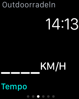

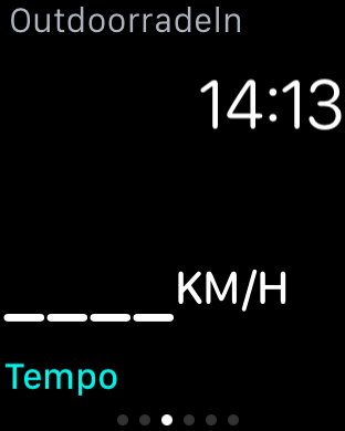

no cycling data
i have a problem with outdoor cycling. The watch is only counting calories and time but no speed or distance. It totally works with running and walking.
any ideas?
