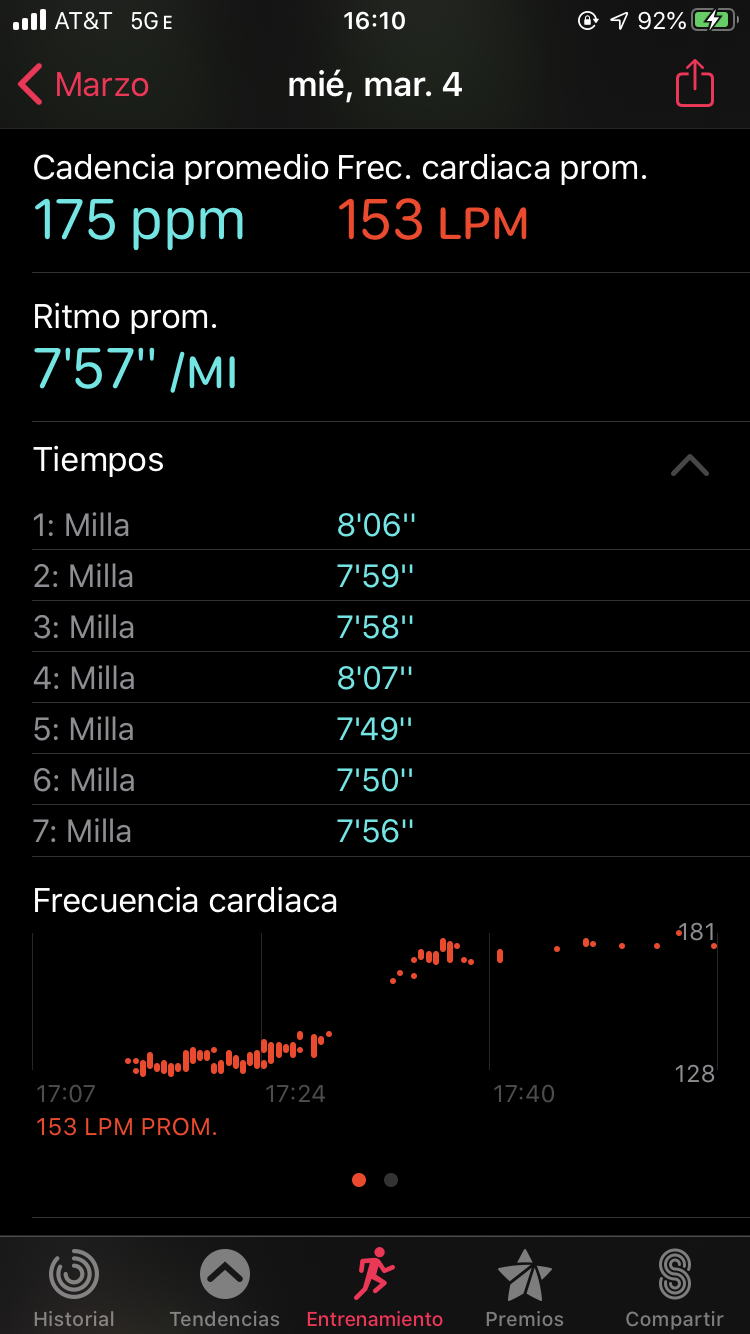

I've definitely had Apple Watch HR issues during the winter. It usually starts out well, but a few miles in, it often seems to lock onto my cadence (170-190) instead of my HR (most often 125-150). I assume it's a result of capillaries constricting too much due to the cold for a good measurement. I've taken to wearing a Polar HR strap during winter runs. (Wearing the Watch more tightly helps a bit, but on really cold days it is not enough.)
In warm weather and indoors, the Apple Watch HR sensors works remarkably well for a wrist-based solution. I also have a Concept2 rower, and the Apple Watch agrees quite closely with the Garmin ANT+ HR strap that I wear to feed HR data to the rower.
Edited to add an example from last night. I thought it was warm enough, so I didn't wear my Polar strap. It was an easy 6.x-mile run. My HR started off around 130, which was probably accurate. It clearly struggled after that, missing a lot of data and registering in the 170's when it did. Not coincidentally, that was also my cadence, as you can see. (My HR would be in the 170's in a 5K or 10K race, not on a recovery run.)
