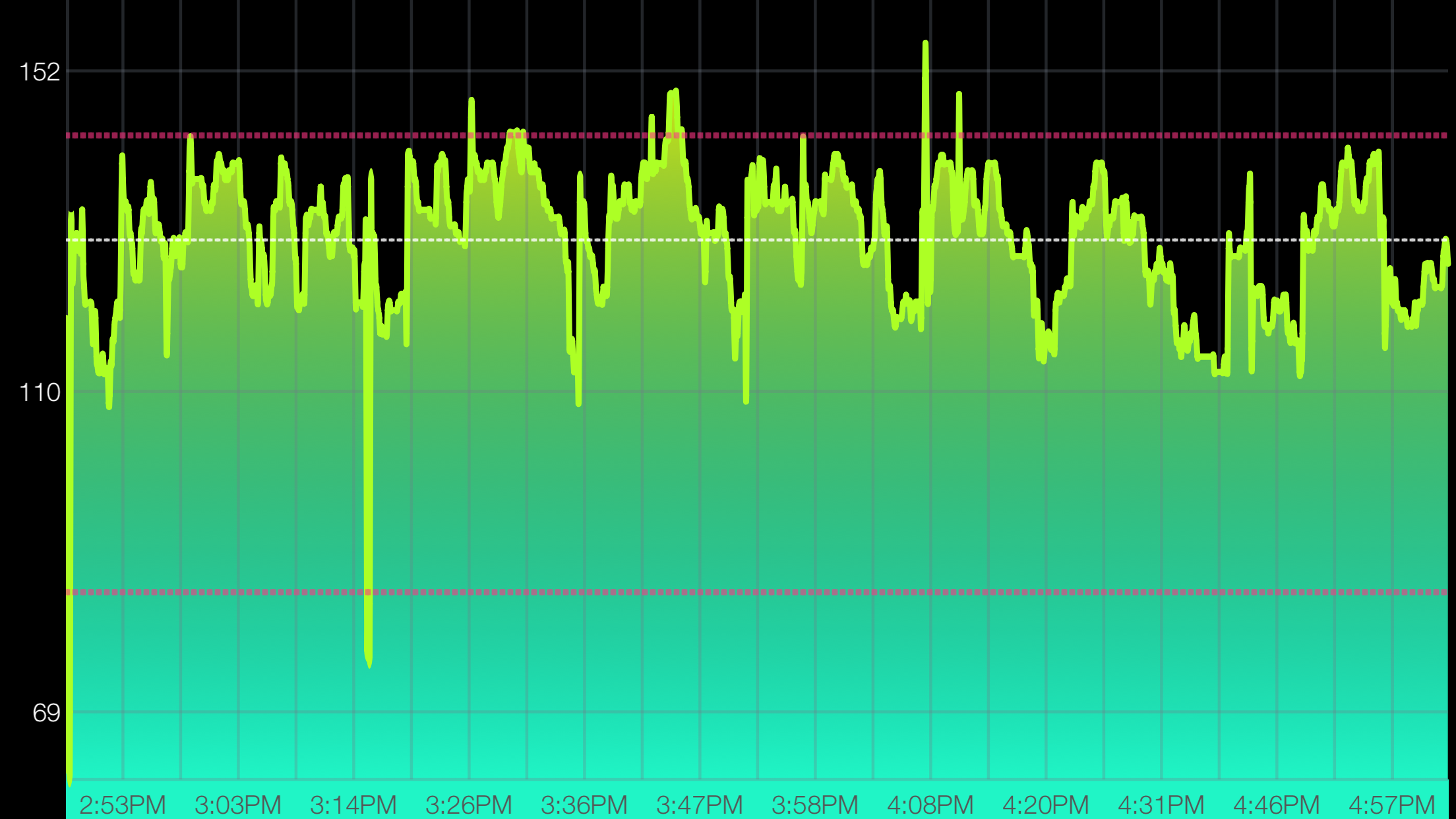

I wear my watch for all workouts and even golfing and I wear it one notch tighter and a half an inch further up my arm than normal. Just seems to be the best for me. During a two hour round of golf it seems to lose the heart rate once or twice and takes about 15-20 seconds to come back but during that period it registers the last heart rate. Over two hours this is such a minor blip not even worth noting. I graph the workouts using a workout app and it shows the drops but they are insignificant overall. My heart rate strap would lose the heart rate much more than the watch has in 3 months of usage. Just seems that all of these devices can move or slide a bit - especially the more we sweat. Overall, I am shocked at how well the watch has performed

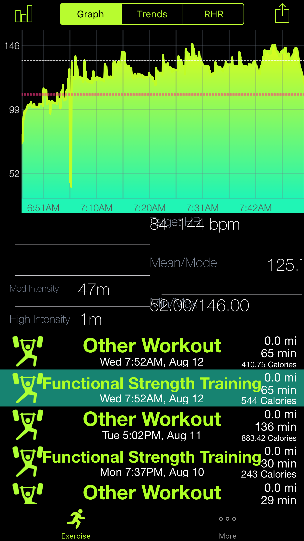

Glad to help. Here is the graph while golfing yesterday and I basically lost the pulse twice in two plus hours. I think it would be tough to find another product that would be much better and also let me measure distance to pins, track the calories, heart beat, exercise and give me all alerts and ability to reply without even touching my iPhone or even taking it out of my bag. I carry my clubs and you expect my heart rate to go up and down. IPhone 6plus never budged from 100% the entire time except when I use the golfshot app and even then it went down 10% in two hours.
