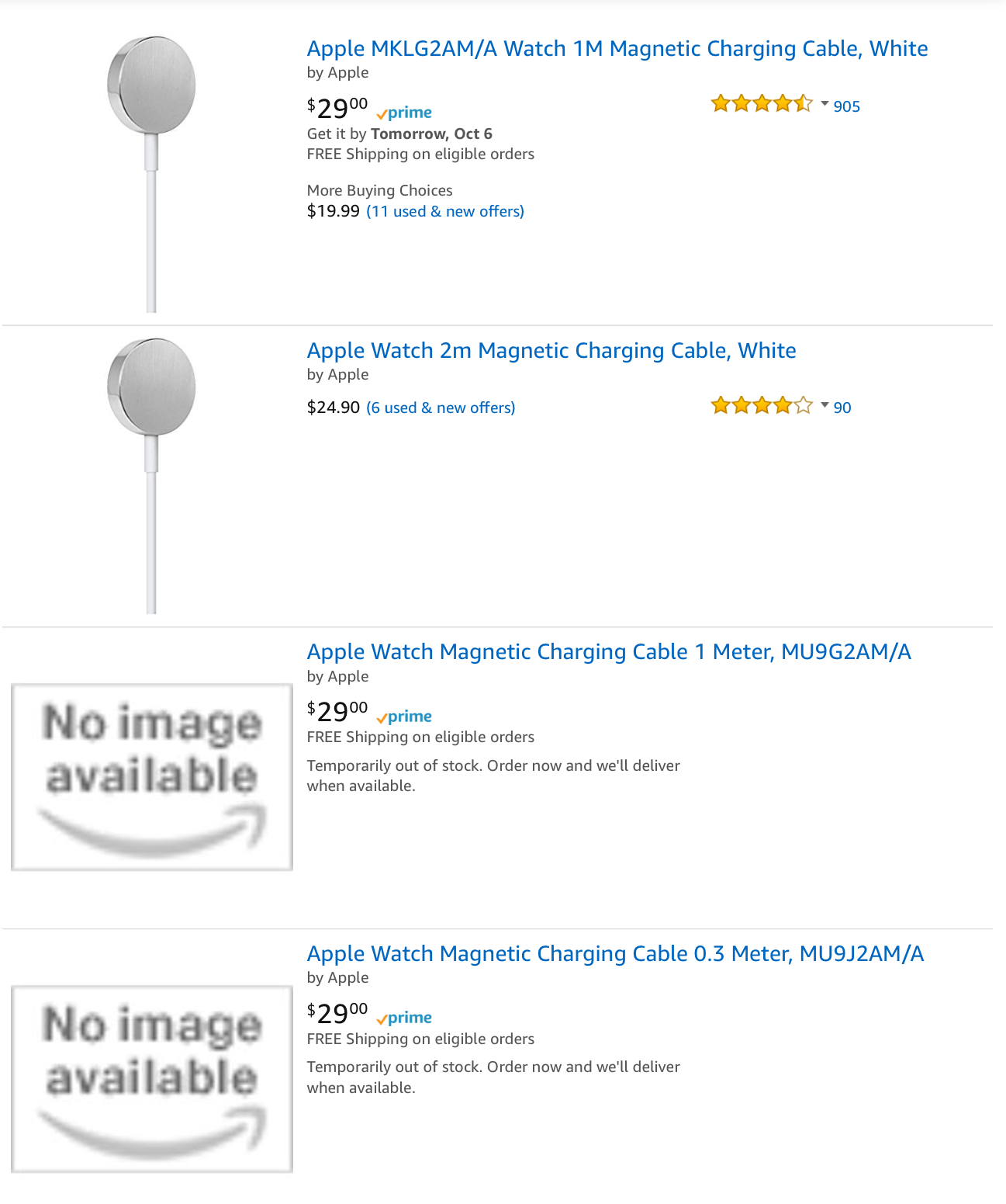

mklg2am/a - seems to be the old part number which is no longer listed on the Apple page
Mu9g2am/a is listed on the Apple page
