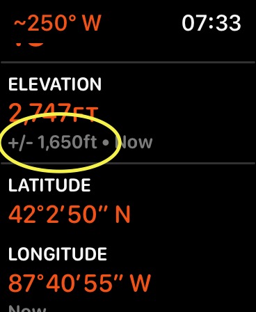

After I first took my Series 6 in a few flights with a maximum (pressurized) cabin of around 8000 feet, it started indicating around 2000 feet too high, with the error at +/-1650 feet. The only way to fix the problem temporarily was to unpair and re-pair the watch. Talked to Apple on the phone and chat, very frustrating as none of the reps seemed to understand how a barometric altimeter works.
I gave up on trying to figure it out. Fast forward a few weeks after several more flights, the altimeter is indicating a reasonable altitude with the error varying between +/-20 and +/-120 feet. Looks like it is 'learning', or calibrating itself.
Definitely room for improvement.

I’ve been flying a lot recently and after my last flight my Apple Watch is stuck at ~2450 ft when I’m maybe 50 ft above sea level. Previous to this the altimeter seemed very accurate.
I wonder if the altimeter has broken some how. It says it has an error of ~1500 ft. It’s been like this for a week, tried restarting the watch, ejecting water.
Yes! This is exactly what has happened to me. In late December, I flew from Northern California to Santa Fe, New Mexico- so, from about 150ft elevation, to around 6,500 ft. Out of curiosity to see what the airplane cabin was pressurized at, I opened my watch compass app. After I landed, my watch was forever stuck at least 1,500ft above my actual elevation. Device restart, restore from backup, and factory resets did not fix the issue. Next, after multiple calls with Apple care, they had me do some steps to try to “re-calibrate” the watch this involved setting the workout app to run, walk, or hike mode, and going for one of those activities for 30+ minutes, multiple tiles throughout the week. They said this should help the watch re- calibrate. It didn’t work. Finally they sent me a new watch. This weekend, I traveled to Santa Fe again. Once again, I repeated the same process on the airplane, wanting to see if I could replicate the issue on a new device. my watch is now off 2,500ft. Saying I am at 9,050ft, when in reality, I’m at about 6,500. It says I have an accuracy of +/- 530ft.
Not sure if this is a hardware issue or a software issue, but I’d sure love to be escalated to a senior engineer so we can get this figured out. I’m an avid hiker, and love tracking my altitude overall as well as altitude gained/ lost. This is a big issue for active outdoor use cases.
Has anyone had any luck resolving a similar issue?
