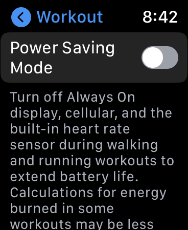

Have you tried the workout battery saver mode? It reduces or shuts off the heart rate monitor to preserve battery life.
Reactions: dotzero123
