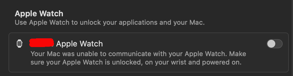

Yes, 13.3.1 fixed it for me too... until an hour ago.
Quite suddenly I no longer got "unlocking with apple watch". I turned the Settings switch off and when I tried to turn it back on I got a different (to the 13.3 issue) error message, namely “your mac was unable to communicate with the apple watch…”. I rebooted the MBP and the watch, and then was able to turn on the Settings switch for watch unlock - but now upon screen unlocking I get "unlocking with apple watch" for 5 seconds, then a spinning 'clock-dial-of-death' to the left of that message for another 10 seconds, then the unlock message changes to "touch ID or password" (entering the password doesn't change anything for future attempts BTW).
I've never seen this behaviour before.
The MBP, watch and iPhone are all within inches of each other, and all connected to (the same) WiFi.
I sent a problem feedback to Apple (the only one so far), but I'm curious if anyone else sees this issue occurring.

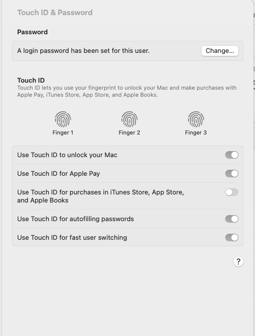

Go to System Settings - Touch ID & Password, then check that the option to unlock using your watch is enabled at the bottom of the preferences pane.
What am I missing here...apple watch isn't listed...
  • Wow
Reactions: jagooch
Can anyone share some insight on why Apple Watch options are no longer in my System Settings (Ventura v.13.4)?

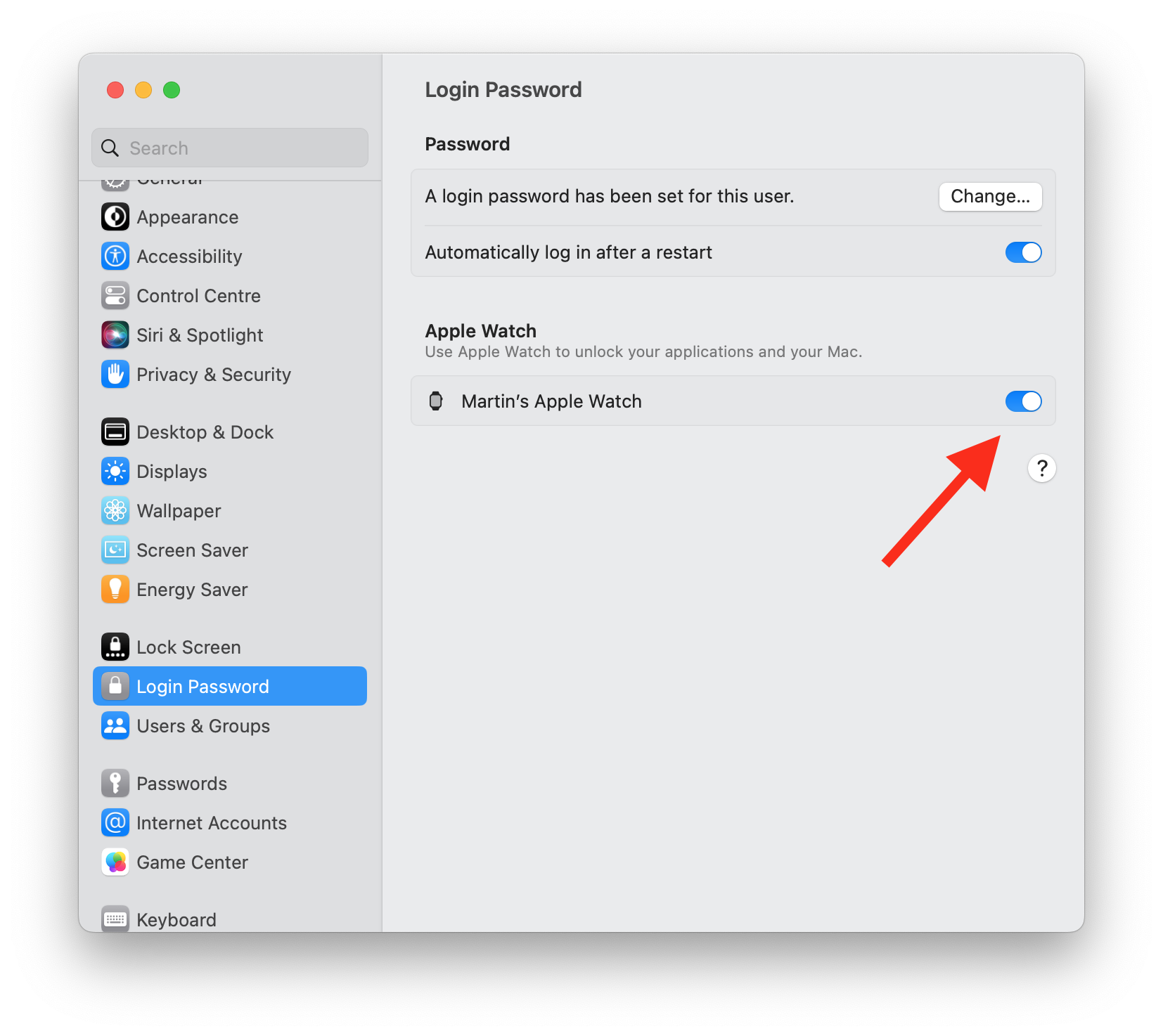

Are you guys absolutely sure that you're looking at the right spot in the new system settings?
Having no issues here on 2 Macs on 13.5.1...and I also saw almost no reports on AW Unlock at least since 13.5, so just asking...
The relevant setting should be located on the "Login Password" tab:
  • Haha
Reactions: gank41 and jagooch
