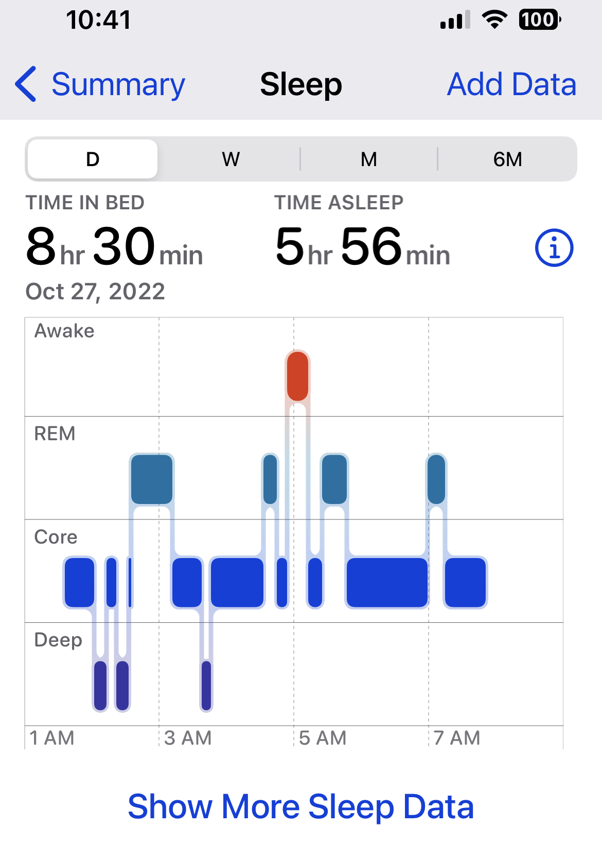

After a bit of ‘Googling’ and playing with settings I found out that “Time in Bed” is measured by using “Track time in bed with iPhone“ in Sleep setting’s schedule.
Set it last night and it measured correctly.
