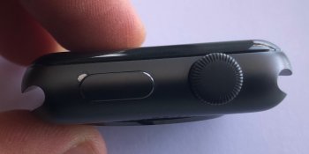

Any ideas on how to fix/paint this? I have few in mind but I am not sure if they are going to work.
Due to it being a factory anodisation process nothing you can do at home will probably create a seamless patch up sadly, though might be worth querying with Apple as it shouldn't really be doing that easily
I have sent it to the Apple authorised service provider and the provider sent it to Apple. Apple checked it and replied to them "Its physical damage - not eligible for free replacement". I asked the provider if they can repair it for me and they told me that there is no such a procedure and that there is no part that can be replaced. They only offered to replace the whole device for €300+.
I totally agree with you that it shouldn't be doing this. The dot you saw in the pic above is not the only one. There are 2 more defects, one dot and one line, in a spot that it's clear that this is not damaged by the customer but something went wrong during the painting procedure in the factory (check pic bellow). But what can I do? They do not accept my facts.
I know that the result wont be perfect, but I am willing to paint it, I want this white dot to go away, it looks very bad.
I want to try to cover it with some black nail polish, what do you think?
I think it would look far less noticeable, but probably not the perfect shade of gray. If I were in your shoes, I’d give it a try since you really have nothing to lose (as long as you are completely beyond your warranty).
I think that instead of an ugly shiny aluminium spot, you'll have an ugly blob of nail polish on your watch. Also, since the ding is so close to the side button you risk messing up during the application; you might glue your side button permanently stuck, especially if you ever try to remove your improvised repair; acetone will dissolve the nail polish, which will then wick in between the side button and case, right up to the button seals where it can then re-set (and possibly also dissolve the seal as well making it gum up that button real good.)
So I would be super duper extra careful if I were you. Is it really worth it? Maybe just live with the damage. See it as a 'beauty spot' for the duration you have that watch...
I think that instead of an ugly shiny aluminium spot, you'll have an ugly blob of nail polish on your watch. Also, since the ding is so close to the side button you risk messing up during the application; you might glue your side button permanently stuck, especially if you ever try to remove your improvised repair; acetone will dissolve the nail polish, which will then wick in between the side button and case, right up to the button seals where it can then re-set (and possibly also dissolve the seal as well making it gum up that button real good.)..
I think you’re over exaggerating and making this more difficult than it needs to be. A simple swipe of a little bit of paint or nail polish is not as drastic your making it sound. Also for the record, by _not_ touching up that area, the anodized aluminum will continue to chip if it comes in contact with anything else, would likely worsen. I certainly would touch it up with a minimal amount of paint/polish as possible, because once the 7000 series aluminum is Chipped, it’s known to spread. Plenty of threads on this topic.
You are both right, if I **** it up with the nail polish I may damage the side button. On the other hand Relentless Power is also right, if I don't cover it it will continue to spread.
I have to paint it starting from the opposite side of the button and slowly-slowly get close to it. Now how I am going to do this without gluing the side button, I really don't know. It's risky.
What about permanent marker instead of nail polish or automotive paint?

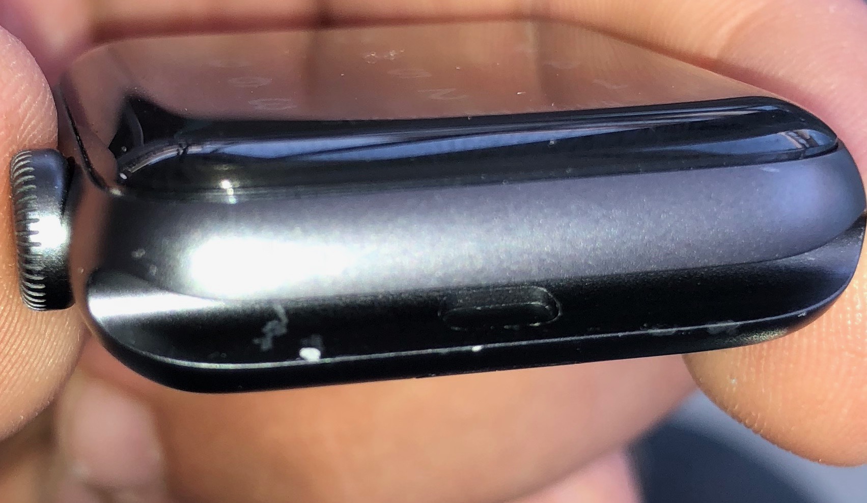

Anyone know where I can get matching paint to touch up a S1 Silver Aluminium Watch it has a slight scuff on it near the display I’ve ordered a body case for it but it may take ages to arrive China :|
Perhaps take it to an automotive shop and ask them to colour match it?
Reactions: Kerry78
I know you are asking about the Silver Aluminum and KarimLeVallois answer is probably as good a bet as any.
But something worth trying on the Space Gray models is Birchwood-Casey Aluma Black. Despite "Black" in the name, it actually takes a few applications to achieve black. First applications will achieve shades of gray. When I used it to blacken scratches in anodized black aluminum motorcycle panniers, it took me 4 or 5 applications to match the black.
That said, being a rather thin liquid, you would also have to use an abundance of caution to watch where it goes. A problem I didn't have to deal with. But with a watch, especially depending on where the scratches are, you would have to watch excess liquid.
The advantage of Aluma Bllack over paint is that it is a chemical that, when in contact with aluminum (not oxidized aluminum) will cause a chemical reaction that turns the surface of the aluminum black. So it is more permanent.
But I have never tried it on an Apple Watch, so I can't speak for the results. Use at your own risk 🙂

This is an old post now but as I was still searching for ideas on this, I am sure others will be too and maybe the following might help. I damaged the corner of my Space Gray iPad Pro and would really like to make it less obvious. The damage is not so bad but it has smooshed the corner a little and grazed the finish and the underlying aluminum, so it will need to be sanded down and refinished, and that will expose the silver aluminum under the original dark anodized finish of course.
I bought a bottle of the Birchwood-Casey Aluma Black (nasty stuff, so be careful) and did a test of a sheet of aluminum, first preparing it with 3000 grit paper, then polishing with Mother's Mag and Aluminum Polish, then wiping the surface clean with a wet tissue. Others have suggested rubbing alcohol at this stage and that may also work or work better. It is important to get the new polished surface really clean, as the Birchwood-Casey Aluma Black will react with surface debris (I could clearly see this adjacent to my clean test area, where the compound had reacted with small traces of the polishing paste and fine aluminum powder, bubbling and changing color to a brown color).
Preparation is everything of course and I was surprised at how much material 3000 grit paper will remove. During the sanding and polishing, the surface will turn quite dark with the aluminum that is being removed, and you will need to keep working it with a clean cloth or tissue to get back to a clean aluminum finish. I'm lucky because the area to be repaired is quite small. I would NOT try this on a large flat area on the rear of an iPad or iPhone. It will always be best for small touch-up repairs on corners etc.
After sanding, cleaning and polishing, I applied one coat of the Birchwood-Casey Aluma Black. The solution is very thin and doesn't adhere naturally to the aluminum (it beads and runs off) but the color after one application was indeed gray and not black and looked like a good match for Space Gray. It probably won't end up 100% the same but I feel like it will be really close.
I looked into other option such as expensive anodizing touch-up pens but am still left feeling this will be the best.
Your mileage my vary of course and any use of this information is entirely at your risk and responsibility (the Birchwood-Casey Aluma Black is corrosive and toxic).
