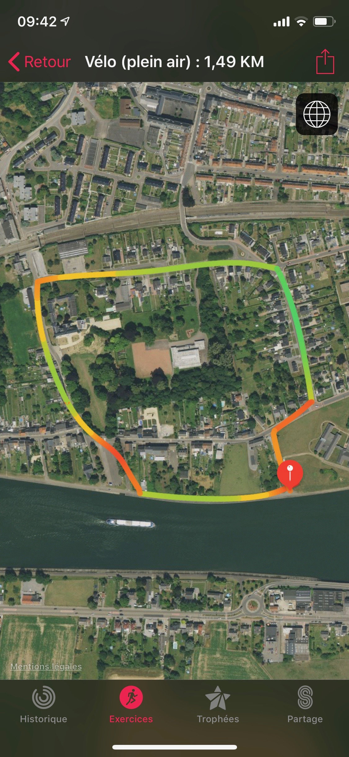

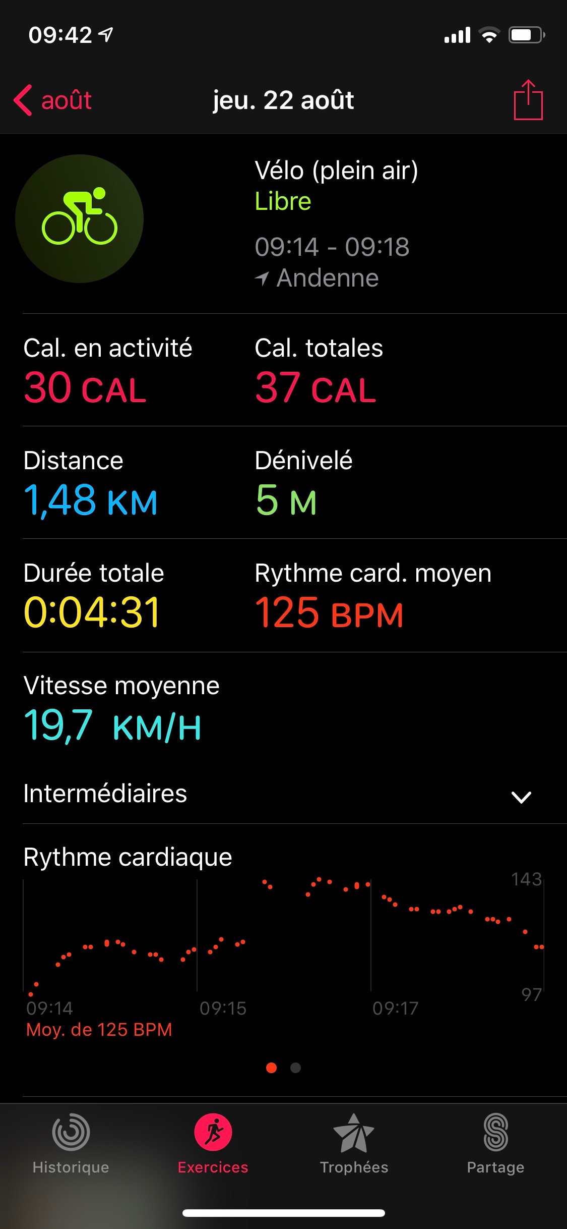

this is trying this morning in photos
1: Bluetooth iPhone X disabled, Apple Watch 4 not connected.
2: iPhone airplane mode, Apple watch 4 not connected to the iPhone
3: Apple watch 4 airplane mode, not connected to the iPhone.
Conclusion in the three tries the altitude difference is the same, some difference in distance, but minimal, so not serious
