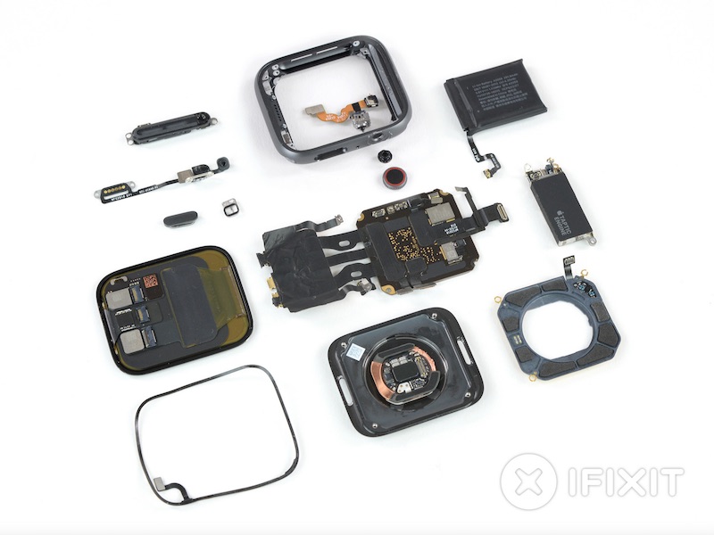

iFixit has completed a teardown of the Apple Watch Series 4, providing a look inside a larger 44mm model with LTE.
Image Credit: iFixit
The repair experts believe that while the original Apple Watch was awkwardly layered together and used too much glue, the Series 4 lineup feels "much more thoughtfully laid out," likening it to the iPhone 5.

At first glance, the internal design of Series 4 models looks more or less the same as previous models, with the battery and Taptic Engine taking up most of the space. Dig deeper, however, and the changes become evident.
Teardown highlights:1.12Wh battery in the 44mm model, which is 20% less capacity than the 1.34Wh battery in 42mm-sized Apple Watch Series 3 models.
A thinner and longer Taptic Engine, but iFixit says it still takes up a lot of space that could have gone to a larger battery.
The barometric sensor may have been relocated to the speaker grille for access to the outside atmosphere. The sensor had its own dedicated hole beside the microphone on Apple Watch Series 3 models.

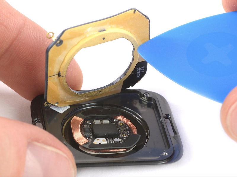

The new Apple S4 chip is secured only with screws, whereas the processor is also "fiercely glued" in previous Apple Watch models.
The golden ring is likely a streamlined antenna system, as iFixit says it has not seen the usual fiddly brackets or golden gaskets.
The entire rear casing pops off more easily.
The display is not only larger, but also thinner.iFixit says the Apple Watch Series 4 is nearing iPhone levels of repairability, with the highly-glued display being the primary remaining obstacle. Beyond that, they say the battery is straightforward to replace.
All in all, the Series 4 received a "solid" 6/10 on iFixit's repairability scale, with 10 being the best possible score. That's the same repairability score iFixit gave the iPhone XS and XS Max in its teardown of those devices.
