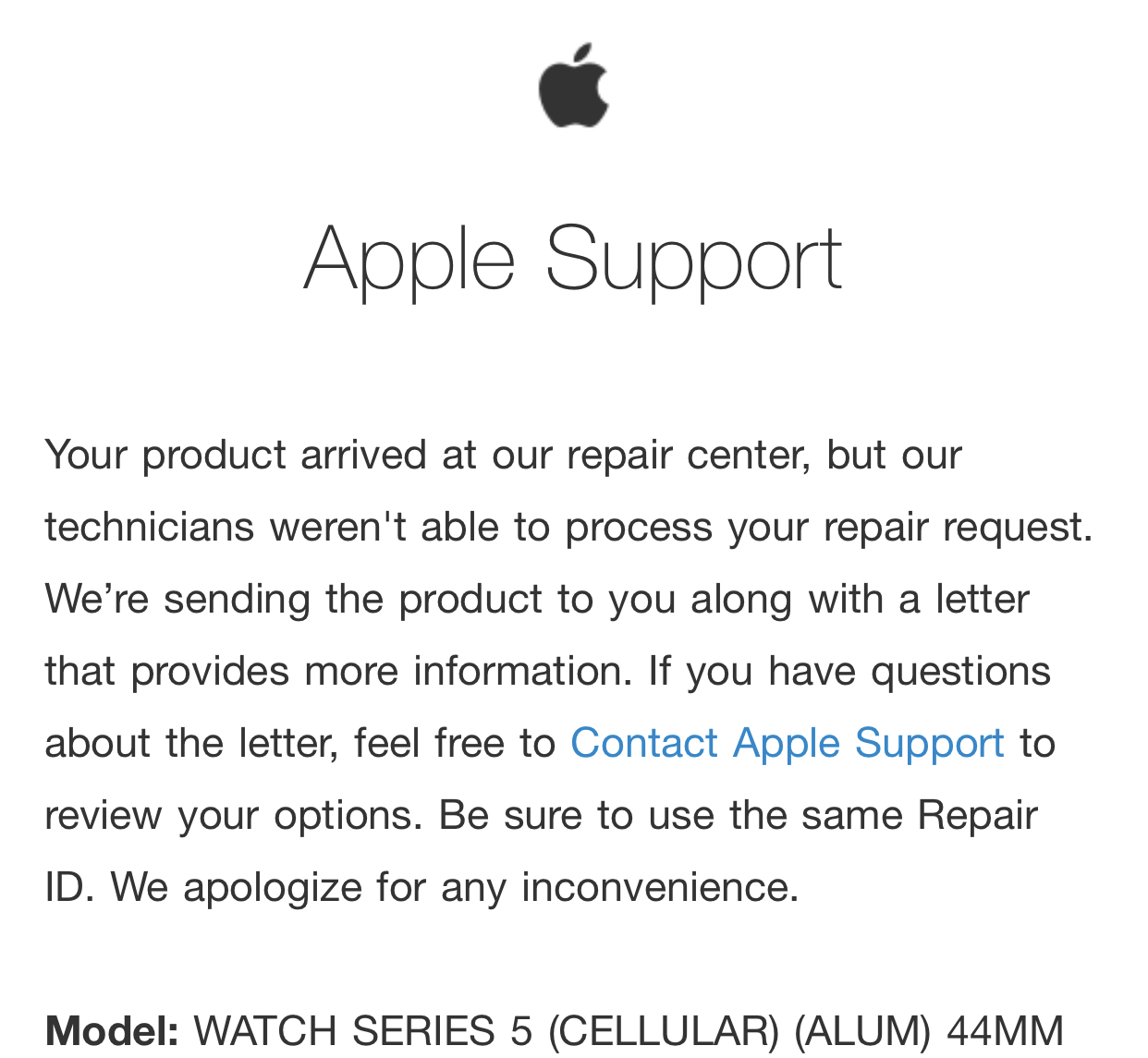

Things are looking good so far, fellas. I’m ready to take back what I said.
It may have seem like the GymKit was the actual cause for my battery drain. My Apple Watch is at 60% by 9:30 PM, which I put on my watch at 9:00 AM.
However I did take off my Apple Watch for 2 hours, so that might’ve slowed it down. But I’ll try again tomorrow.
Sigh.

I assume so? I never specifically disabled it, but I never use it either. I’ll try turning it off when I get the watch back tomorrow.
