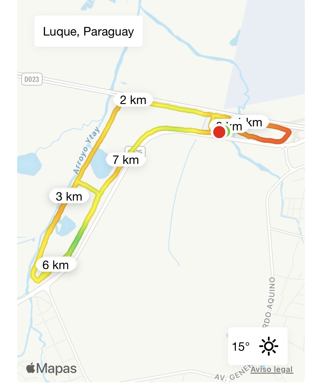

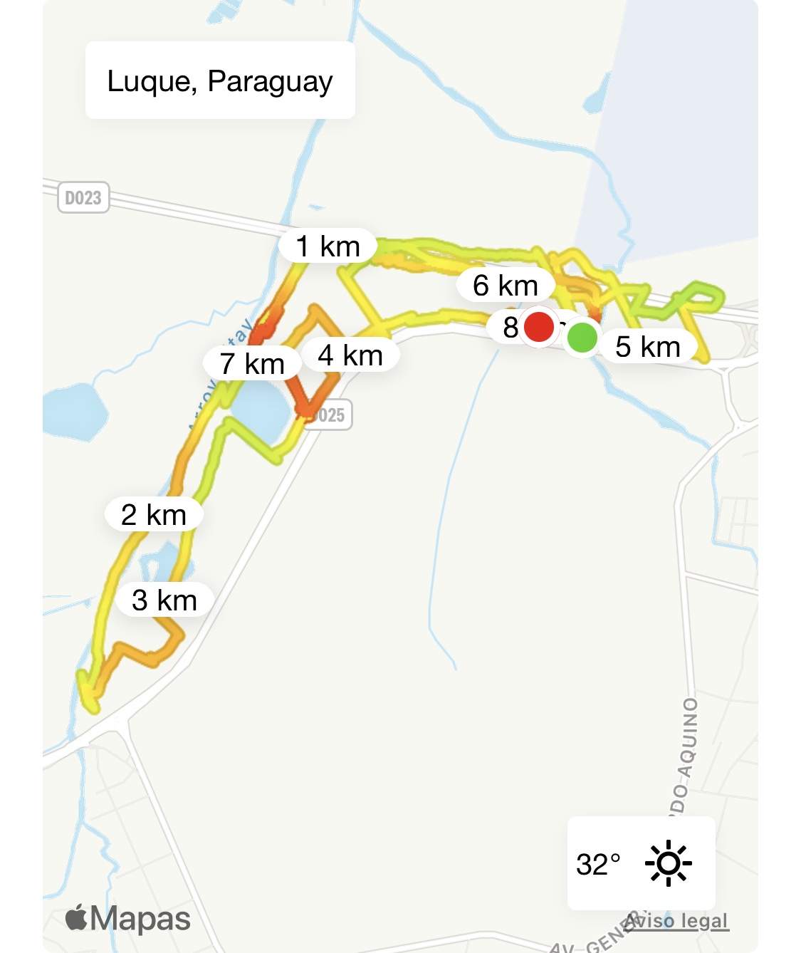

I just switched from an Apple Watch Series 4 to a Series 7. I use my Apple Watch mostly for running. The main reason for switching was that the series 7 is supposed to have a better GPS accuracy, and also the always active display, witch is useful when running and checking the Watch. Today I did my first run, I use NRC (Nike Run Club) app, and I got HORRIBLE GPS readings. Not accurate at all. Let me share two pics, a previous run using my Series 4, and todays run using the Series 7. Just compare how horrible the Series 7 was. Is there something to be done? Is there a way to calibrate. The park where I run is an open space, and today was mostly sunny with scattered clouds.

View attachment 1921808View attachment 1921809
Did you have your phone with you on the run. If you did then the watch was using your phones GPS unless your phone was switched off or in aeroplane mode.

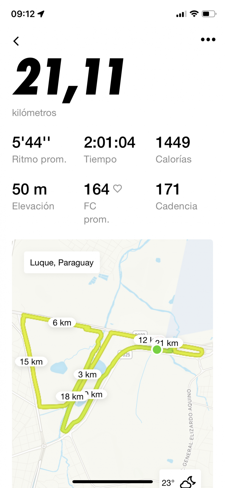

UPDATE. Today I went out running, I did a half marathon, 21.1Km. I did bring my iPhone with me, but I turned Bluetooth off, so that the AW didn't connect to the iPhone. The GPS readings were great. So, I guess the problem is the iPhone X GPS.

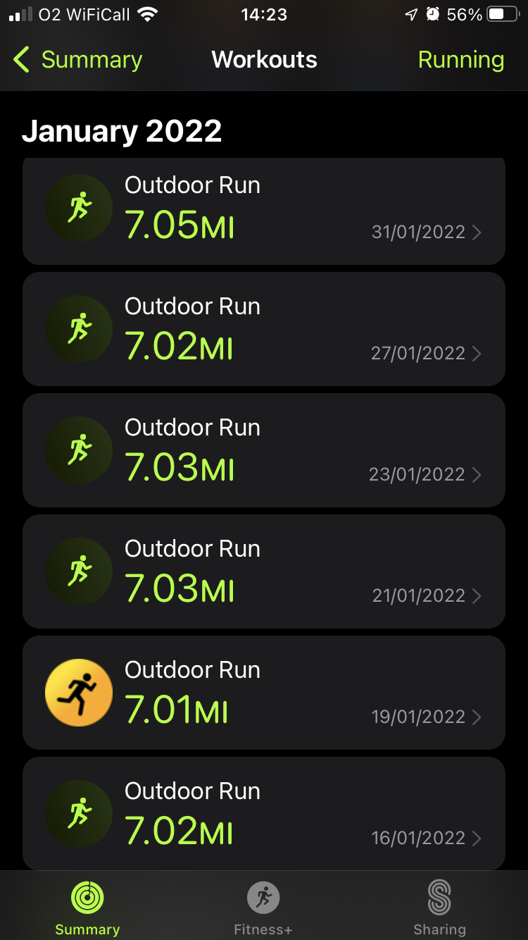

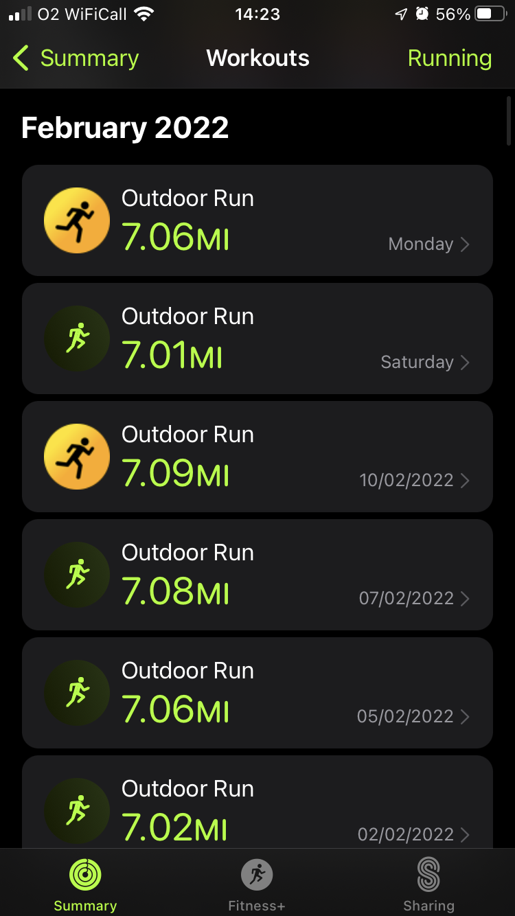

I find my 5 pretty consistent, I have been testing running the same route, start/finish at the same points.
I was interested to know the difference the added accelerometer data made so I use the workout app with it on and WorkOutDoors with it off. The distances last week were a bit more (on both apps) I put this down to the thick cloud and rain here in the UK at the time. In normal condition though, my 4mile indicator goes of within a couple of feet, very impressive.
