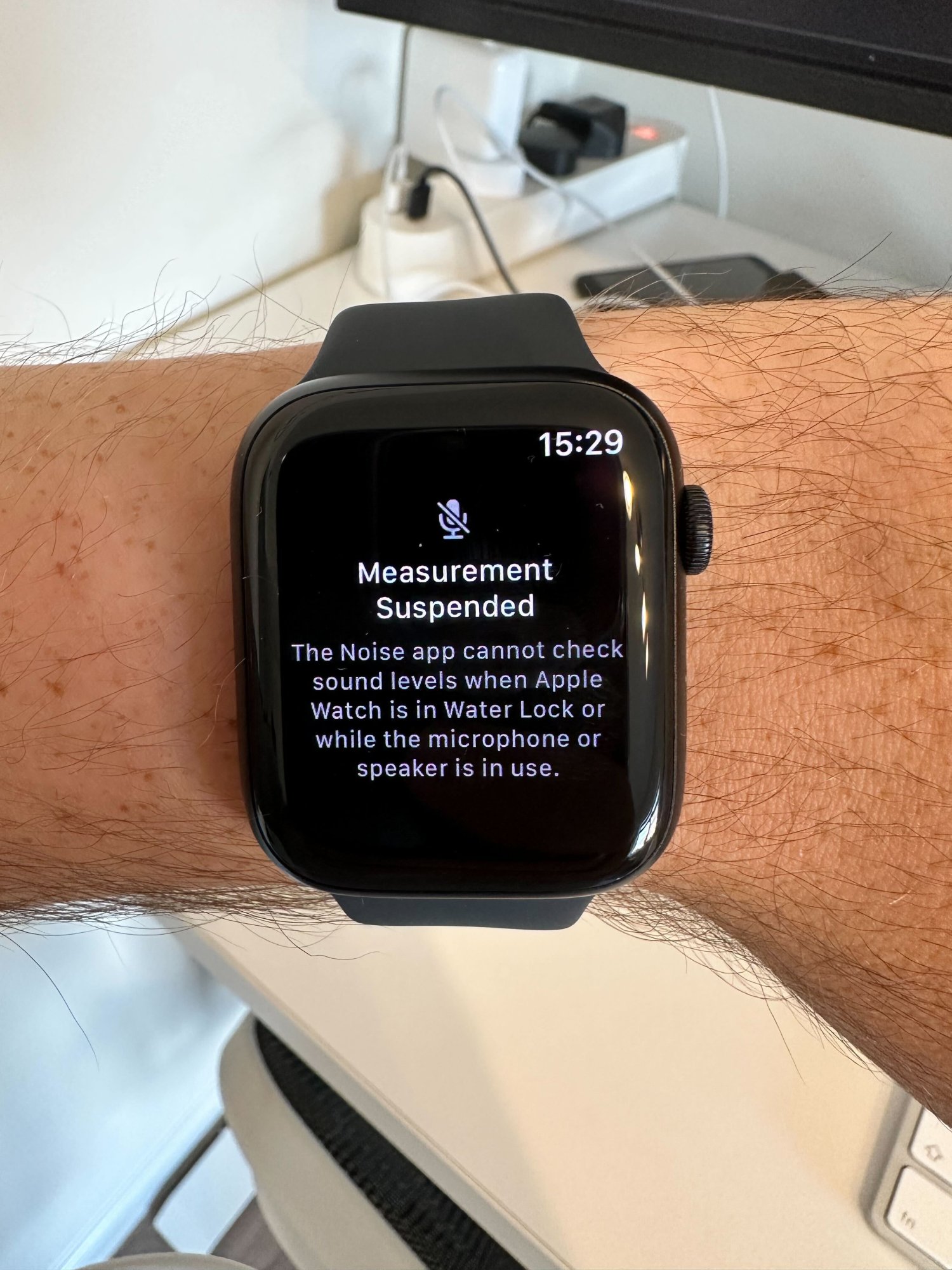

My partner and I have both received and setup our Series 8's today. However the noise app (and also Siri & dictation) both pop up with a "Measurement Suspended" (see attached) message. It's as if the mic is being used by another app, we've closed all apps on the watches, rebooted them, updated them to the latest Watch OS (iPhone 14's also both updated to 16.0.1) but no success.
Our previous watches (Series 4's) worked fine without issue.
Any suggestions on what to try next please? Thanks!!

From what I have seen the net, this looks like a hardware issue, and a return will need to be instigated.

Mmm I found that after a Google, was hoping it may have been something else. So odd that both of our watches are doing it! :/
