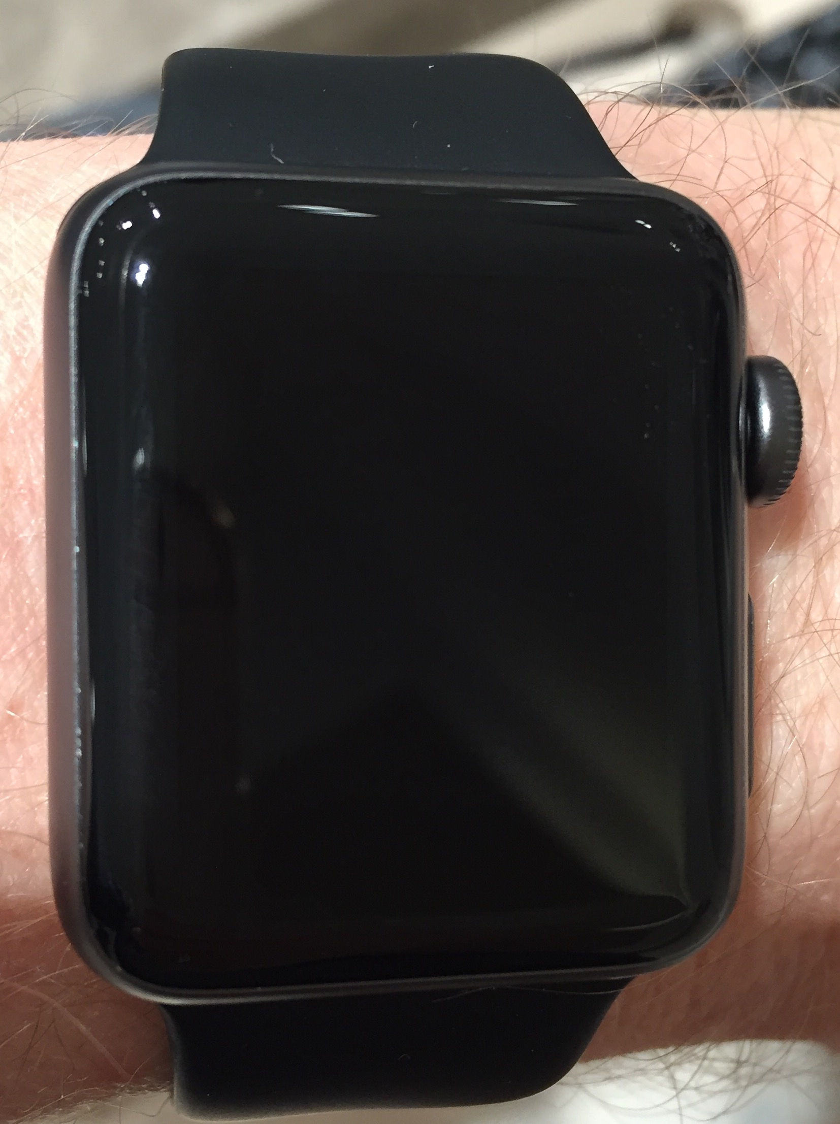

For the people who think it's impossible for aluminum at the edge of the glass to chip without damaging anything else, here's my watch. It JUST HAPPENED. This watch has been babied since the day I got it. I've only worn it 20 times. Not a single scratch on the glass or the surface. But the paint just chips at that edge. Bad anodizing done by apple.
I think you're referring to my comment and actually I agree with you - I just phrased my comment poorly. What I mean is that the chips that are confined to the small lip around the glass are impossible to cause by smacking the watch against something. It'd be impossible to smack your watch and only damage that tiny lip. In other words, something else is causing the poor finish around the edge of the glass to come off - poor anodization or whatever else it could be.

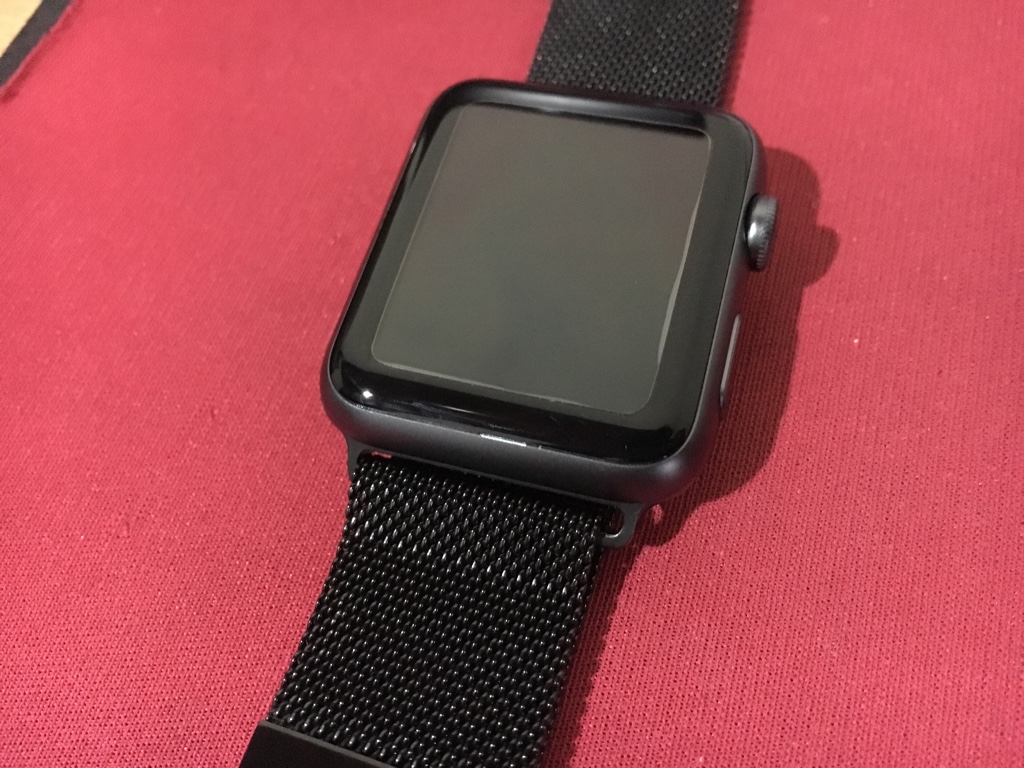

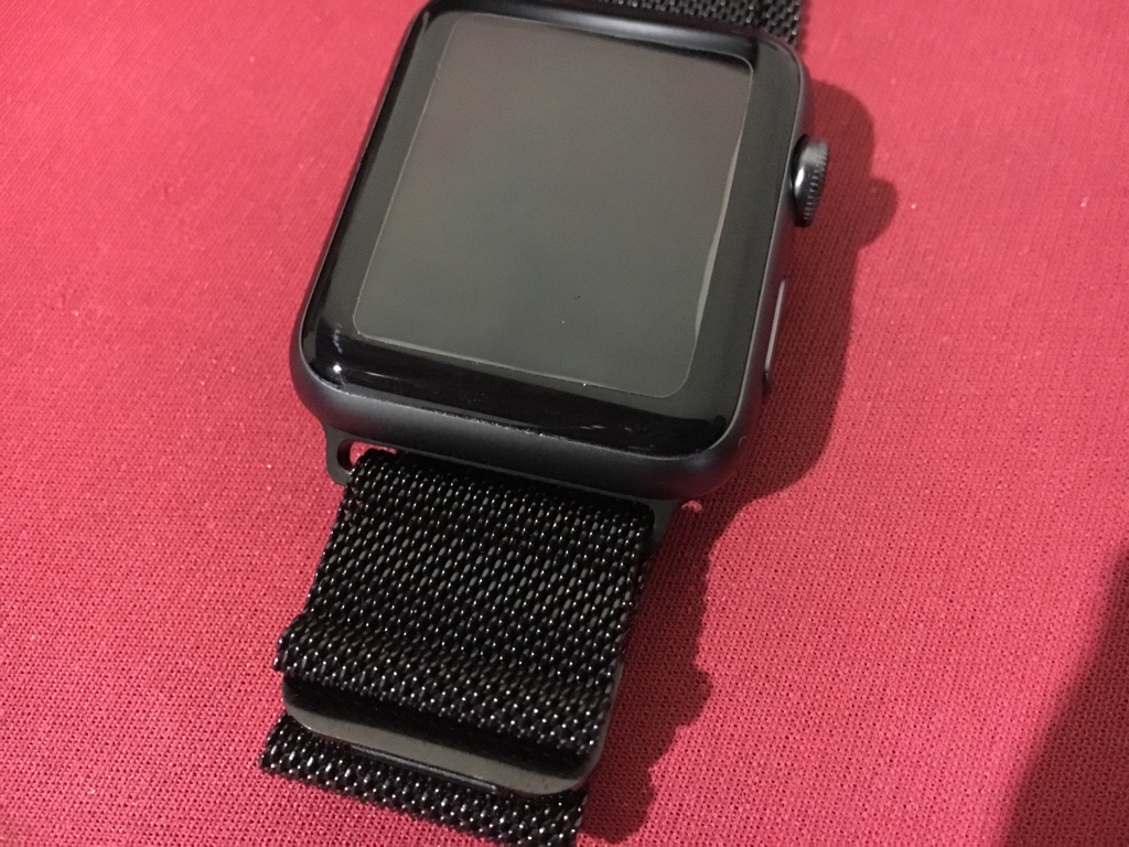

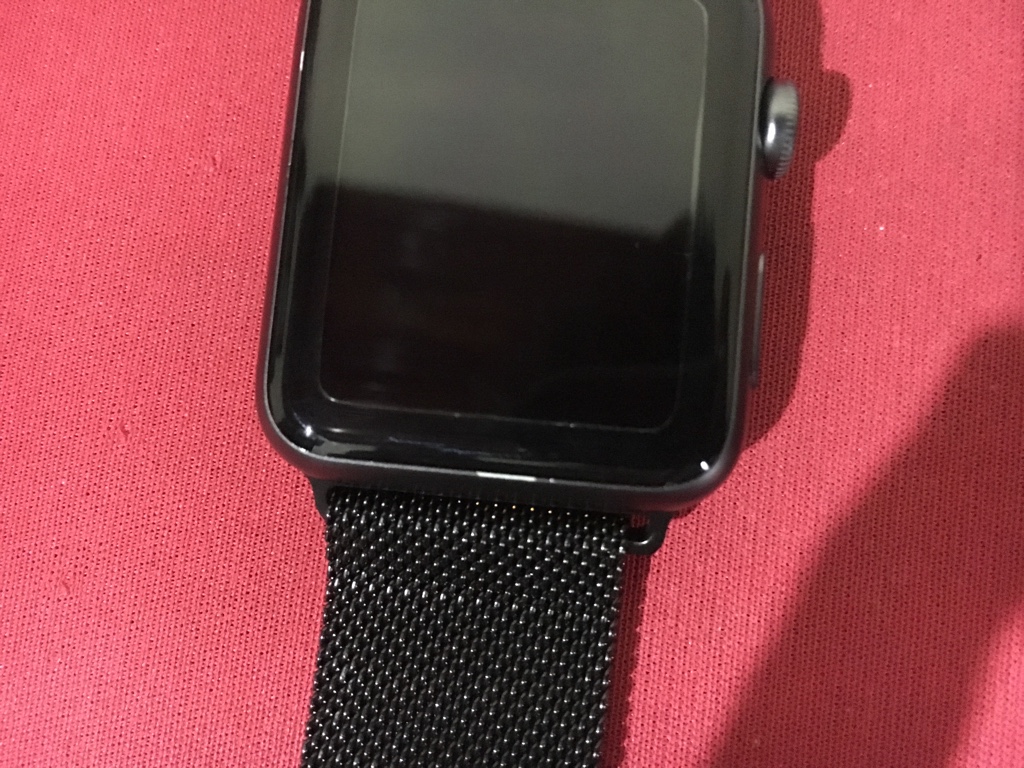

Exactly! That line is so hard to get. However, I have successfully touched it up with some gunmetal paint I got for my car's wheels lol. Here are some before and after pics. It looks alright.
In my case, my original Apple Watch did not have any paint issue, however, all replacements which I had have the same paint problems. The last time Apple replaced my Watch to retail one (Serial number does not start with letter "N") I did not have any issues.
