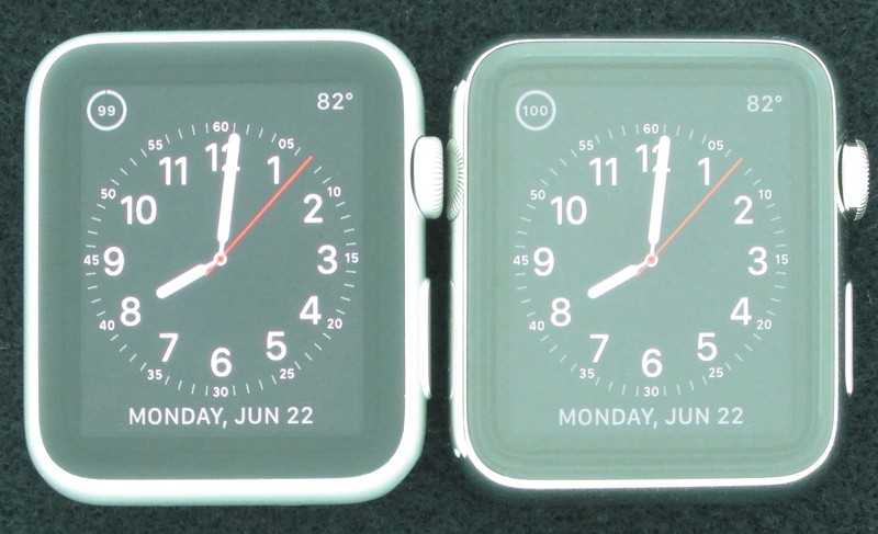

Photo comparing Ion-X glass (left) and sapphire crystal (right) taken at 2,000 lux, which equates to moderate outdoor lighting
For the Apple Watch Sport with Ion-X Glass we measured the Screen Reflectance to be 4.7 percent, while for the Apple Watch with Sapphire we measured 8.2 percent Screen Reflectance, which is 74 percent higher than with Glass. Both values are about 0.6 percent higher than just pure sapphire and glass alone, indicating that Apple has done an excellent job in optically bonding both the glass and sapphire to the OLED display without an air gap.
The 74 percent higher Reflectance of the Apple Watch with Sapphire means that its screen will reflect almost twice as much surrounding ambient light as the Apple Watch Sport with Glass. And it takes surprisingly little ambient light for that to make a significant visible difference...

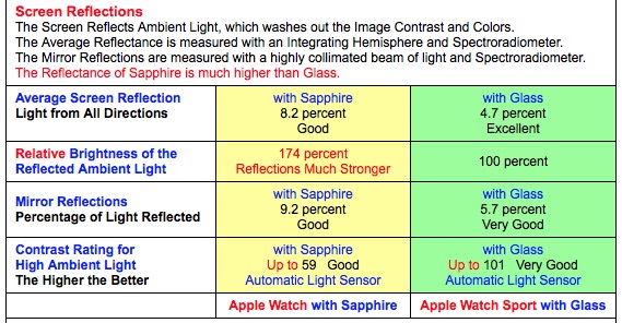

Starting in the dark at 0 lux, DisplayMate increased light levels in successive stages of testing to discover the contrast ratios of each screen under increasingly stressful lighting situations. With both displays set to their maximum brightness, at 500 lux ("mid-range indoor ambient lighting") the display contrast ratios had fallen from 100 to 64 for Ion-X and 38 for sapphire, illustrating the distinct visibility advantage for the cheaper model. Jumping to 2,000 lux ("moderate outdoor lighting in the shade or an overcast sky"), the ratios drop to 17 and 10 for Ion-X glass and sapphire, respectively.
Chart comparing various aspects of reflectivity between the two displays
For a full-on sunlight measurement of 10,000 lux, the Ion-X glass display contrast ratio fell to 3 while the Sapphire Crystal came in at just 2. So, while the Sport's display proves to handle moderate outdoor sunlight much better than the sapphire display, both are significantly impacted by harsh, direct sunlight.
