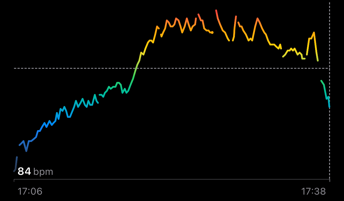

Hello everyone,

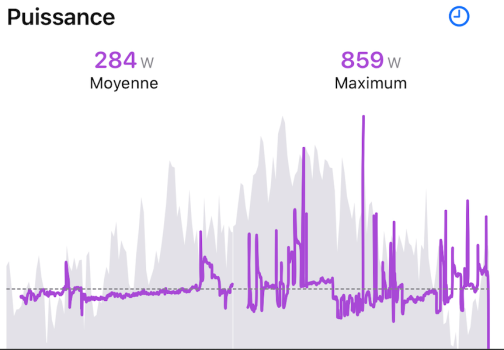

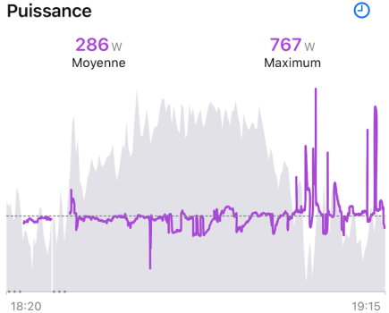

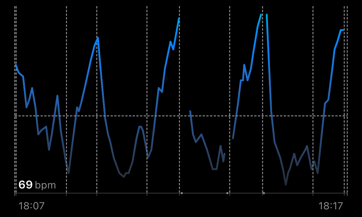

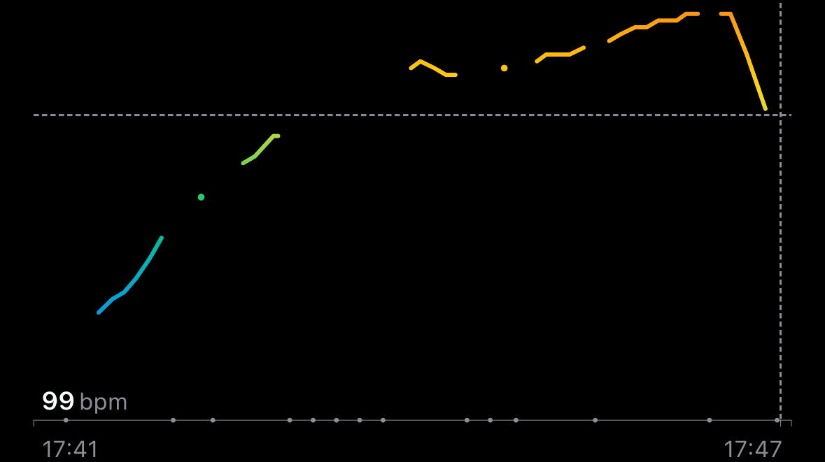

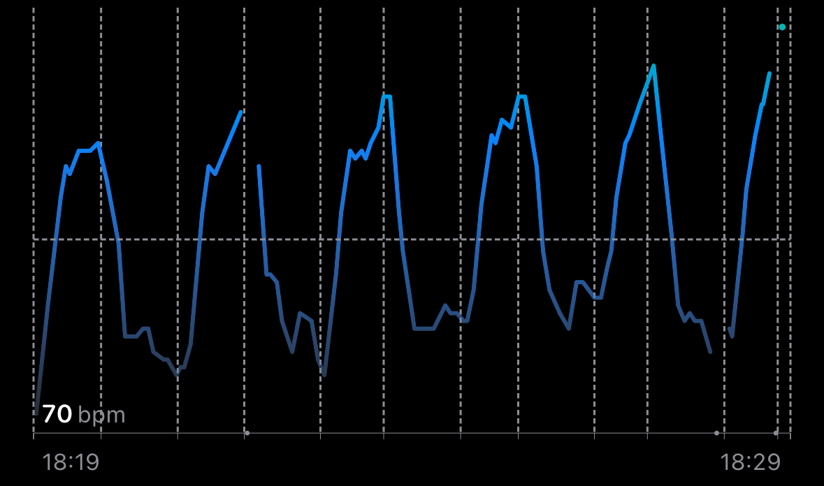

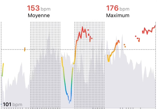

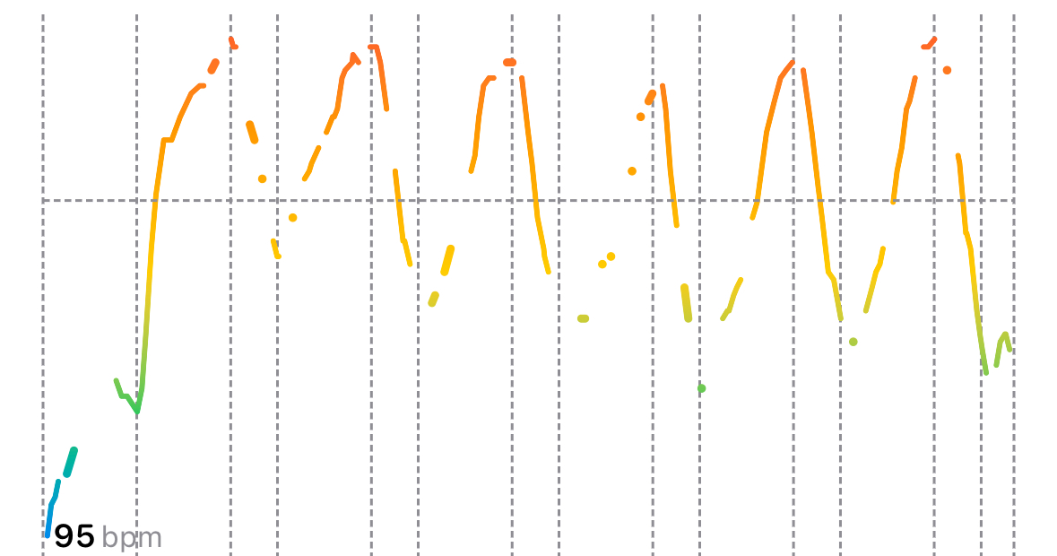

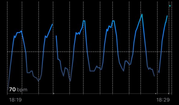

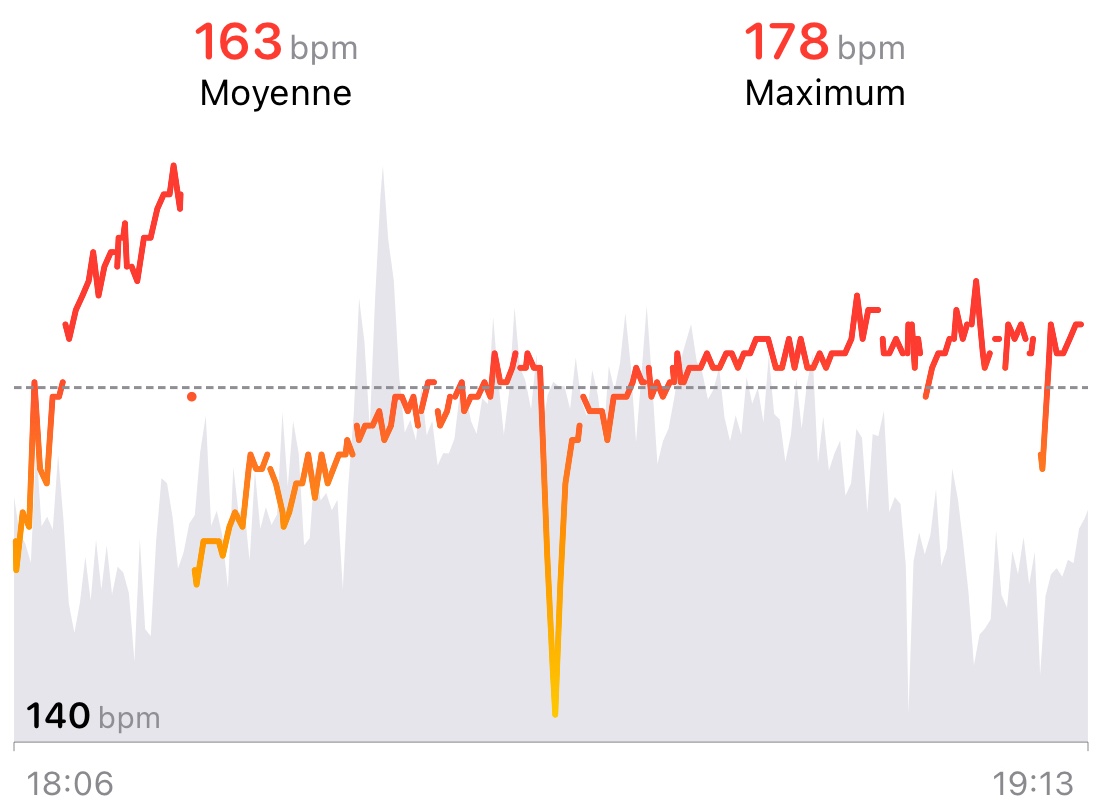

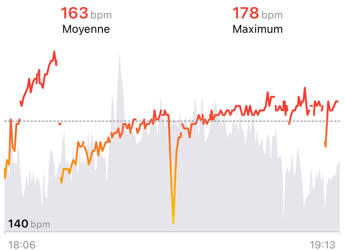

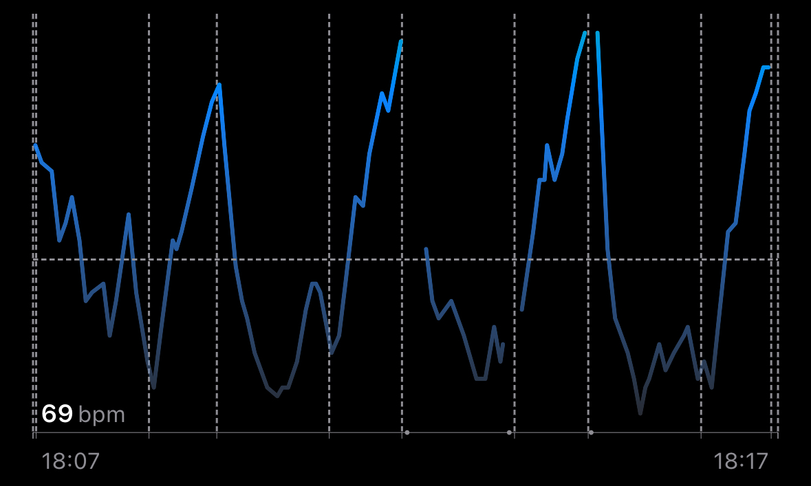

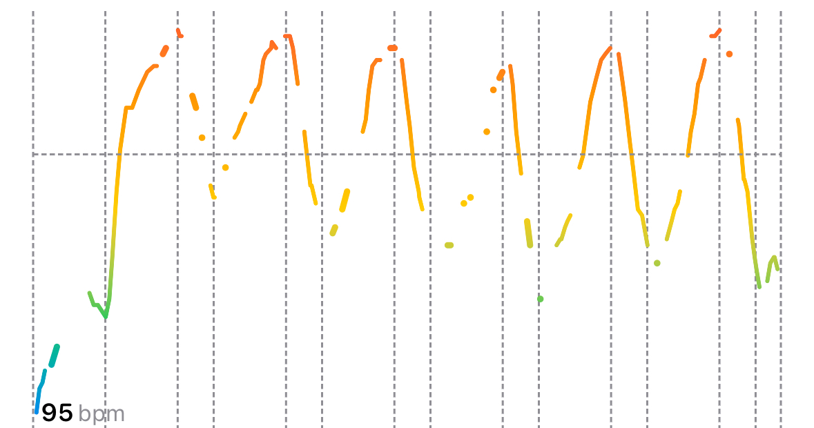

I'm having issues with my Apple Watch Ultra 2, mainly losing heart rate data during exercises.

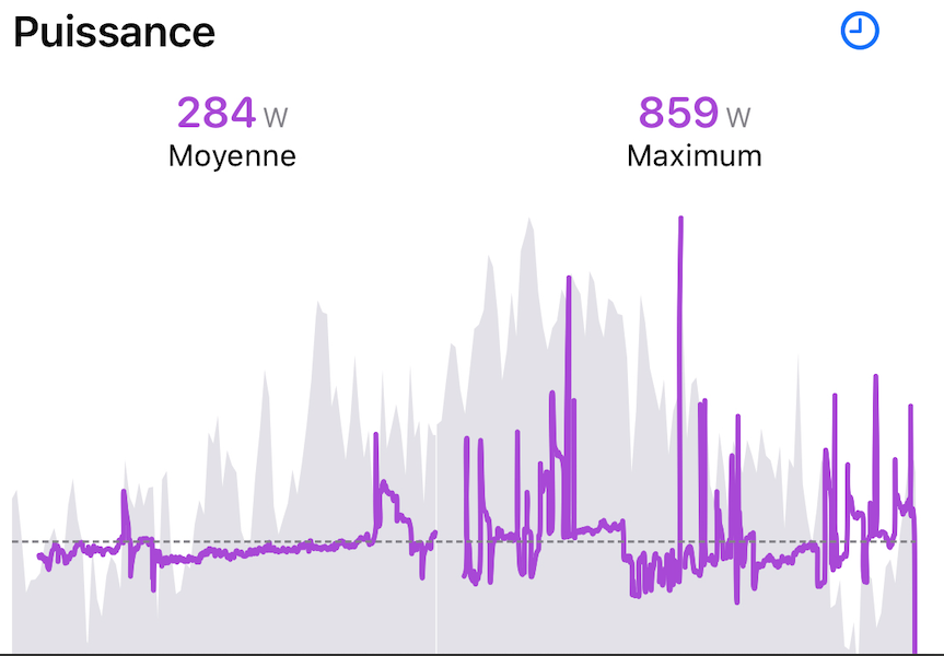

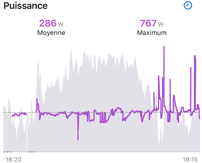

Sometimes I lose pace and power data, but much less often.
These data losses are very variable, from the beginning, middle or end of exercise, over durations ranging from a few seconds to several minutes.

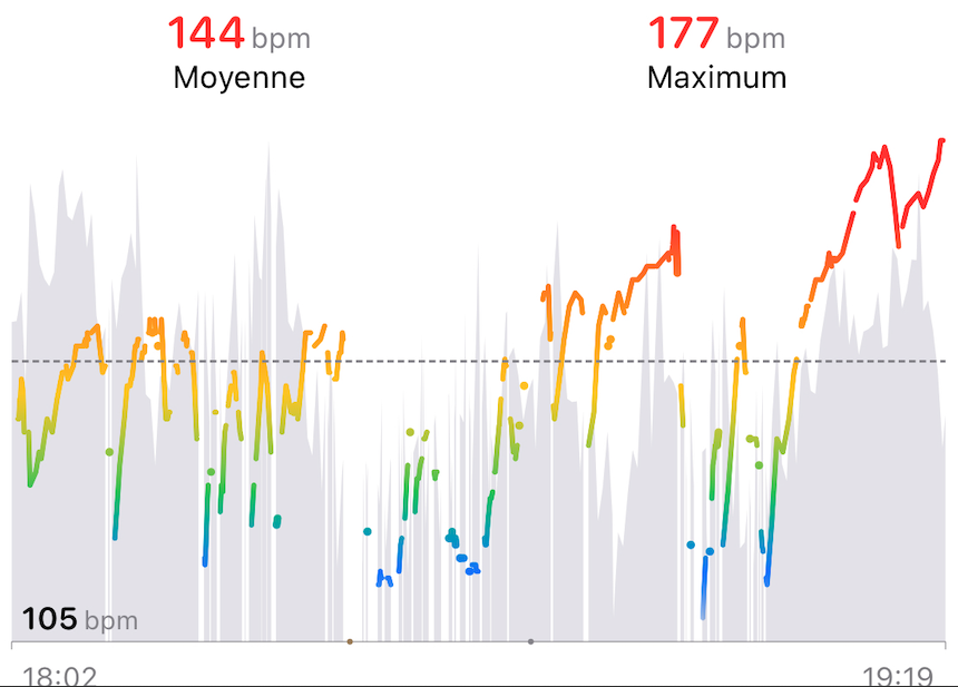

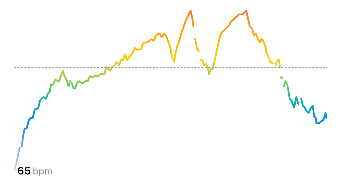

I also get erroneous curves (e.g. Run2) where the heart rate rises sharply at the start of exercise, then falls back to something much more normal.
I'm attaching screenshots of the curves I get after a workout, curves obtained with Healtfit, to explain what I mean.
I'd also like to point out that on races, heart rate readings are good, but this is still too rare.
I've tried everything, loosening and tightening the strap I wear far from the wrist bone.
The watch is always clean.
Unlocked, reset as new watch.
I contacted AppleCare, who found nothing after diagnosing the watch.
I went to the Apple Store, to have a Genius check the data loss, who discovered that he too had this kind of missing data with his Apple Watch Ultra 2.
The latest solution proposed by Apple is to send the watch back to be checked.
Unfortunately, parting with the watch is problematic given that I'm in the middle of my training, I need it for my workouts and splits etc. I'm a bit lost and at a loss.
I'm at a loss, so I've come to ask you if you've come across this kind of bug, which annoys me greatly, given the price of the device, the on-board components and what it's designed for.
I hope to hear from the community, thank you in advance.

Merci for your feedback @renaultf1.

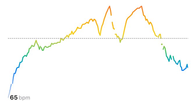

It happens whatever the weather, hot or cold.

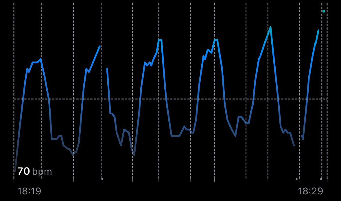

It even happens when I workout indoors (picture 6/7 is an indoor rowing exercise).
I'd buy a heart rate monitor if I wanted to get more accurate readings, not to solve a problem of poor readings from the watch, the AWU2 should be almost infallible on heart rate capture.

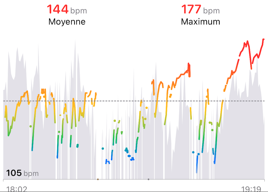

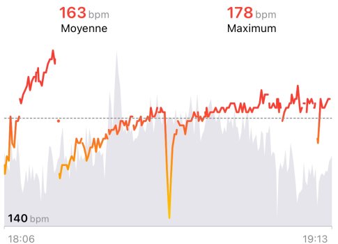

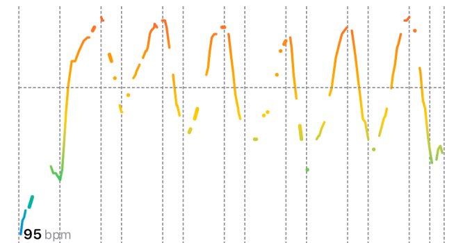

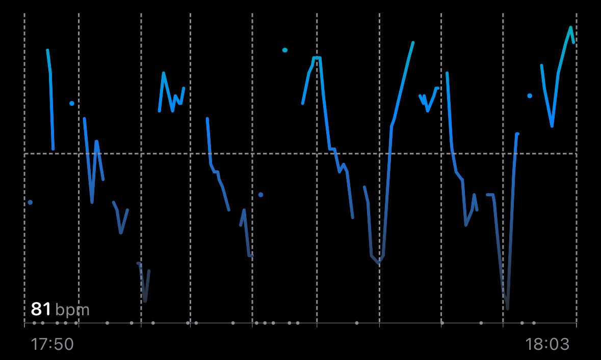

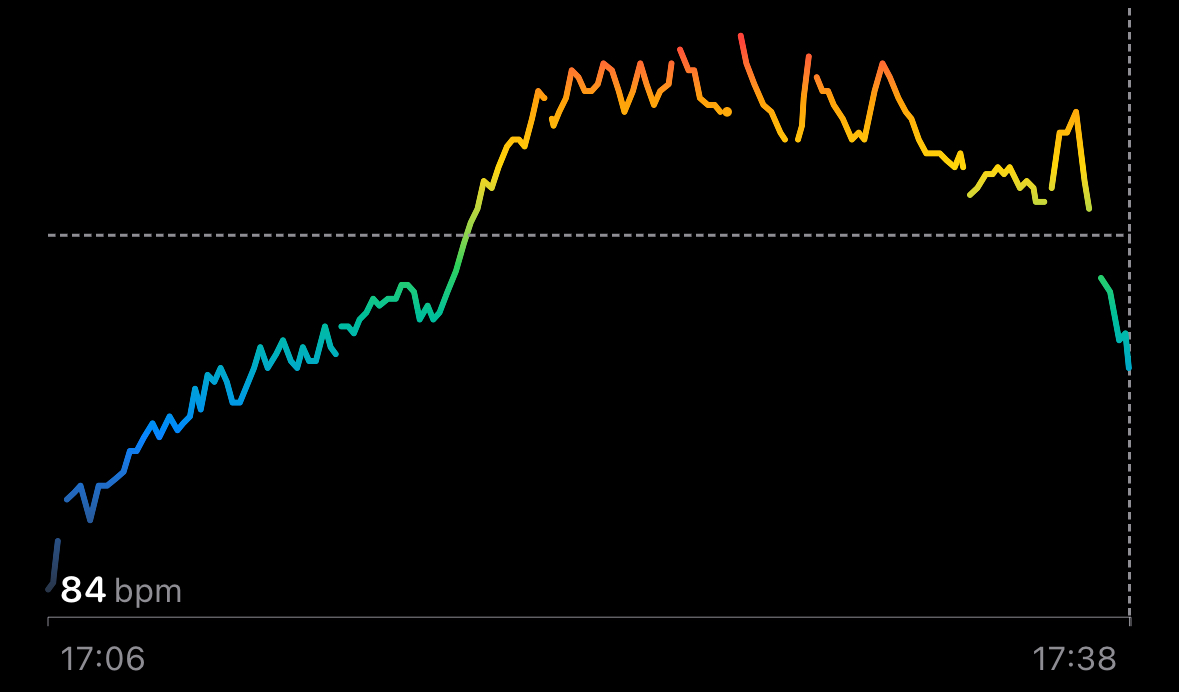

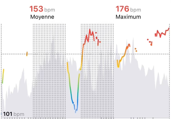

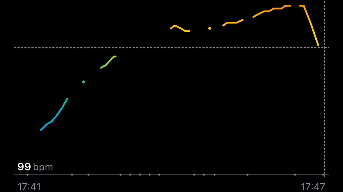

I train almost every day and very rarely have a session without data loss.
Today I went to the gym, here are a few screenshots, in order of the session.
First screenshot, elliptical trainer, followed by rowing machine, then a screenshot of an abs, pecs and back workout.
The conditions under which the watch was worn were exactly the same for each exercise.
It's really not what I expected when I bought this watch.😞

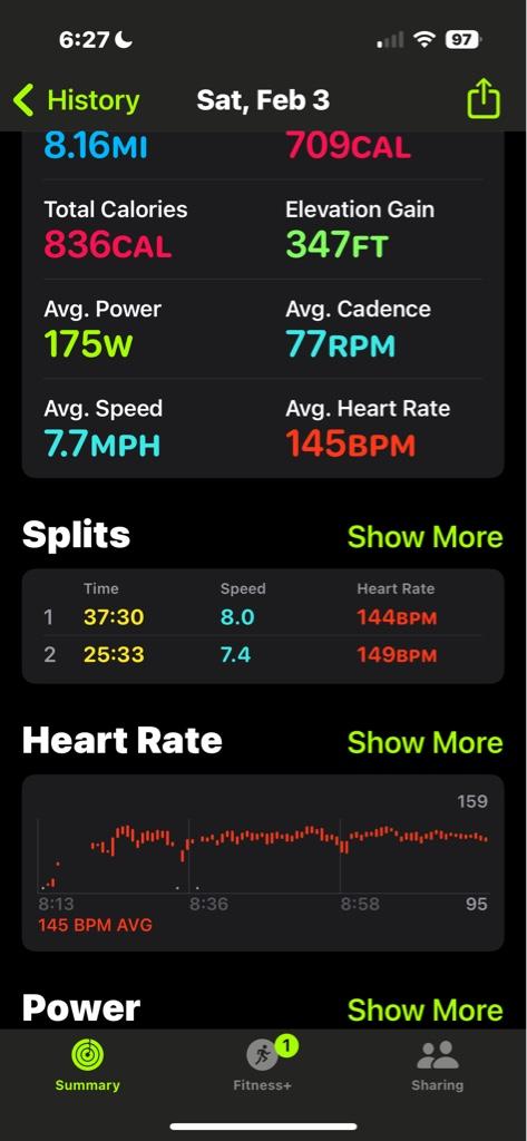

I have an AWU2 & S7, just upgraded the U2 from an U1.
My U1 never (well practically never) lost the HR reading during my daily Fitness+ workouts, though the S7 did occasionally. My U2 loses it about 2-3 times for about 30 seconds every day in a 20 min workout. Tried different straps, tighter on the loops etc, but still loses it. Really weird as my U1 was rock solid.

@BillGates1969 It's very similar to what I encounter.
@Jackbequickly When I start a session, the cardio functions correctly - in any case, the display shows the heart rate and it evolves correctly. It's really during the session that the cardio is lost.
Before, sometimes on the watch, the cardio is grayed out and doesn't change, but other times, most of the time, I frequently look at the watch, nothing abnormal on the display, but on arrival, on the graphs, it's a disaster.
I'm trying to understand why, for some people, everything seems to work almost perfectly and for others it's catastrophic.
Is it a problem of technology that remains bad when used on the wrist, yet some people seem to have no problems or much less than what I describe.
Is it a morphological problem, the sensor doesn't work as well when the wrist is thin, with little fat, which could explain why some people get better readings than others.
Is it that Apple uses different components for the heart rate sensor, as they do for other iPhone components for example, and that some of these models perform less well.
I've opened other posts on different forums and other users are experiencing this problem.
Apple should clarify this and explain why the results are different for different users, the watch is the same price for everyone but the quality is not the same for everyone. This is not normal.

Timely topic, I was going to post same and see you did.

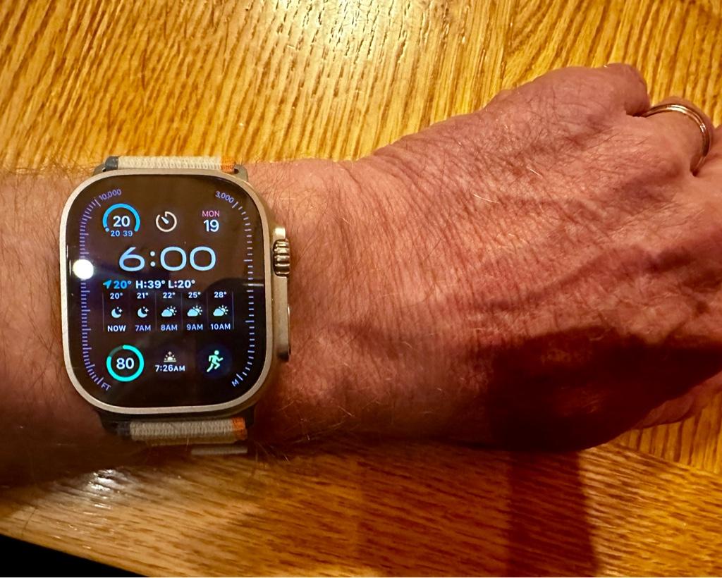

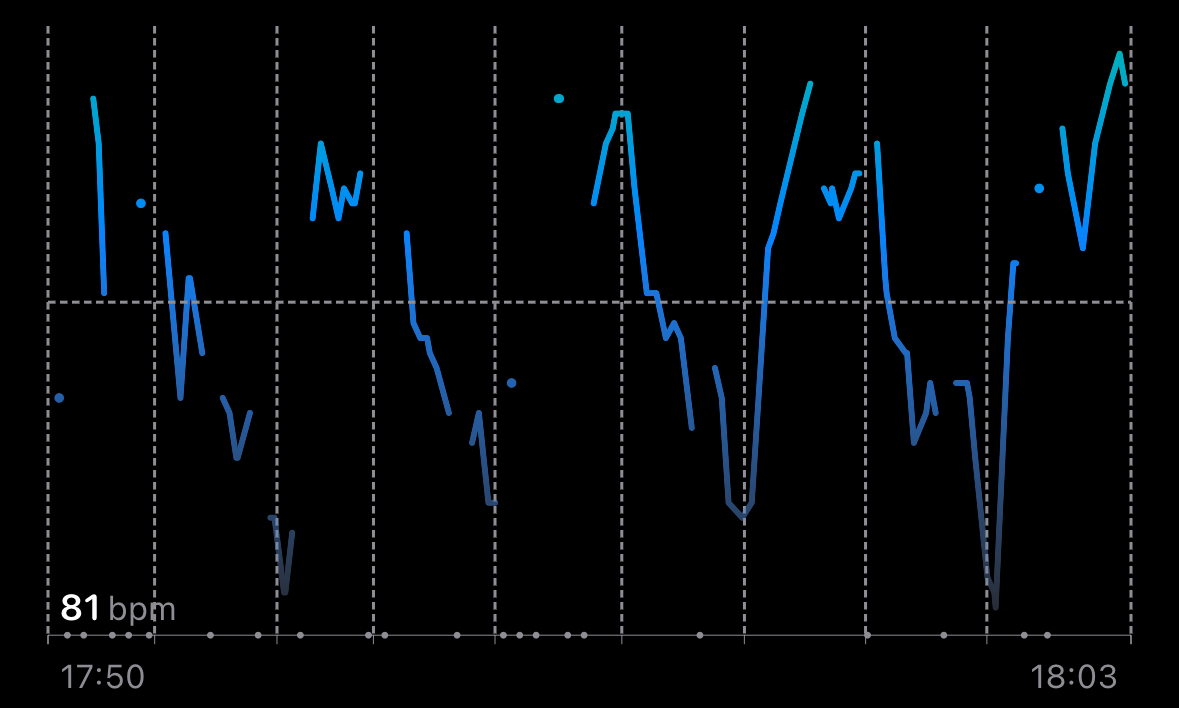

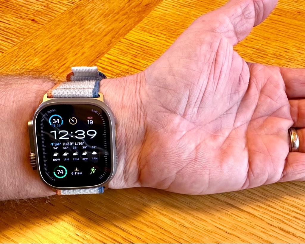

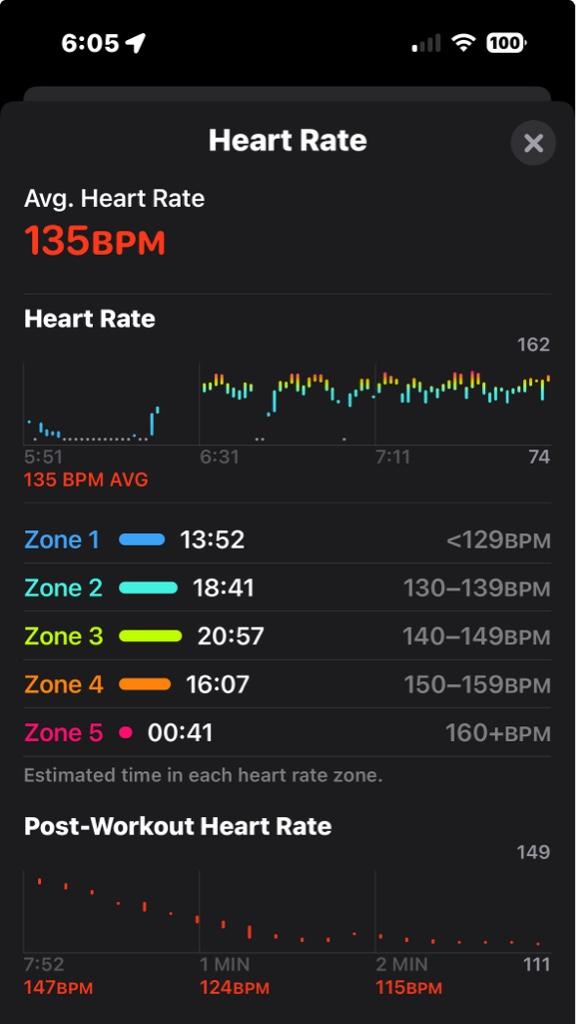

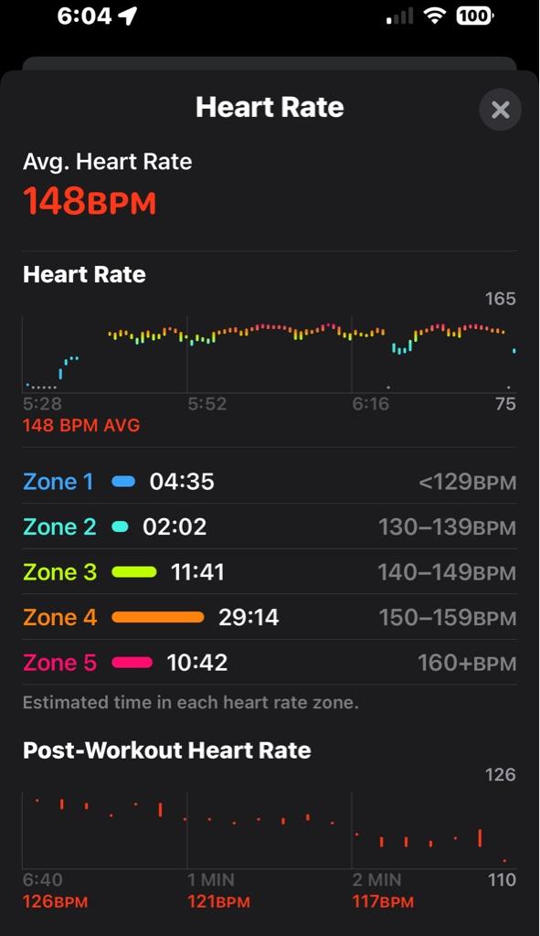

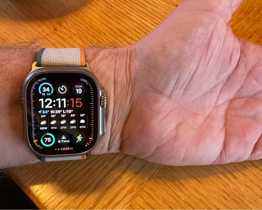

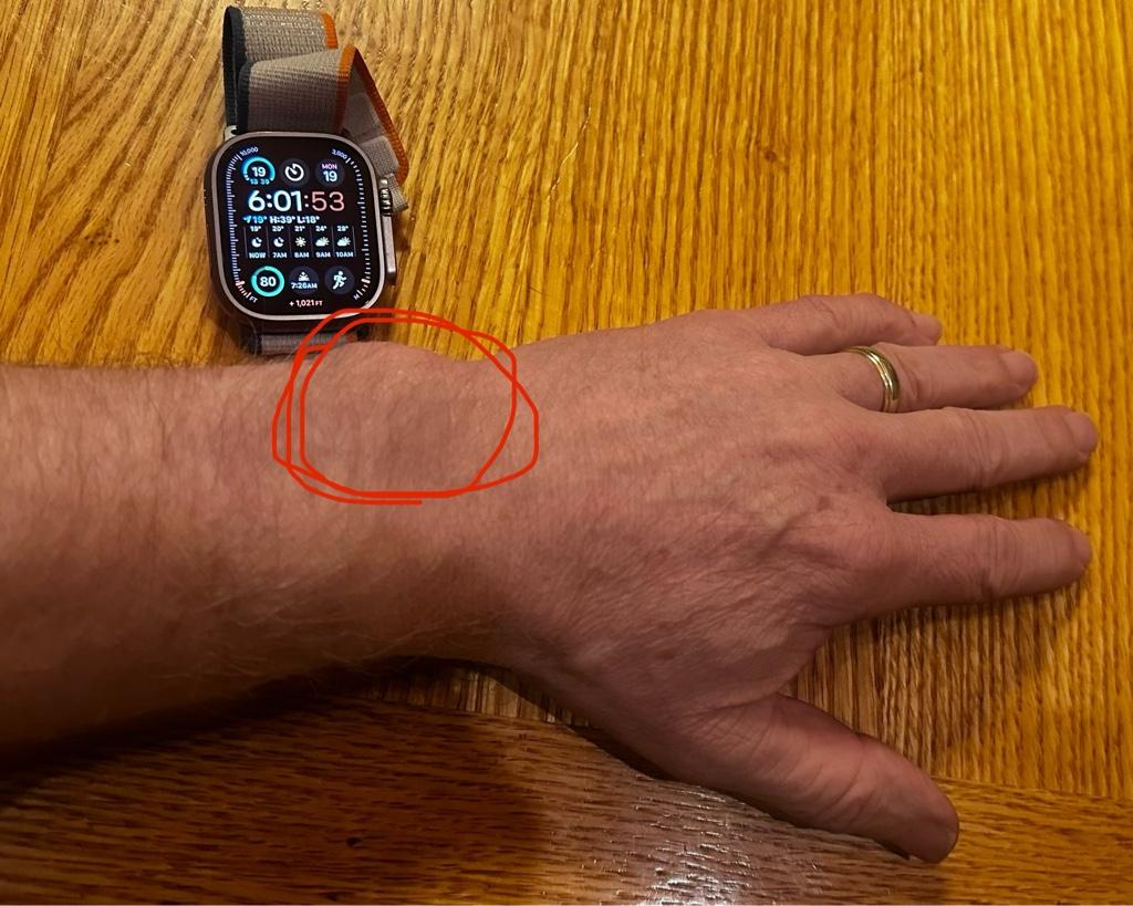

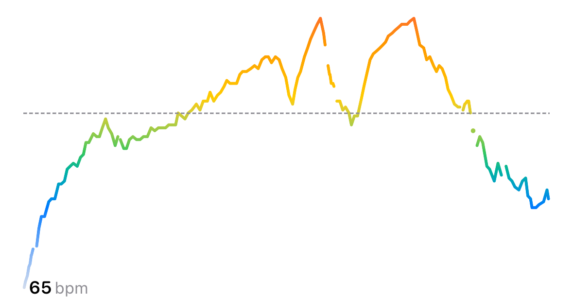

I’ve had my AWU2 since December 2023, and have noticed quirks with it on HR data. Posted a few screen shots below.

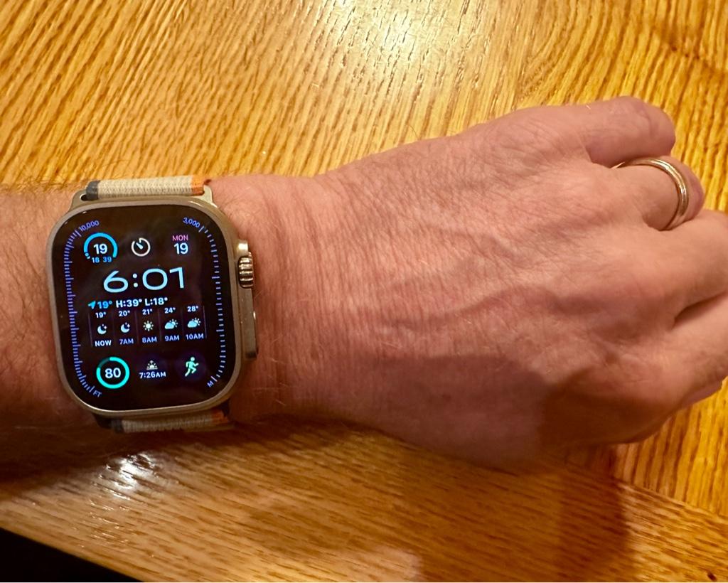

Here’s it on my left wrist, I’m guessing it’s related to the bone and making sure it’s snug just behind it not on it.
Behind
On
Yea, that bone
Before the AWU2 I had an Apple Watch 7 a few years and after 100’s uses near zero HR drops.
Possibly the larger back size of the AWU2 vs std Apple Watch makes some intermittent contact issue more?
I don’t feel it’s cold related, at least for me. It’s worked fine on near zero deg f days as seen here in January. Yes it’s on my wrist, then below 2 layers of merino wool and thin top layer.

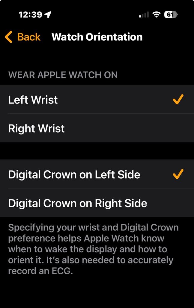

Well I posted this in my local MMBA facebook group. One person suggested to wear the watch inside of wrist to avoid the bone.
Hmm, I like that idea.
I just tried it, but the crown and other button might get pressed on wrist flex now.
So, I turned it so crown is now on other side. Since this is a temporary “MTB ride the watch “ thing I won’t rotate the display in watch settings, as normally it’s on the topside.
Will try it out tomorrow’s ride.
Crossing fingers.
Edit - 10 seconds to do this .. ha
My concern is scratching the watch face if worn 24/7 on inside.

For me, I found having the strap really good and snug has eliminated any HR gaps past 4 MTB rides.
