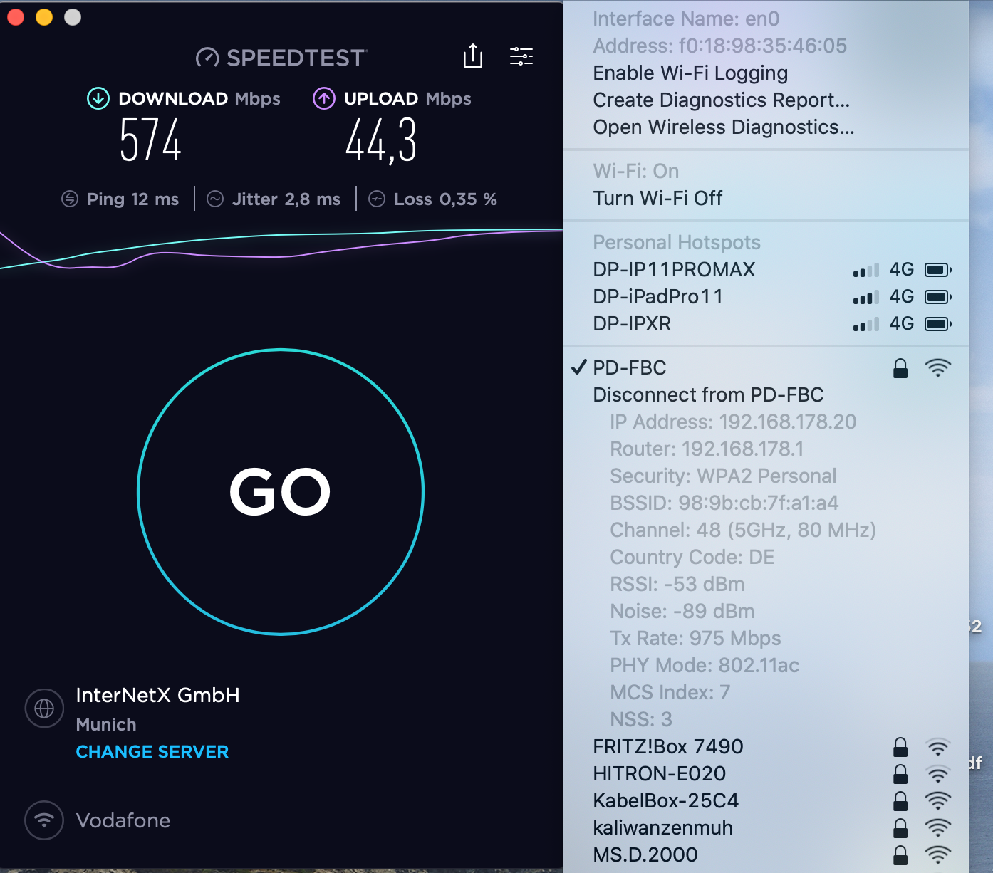

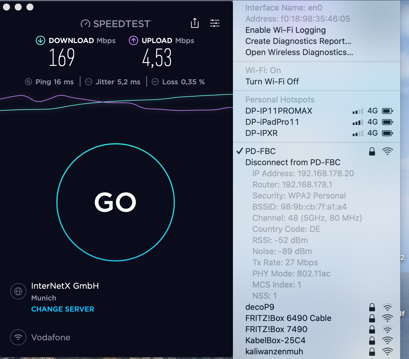

Here just an example if the tx rate lock occurs:
after cycle wifi (turn off/on)
Reactions: Frosties
