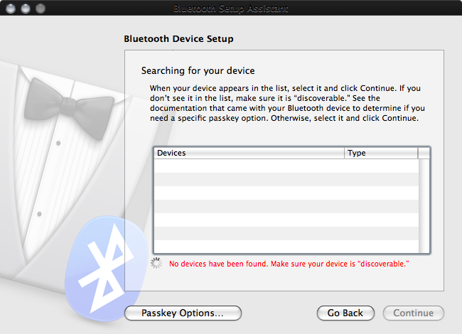

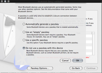

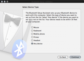

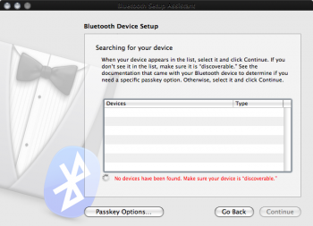

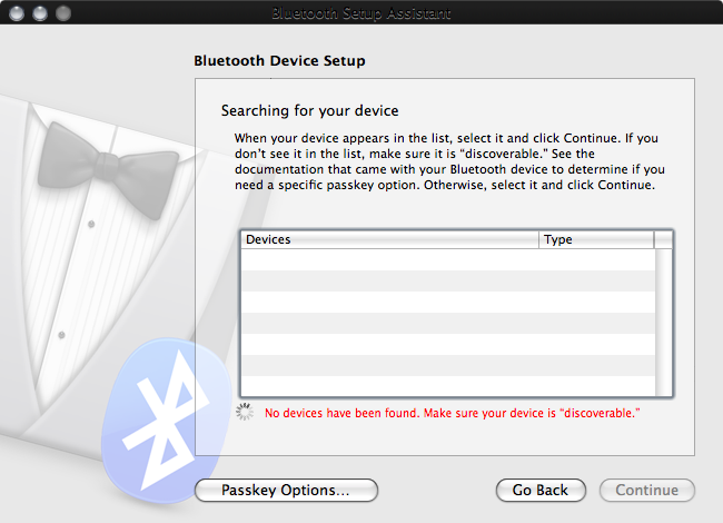

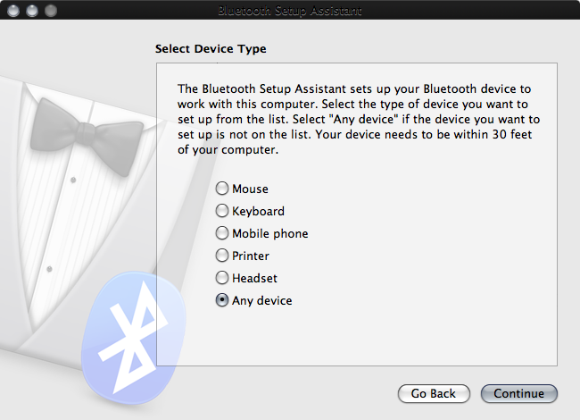

OK. I was wrong. It is in the Bluetooth Setup Assistant. Sorry about that.
Setup as Any Device and the option will appear.
Bluetooth Setup Assistant 3.png Bluetooth Setup Assistant 2.png Bluetooth Setup Assistant.png
