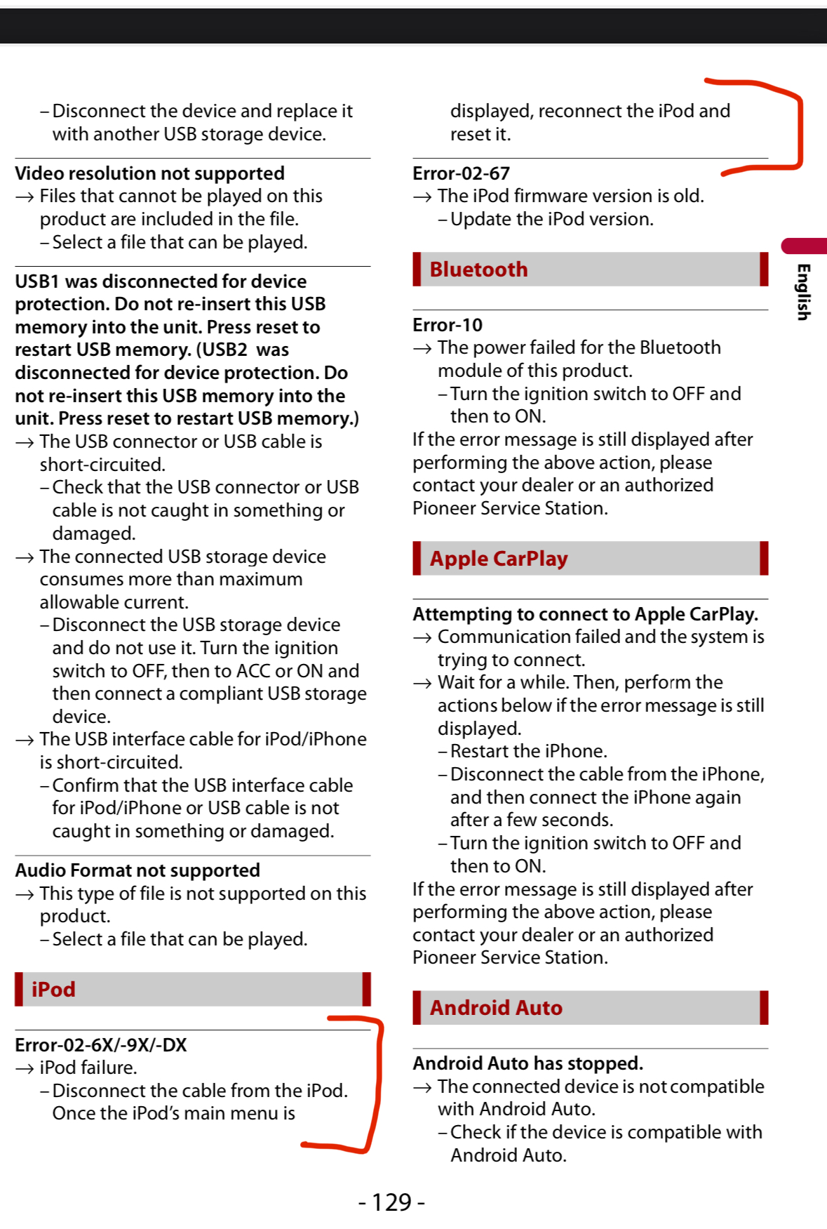

I have had a Pioneer 4400nex installed for about 7 years and it’s been mostly great. I connect to it wirelessly. Recently an issue began happening where nearly every time it will connect but the radio will display a message “Error-02-60” and it won’t be possible to adjust the volume. If I turn CarPlay off and back on it will usually fix it. There are people on the CarPlay Reddit that are getting the same error with different models of Pioneer. I contacted Apple and they say they only provide support on factory installed CarPlay. Is that an official Apple policy stated anywhere? My radio has the most recent firmware released by Pioneer.

So, on that reddit thread someone posted they had good luck with the newest beta (17.5 b2), so I just installed it and twice in a row my phone connected without any volume control issues. Maybe this will be the fix.

Yeah, Pioneer is awful as far as firmware updates. There hasn't been a firmware update in many years. I've checked many times. I believe they only released 2 updates for mine. I even looked for a home brew firmware and no luck. There was a bug with the pioneer not accepting a new iPhone and pioneer just said I need to ship my radio in, and at first I actually spoke to Pioneer support and they kept telling me it was Apple that needed to release a fix, but eventually their story changed and they said I needed to send my radio in for a fix. I found a forum thread that was for another issue where the firmware would corrupt, the fix involved removing the internal SD card and install a fresh factory operating system, and that fixed it.
I feel like Pioneer could have released a firmware update to have resolved that issue. I just feel like they abandon support really fast. Last update was in 2019. Not sure if other manufacturers have better support. I was considering buying a new Alpine but I don't want to just toss a thousand bucks out the window, not to mention the time it will take to install a new radio. I'll live with a minor volume issues. But hoping a new iOS update might fix it.
I just came to post the same thing. I did the update a couple of days ago, and have had no issues since.

I connected about 10 times in a row and no error/volume works. Hopefully 17.5 is the answer.

Beta 3 has been flawless. I’ve yet to install 4 but I don’t expect there to be issues.
