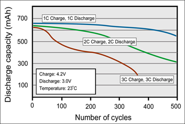

As you can see, for the 1-2C discharges, the capacity stays about the same. http://batteryuniversity.com/learn/article/bu_808b_what_causes_li_ion_to_die
So has a battery after 200 cycles aged? Yes. Has it lost capacity? For some, maybe not a lot depending on how it was abused/used.
But you guys both have good advice for battery longevity: Charge slow, don't run down past 40% if you can help it, and avoid heat.
