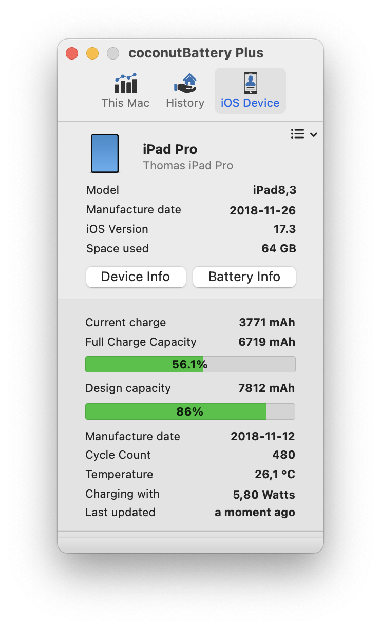

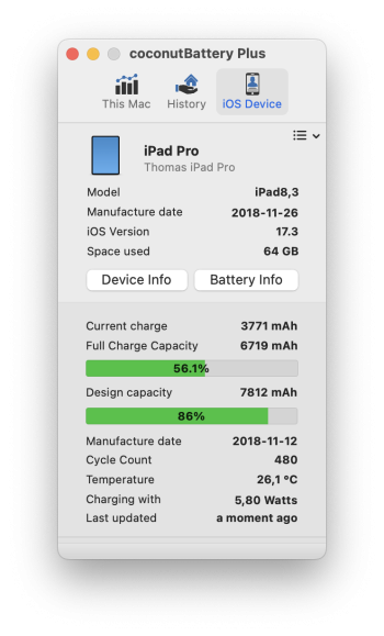

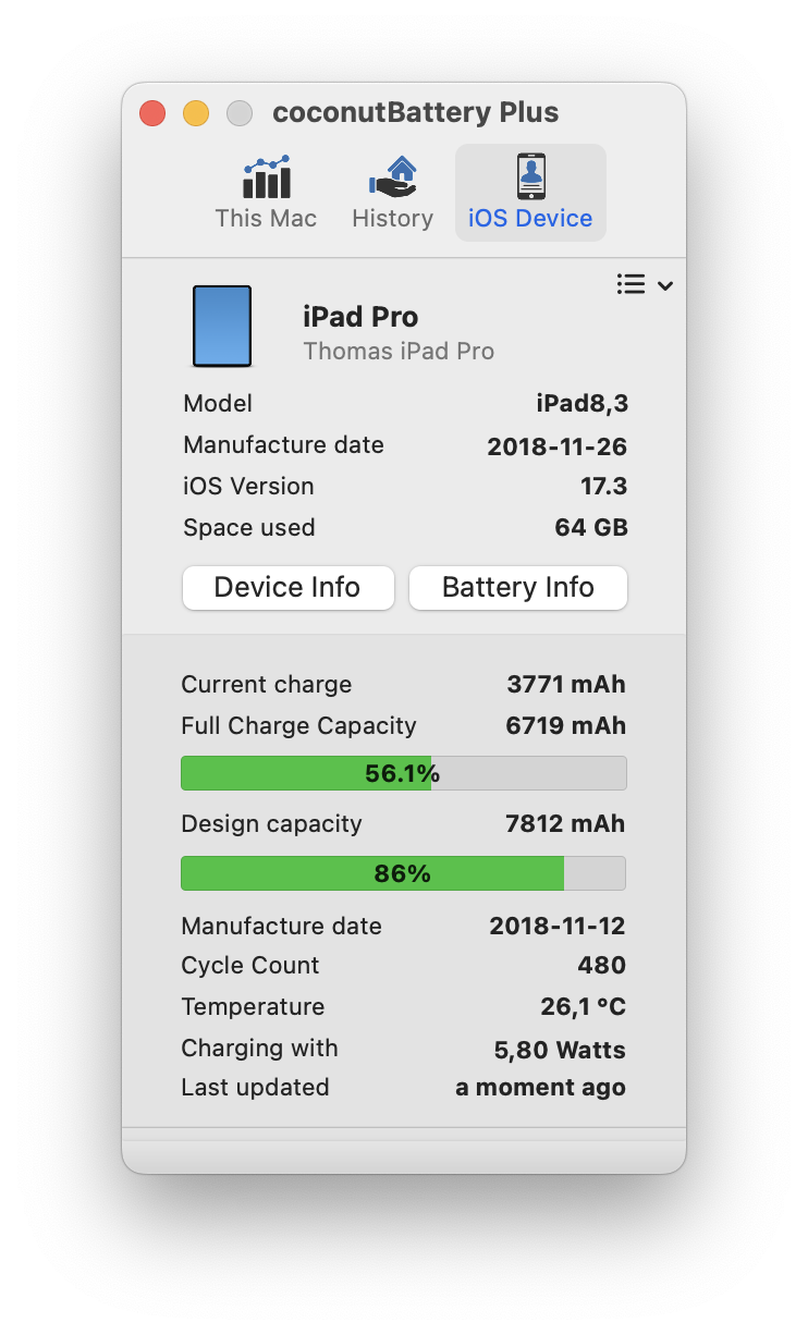

I too have the 2018 11" iPP, and it's at 86% according to Coconut with 480 cycles. While the battery is worse, it's not that bad, I get around 6-8 hours of use, my use case being Youtube, streaming services and web browsing for the majority of the time.
Its still a powerful device and can manage most things thrown at it today. Same with the earlier gen, 10.5 pro, still manages most things thrown at it with the latest iPadOS.
Its sad that Apple don't offer a change of battery like on their iPhones when it does wear out, its a shame that a faulty or worn out battery should put an end to a device.
Still have to say, Apple does seem to ship their products with quality batteries, none of my laptops or any of the Android tablets i've dealt with in the past seem to come even close. MS Surface pro 4 is prod the only device that I have had that has had a battery that didn't degrade as fast as the others.
